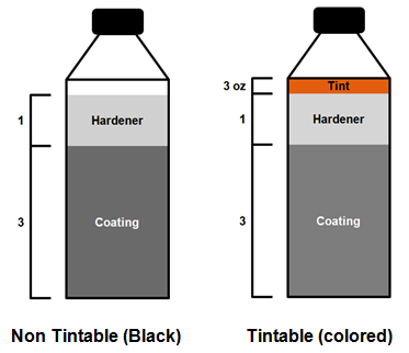

You're not going to shoot Raptor, even with a thinner in it with a Harbor Freight HLVP gun. I use one of the HF "purple" HVLP guns for primer and I have the tip hogged out to 2mm - it's still not enough for some of the thick high build primers. Raptor is much thicker than that. I would look for a gun with a tip much larger than 2mm - 2.5 or 3mm might work - or you could try thinning the product and shooting it with the Raptor gun and play with your air pressure to get the finish you want. I bet you can dial it in and make that gun work.
Trick is going to be getting your mix ratio right. I found that it was not easy to add hardener and have any time at all to work with it... you would need to dump your Raptor, hardener and a thinner into a mixing container, mix it up, then dump it back into an empty Raptor jug and plan on wasting some or stopping halfway through to refill. The Raptor system works pretty good but it's only designed to have two parts in one jug, not enough room for thinner.
