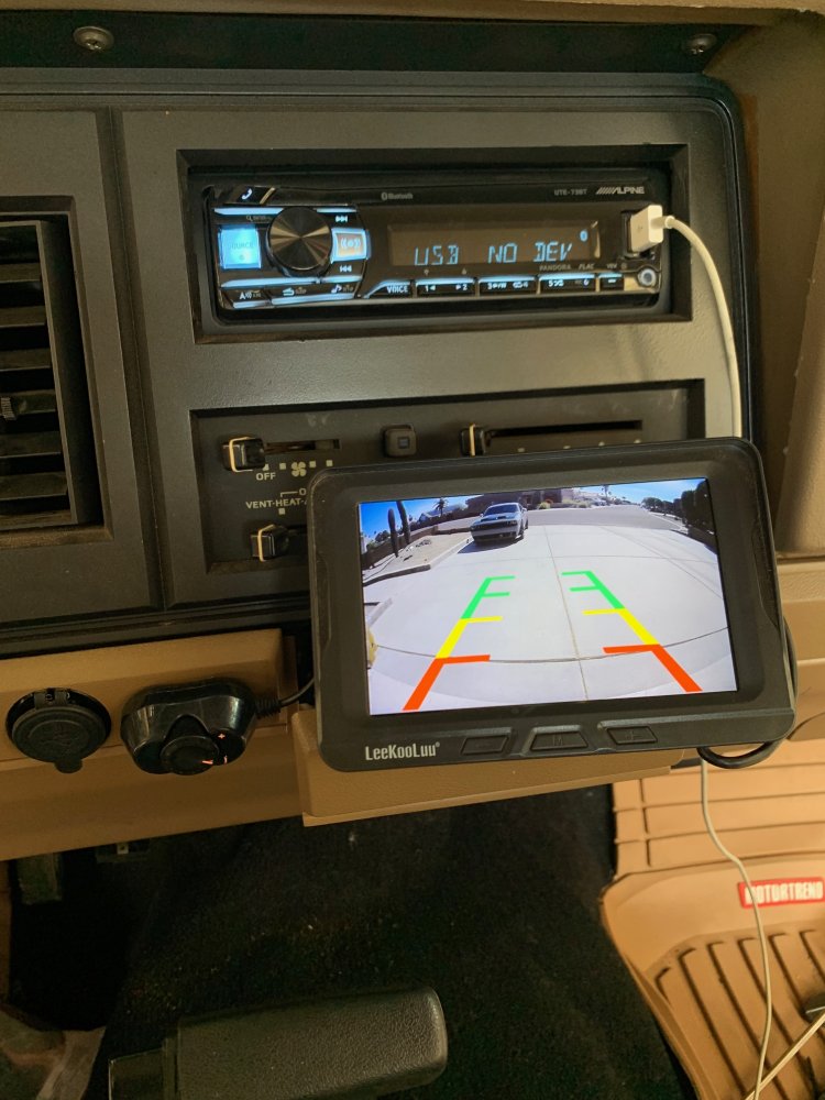

Although not a big deal, it's been driving me nuts as I'm an attention to detail guy, and having the subwoofer remote volume knob and rear-view camera not mounted/fixed anywhere was unacceptable. Mounting the rear view camera to the windshield is a non-starter as summer temps can peak over 115 and windshield shades aren't optional. The position actually works well; I check the mirrors before shifting into reverse and the screen shows WAY more than I'm seeing with my 3 mirrors...
Having the separate subwoofer volume knob in a handy location makes it easy to go from window rattling on the highway to considerate neighbor quickly! :ROFLMAO:

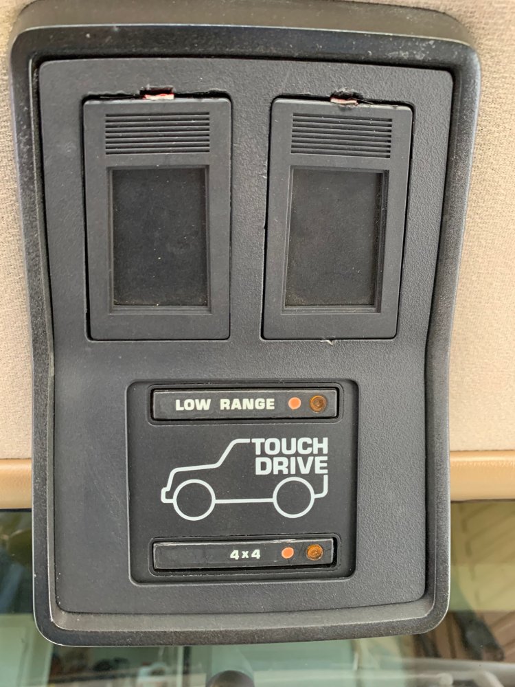

Pretty sure I mentioned I had problems with the overhead 4WD console. After getting it apart it's amazing how incredibly fragile the mechanism is, using what looks like a clipped-off leg from a paper clip to provide spring tension. The switches require a delicate touch, which is counterintuitive to the off-road environment, and I had the 4WD button mash in and get stuck behind the faceplate, which prompted me to repair/rebuild it. Because one of the switches' pivot pin broke (which I found AFTER I glued/repaired and put everything back together of course!) it's stronger/more stable to push the button biased towards the right side of the switch, near the LED indicator, so to remind myself of that I just took an orange paint pen and put a dot next to LED, telling me, push here! :p
