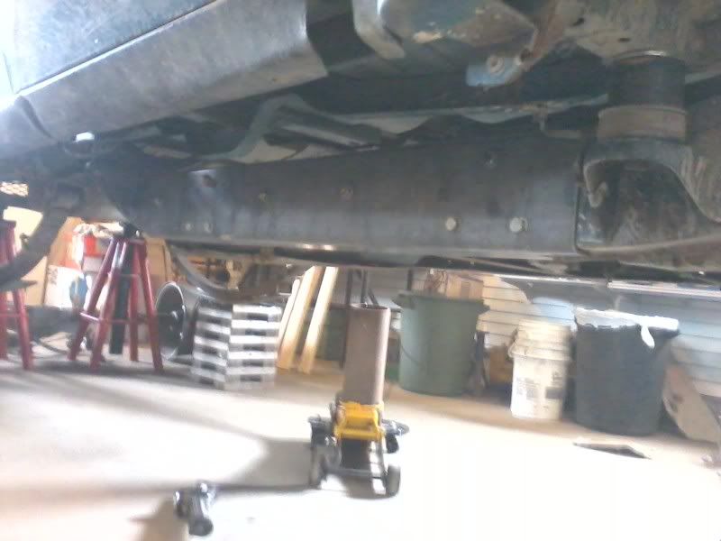

Started to weld the lower link mounts on and realized I forgot to open them up to 5/8" holes for the EVO joints.... I'll have to get a ream from work tomorrow as it killed my 5/8" drillbit. Ranger frames aren't straight either... had to notch/bend/weld to follow the frame.
lower link tabs on, and driverside notched for driveshaft!
