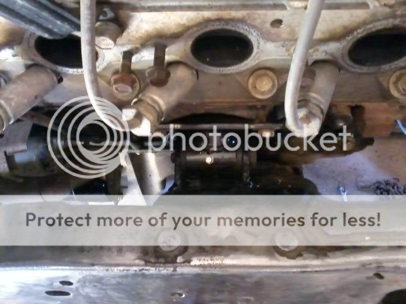

You know me, begging for pictures of everything. (preferrably some pics that show a little more detail than the cell phone cameras)
Engine mounts.... One day I'll get a better camera...

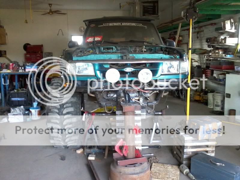

ugh.... Haven't touched the truck in 3 weeks, life/work keeps getting in the way!
Borrowed a tire from my old mans rig to roll under it though! I'll post better pictures tonight.

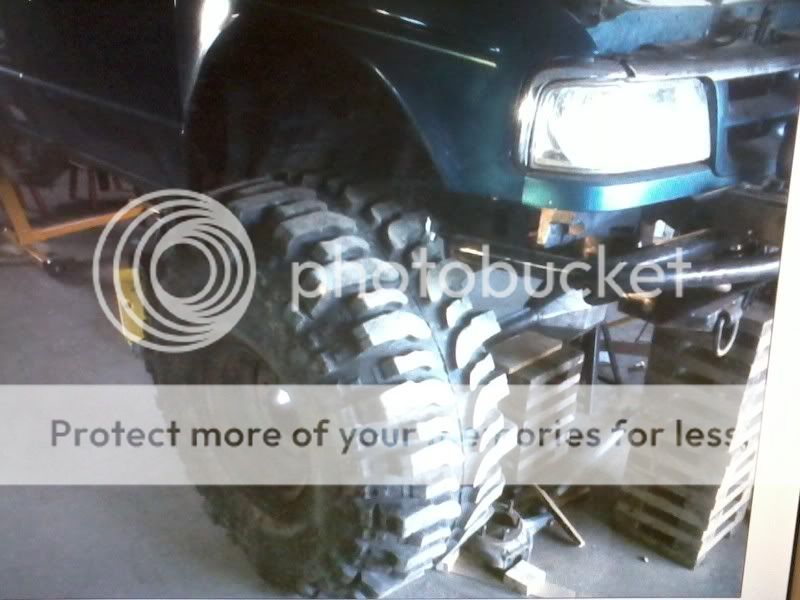

Here's a better pic...can't wait til I can work on this thing some more!
is the truck roughly where its gonna be hight wise? cause with that tire there it seems the axle is going to have to come up a bit to be centered
