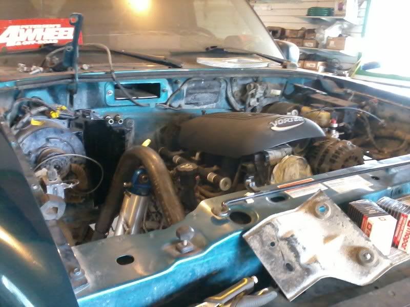

Shock hoop mockup, would have had them all bent up and tacked in tonight but I found a shitty repair weld on the 2" bender die and it let loose on me.... Yay for flying parts!

Here's the permanent version.... Might even be able to keep my stock washer-fluid and coolant resevoir! The tube on the front of the frame that the hoop ties into goes all the way through both frame rails, for a swaybar once the rest is done.

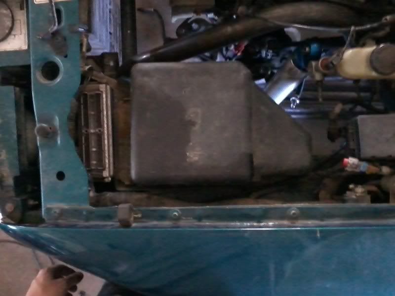

Got the GM fuse box and ECM mocked in, gonna wire the rangers underhood fuse box into the GM one. The ECM fit's nicely in front of the battery tray in the gap to the header panel.

is that going to be a water proof enough area? i remember in the videos you had this thing in some fairly deep mud id hate to see you fry the computer
According to my GM guy the ECM is waterproof and has weatherpack connections....It's also gonna get a thorough coating of dialectric grease to keep as much water out as I can.
That being said, I'm making damn sure my wheel wells are sealed up much better then before! I'm thinking full aluminum inner fenderwells with rubber to seal around the shocks.
