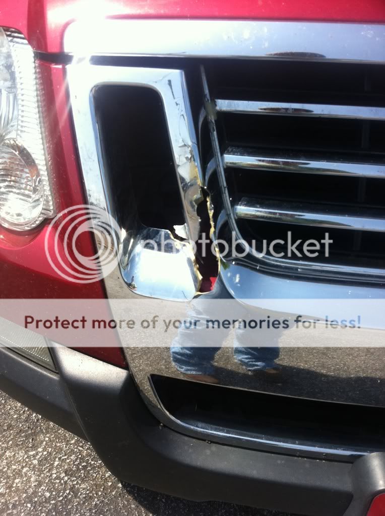

here's a couple pics
My Bronco 2
My Bronco 2
My Bronco 2
My Bronco 2
needs a grill....
