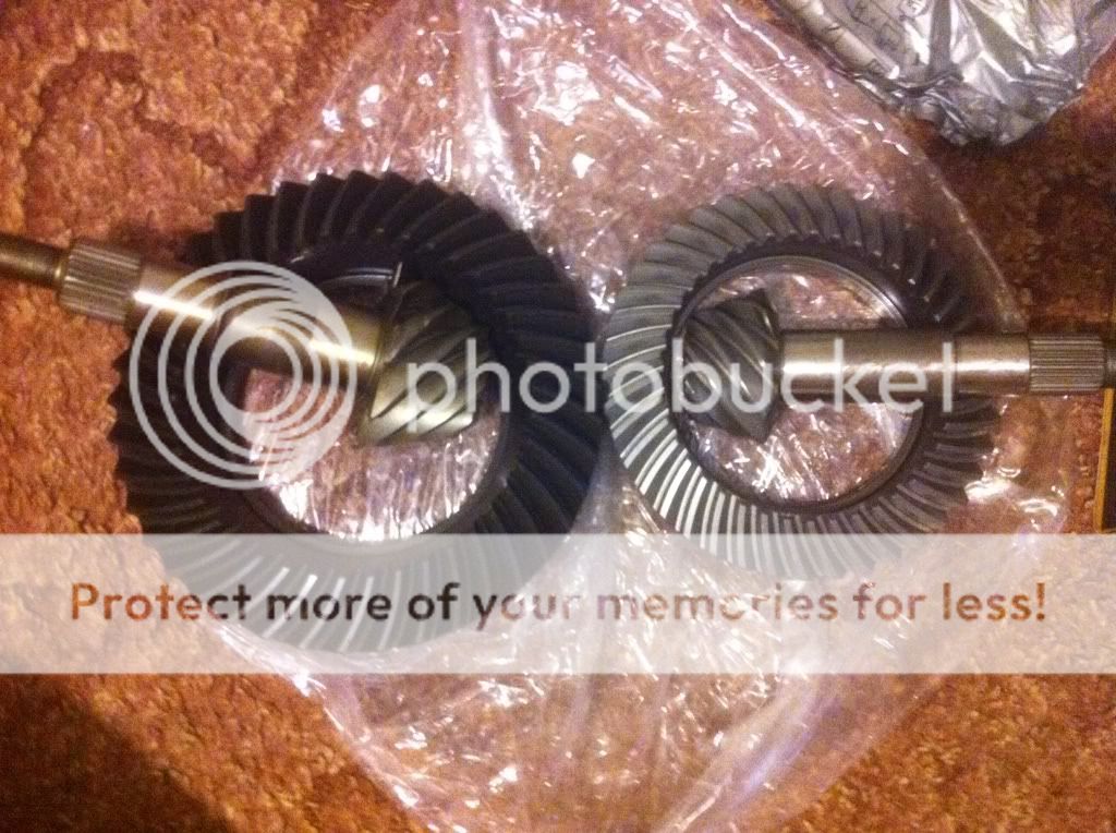

its never really disappointed me offroad as is, but i didn't expect much for the stock axles and 30's. my expectations will be higher soon w/ 33's and 4.56's and ex axles built up pretty nicely.
4.10s shipped out. rockauto order on its way in.

8.8 r&p compared to d35 ttb r&p

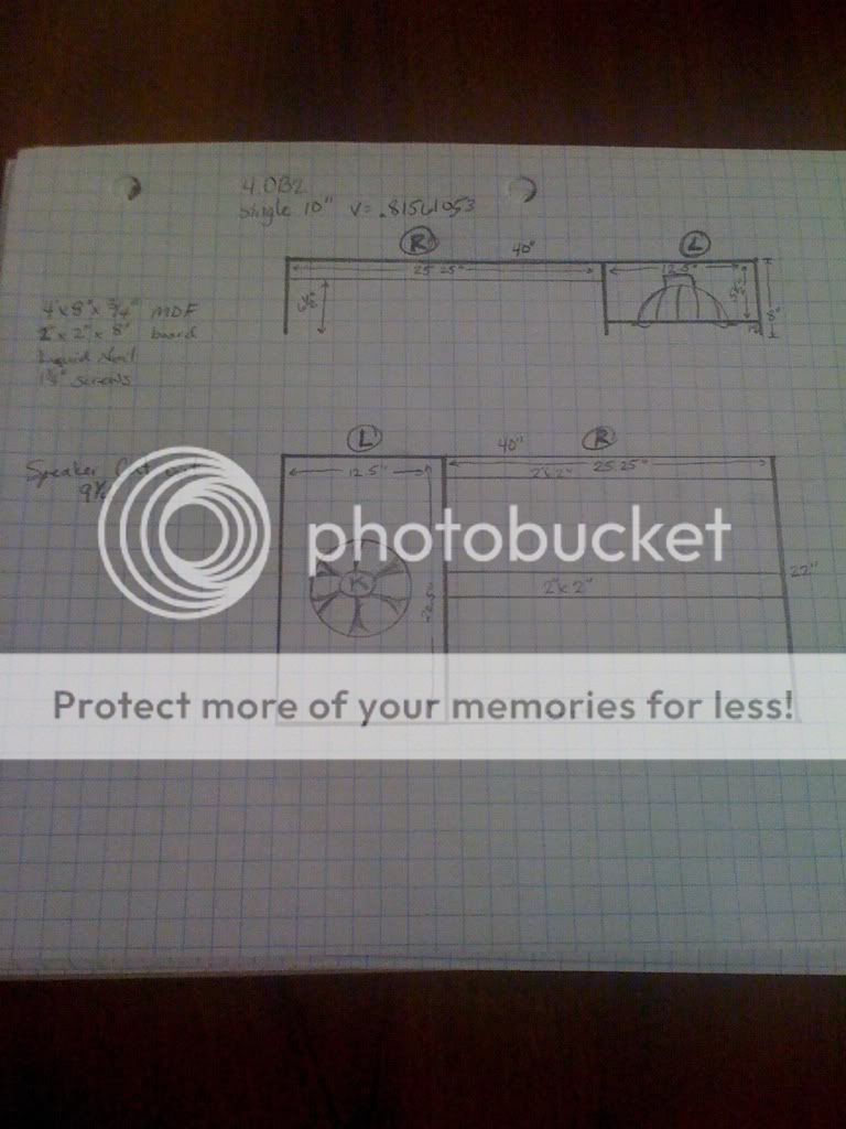

sub box being built this weekend. come to find out i have a friend that makes sub boxes for the rear seats of jeeps, so i gave him my project...
here's his drawing of it
My Bronco 2

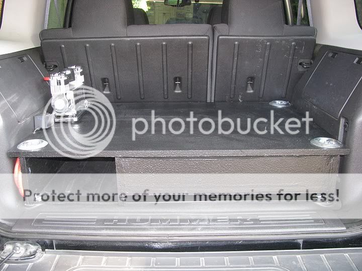

gonna be something like
My Bronco 2
but only the airspace for one 10" sub. that way it'll free up the back of my truck and have amps mounted where everything will be protected.
probably gonna bedline the box!

the way this box is made, i'll have cargo space which is gonna be great... all my tools in the cargo area, and then my chairs (i keep camping chairs in my truck)... my backseat can be empty. not that anyone ever sits back there... lol
