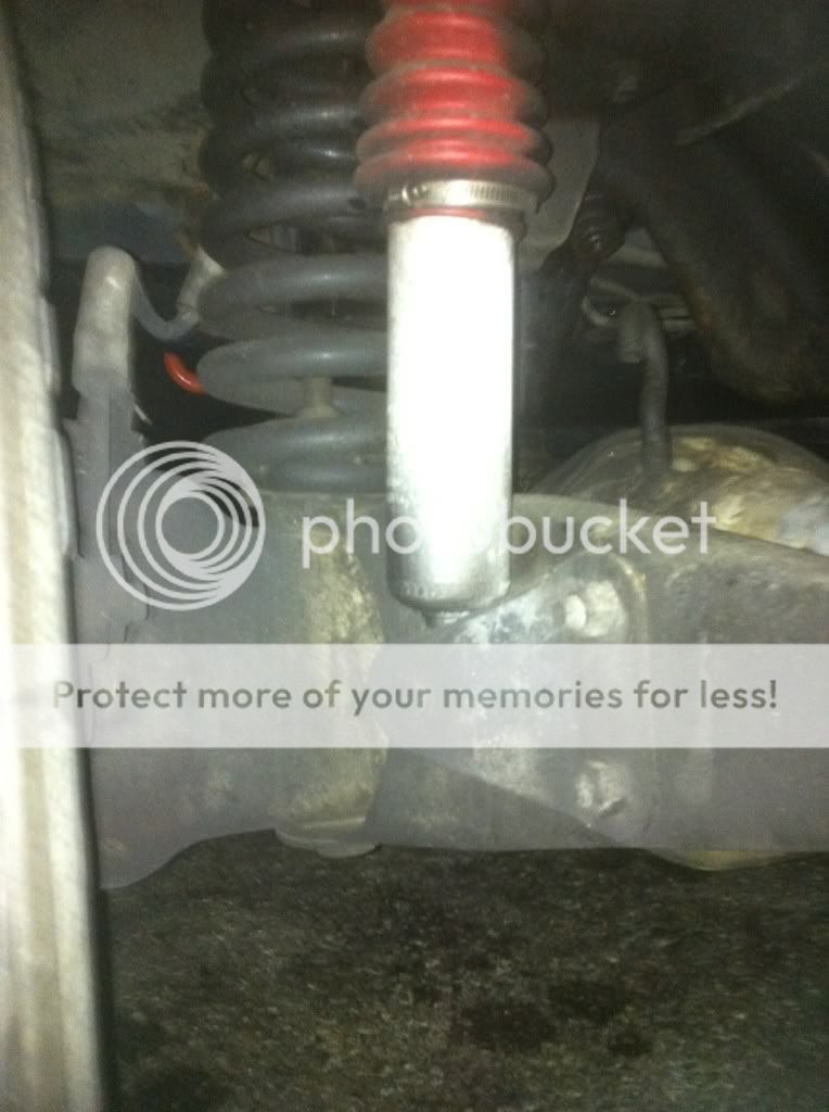

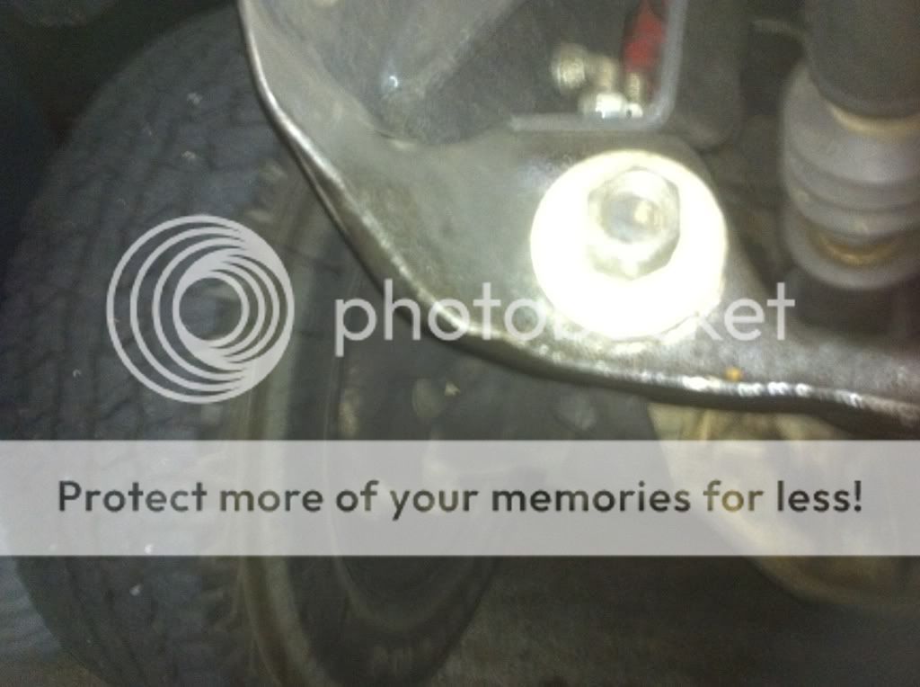

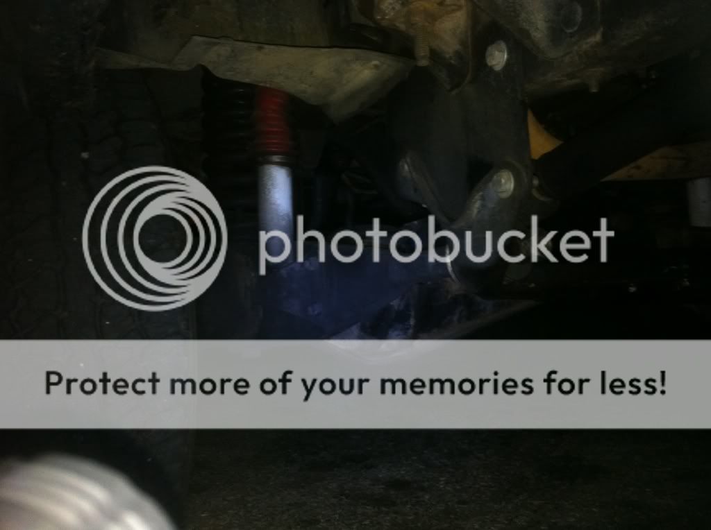

talking to the guy that built my bumper, about the ext radius arms.. took some pics for him, to see what any advice he will give me... so might as well load them up here, i'll be using the d28 ra's (i think they will work right? lol) b/c of the shock retainer is more than just a stud. if not, i'll just use this shock retainer on the d35 arms. idk.
