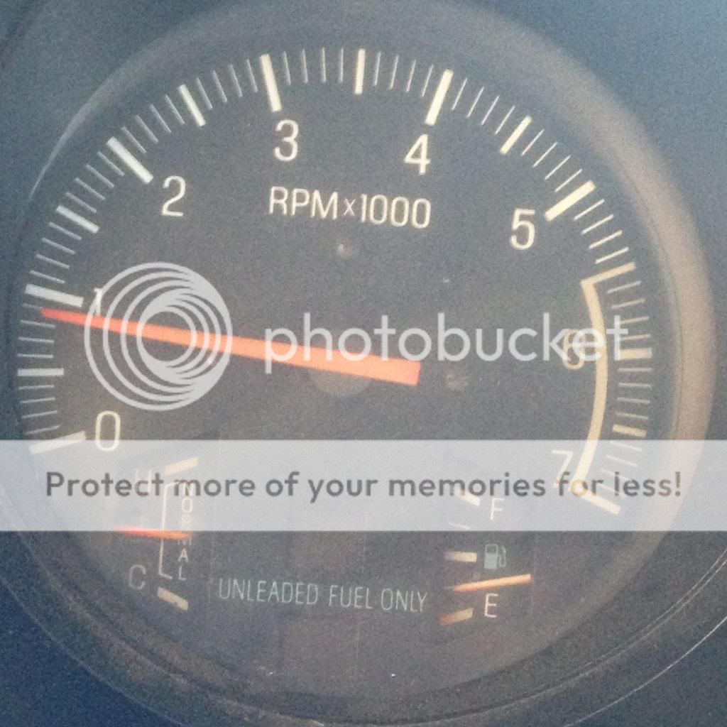

anyway.. recently the temp has been higher than I want it for daily driving. Got a pressure tester and put on it.. shows no leaks.. then tested the cap, yep... the cap was bad.
replaced the cap and now it runs here instead of between the O and R.

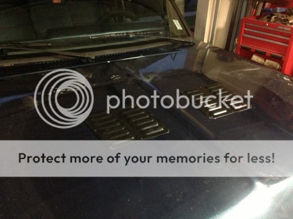

hood vents installed.
put them where the braces would let me/ where the hottest part of the hood was after running and idling.

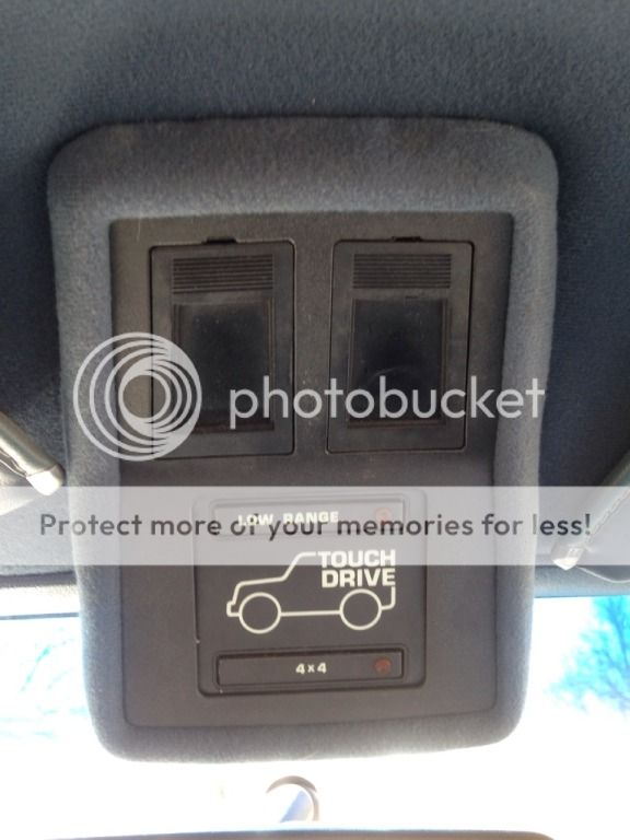

do you have any pic of this open?? I can not open it =(
Swapped OHC's.. Well I used my internals bc I knew they worked I just needed to face of it since mine was broken and wouldn't hold a lens in the right side. I bought this thing a year or so ago from someone on here and never put it on and just found it Saturday so.... Now it's on!
My Bronco 2
I have an extra somewhere apart.
You have to slide something skinny in the lights and unclip the light lenses CAREFULLY. Then unscrew if from the roof
thank you very much, had tried to remove it before I could not!! :dunno:
it's not hard.. just take something skinny and flat, like a small screwdriver, push up in that little "opening" on the map light lens, get it unclipped... once those are out you can pop the cover off and see all the screws and wiring.
JUST BE CAREFUL.. You will probably break the clips for the map lights. Trust me, that's why I have an old one at home.

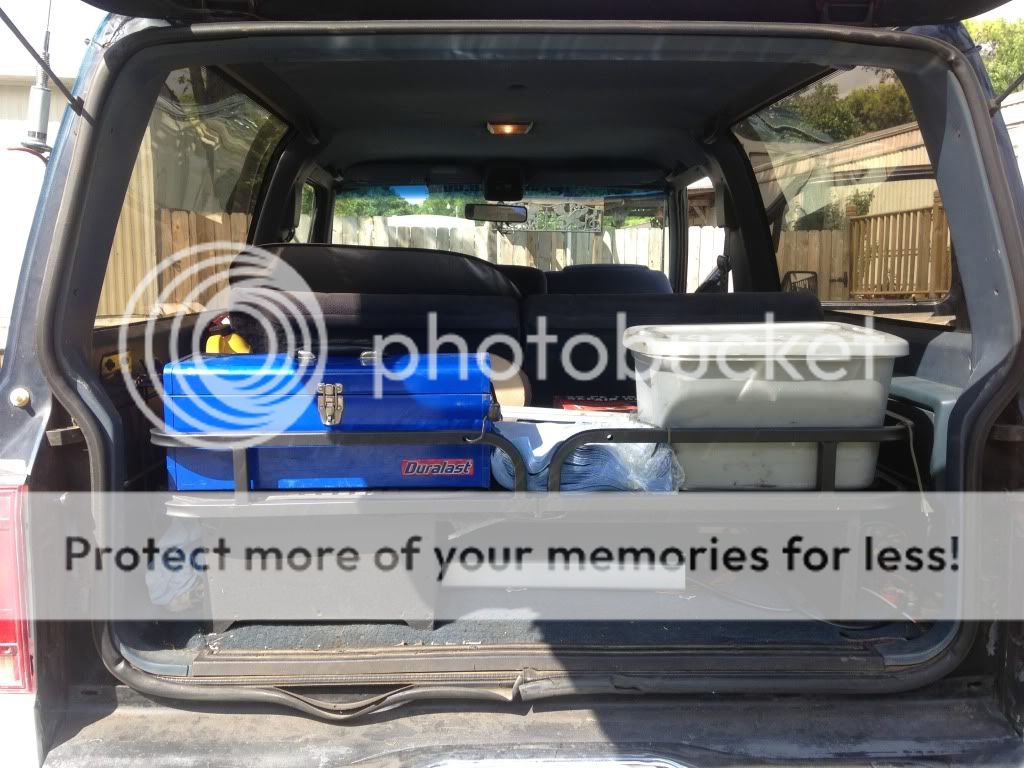

Did a Harbor Freight ATV cargo basket in the rear for a tie down

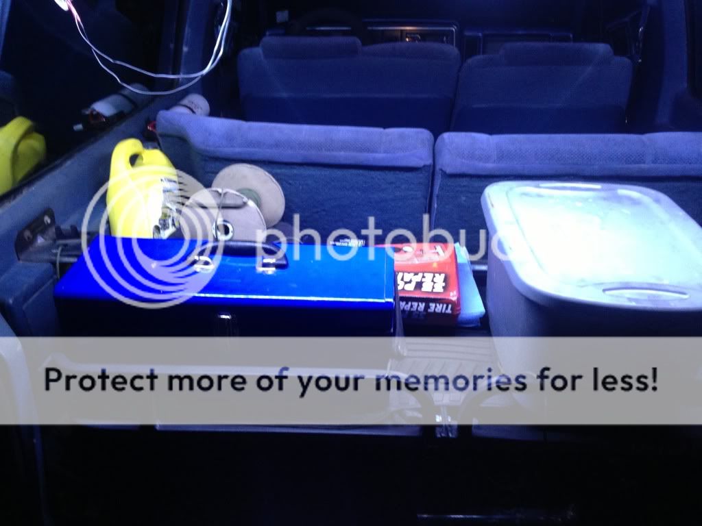

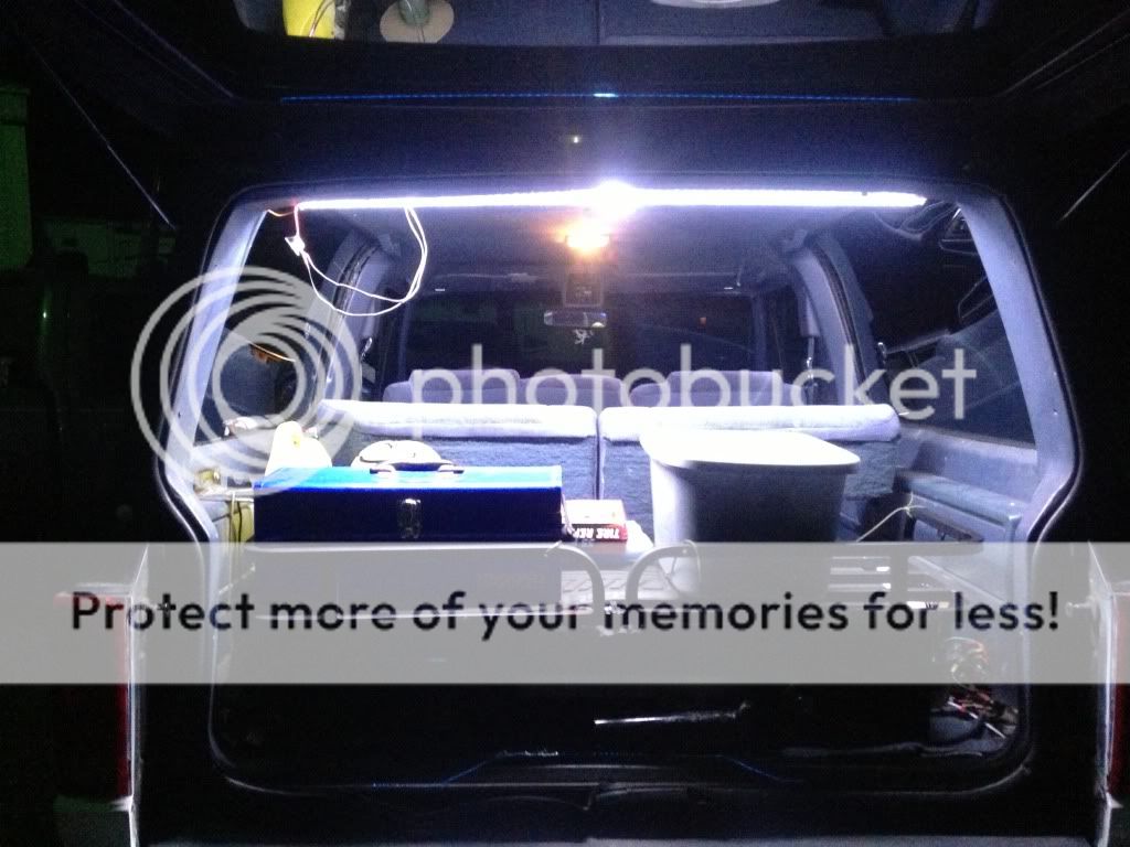

Ever need more light in the cargo area of your rig?
Well, I got tired of not seeing my tool box and crap so...
here's what I'm doing..
see these lights?
www.ebay.com/itm/251279303943?ssPageName=STRK:MEWNX:IT&_trksid=p3984.m1497.l2649
yeah, it's as wide as my cargo area roof. LED's.. 12volt, BRIGHT.. I got it wired up and will be mounting it to the roof later. I got lucky and the B2 has a cargo light that is wired to the door switch AND has a switch on it. So I tapped into those wires and can use it with the lightgate open or closed (Idk why I'd need it with the gate closed lol). The stock light is a little 168 bulb so VERY little light.
These lights are awesome. I recommend them for anyone who needs more light and has an area that wide to mount something.
I even recommend them for under cabinet lighting in the garage/shop.. you can get a 12 volt wall adapter.. I think it'd be sweet.

This light is freakin' BRIGHT

that's only the LED strip..
