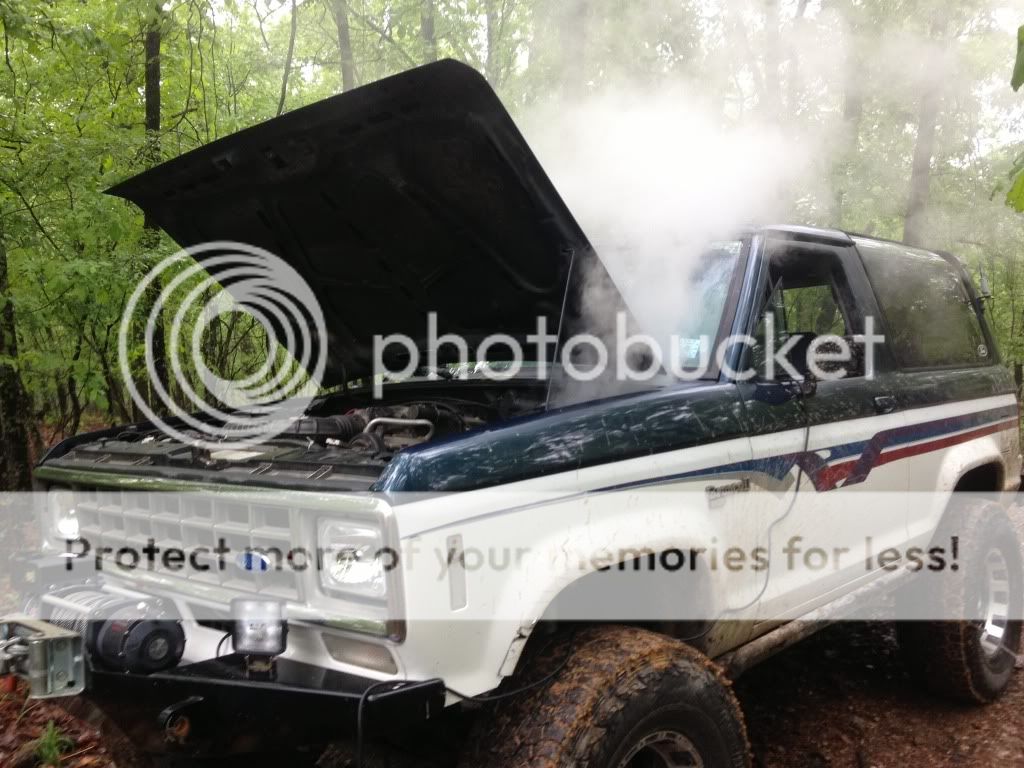

I'm at Superlift Offroad Park this weekend, the B2 has done really well. I'm impressed by some of the stuff we've done.
Only problem... Long hill climbs in 4 lo and it overheats pouring its fluid out the overflow. We ended up just waiting and letting it cool and pouring some water in it and driving it out. Idk. Need to check my cooking system and maybe do an electric fan upgrade.

I call this one, Smoke Break
It shouldn't be over heating like that unless you are running the snot out of her.
I say do an electric fan mod. If that and a 4.0 rad can keep a 5.0 cool then it should be able to keep your 4.0 cool.

it's smoking where my overflow tank is... b/c of my dual battery setup (my second battery is where the overflow was) my overflow tank happens to be back by the firewall.
and yeah, it shouldn't be overheating... that's why I never did any mods on the cooling system, didn't figure I'd need it. But now I know otherwise lol. All is good tho. I'm happy with how it preformed over the weekend.

If everything is working right it shouldn't be overheating?
Everything can be working right but only be able to handle so much. Can't remember but does the transmission use the radiator to cool it? If so, a hot engine, hot transmission due to running 4lo, elevated rpms for awhile and 35inch tires combined with not really good air flow through the rad for awhile, I can see why it happened.
Heres a solution I would do. Add a push or pull fan if there is space and have it switch activated so that it only needs to be ran on the trails, having two deep cycle batteries well keep that fan spinning. Also a good manual temp gauge too help you with when to turn it on.
Keep your current fan on your engine since it's fine with everything else you do.
