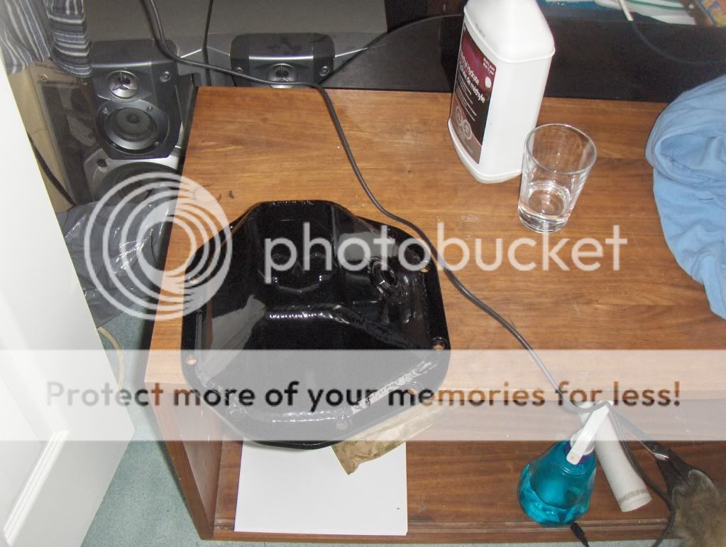

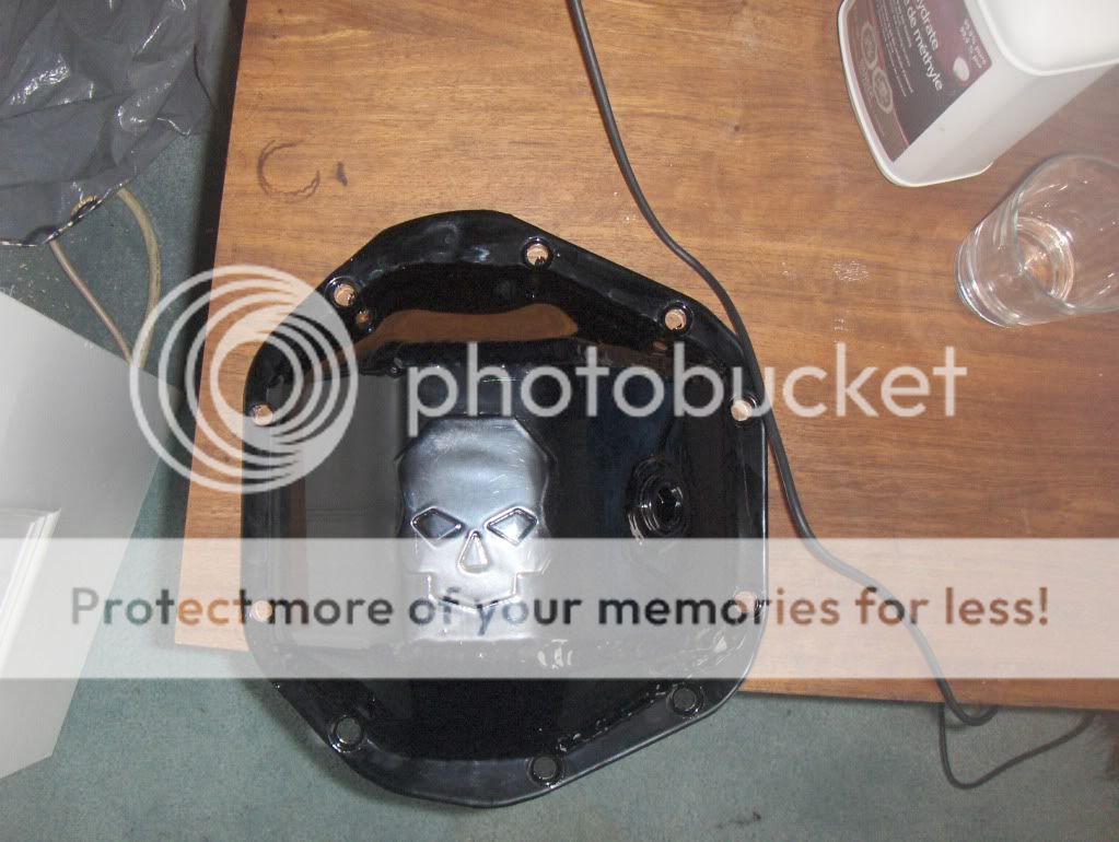

Got my diff cover from ballistic finally. A little complication with shipping and took alot longer than i would have liked. But I got it. As soon as i got it in the mail, I took it to Metal Works in Caledonia and had them powdercoat it for it. cost $25 to get that done. Seemed good enough to me. They put the coat on THICK! they almost made the weld ribs disappear.

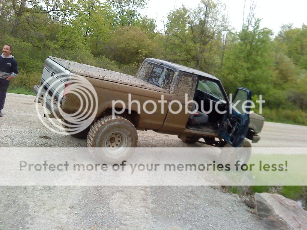

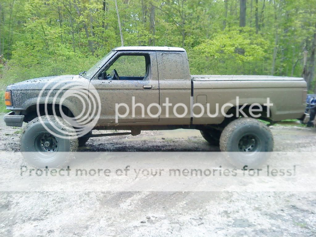

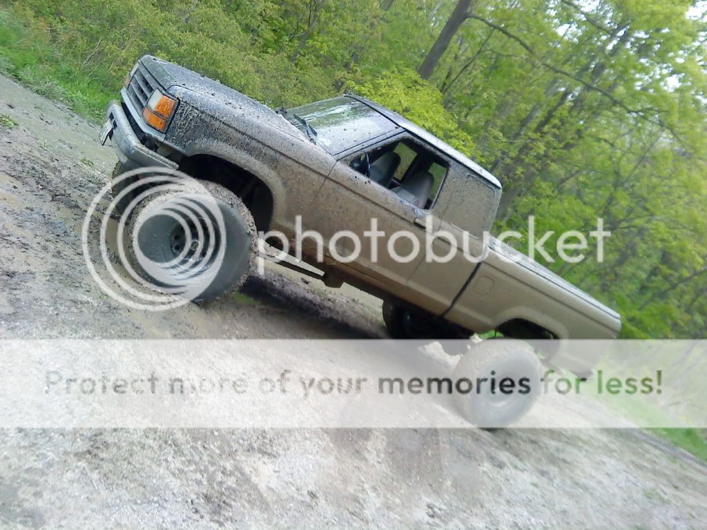

got out today with it! broke the clamps for the front driveshaft u-joint. And a $100 000 f250 got stuck tryig to unstick me. :D
Finally got to take it out and put it to the test! After this run, going to try and find a cheap way to get a torsen locker for the rear, something for the front, change the gears to low to mid 4s (somewhere around a 4.27). And keep pushing my dads friend to sell me his winch. Great time had by all!
