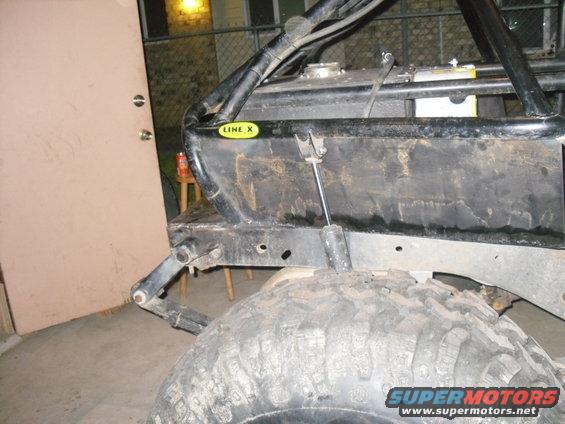

looks like it could use some protection, it was already dragging in the video but otherwise a nice setup.
Ya it was hitting a little bit, but consider this. That was in soft sand/clay. Rock isnt going to suck my axle in like that. The ram is behind the diff cover and so high that it would have to be a pretty odd Rock to hit it. (plus it can take some abuse anyways). If the problem ever arises I'll address it.:icon_thumby:

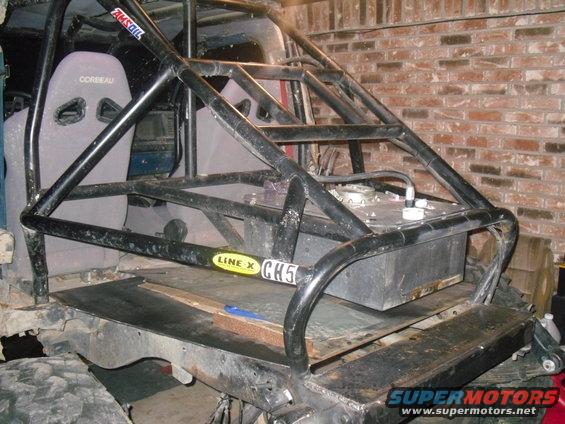

didnt get a whole lot done tonight, but I got a decent start.
Ballistic order came in and I threw these on.

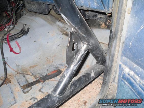

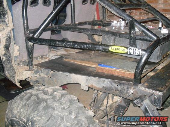

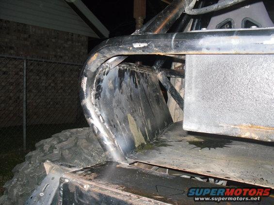

chopped the old remaining bed out, took off my Tail light pan and fue lines, air tank, ect.
Then cut out the base floor.
got a little more done tonight after work.

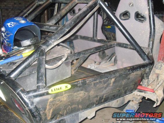

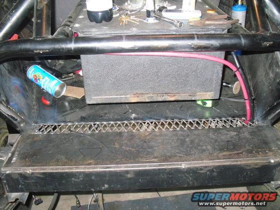

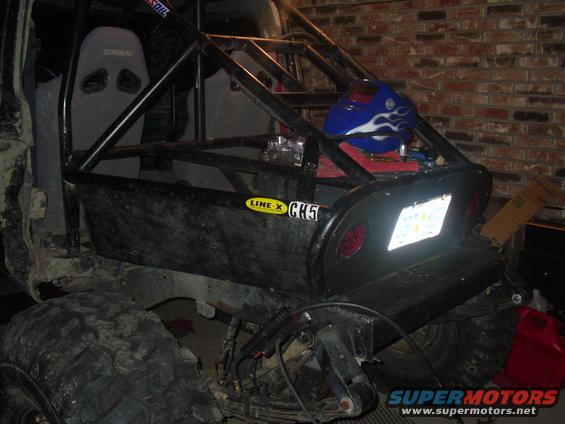

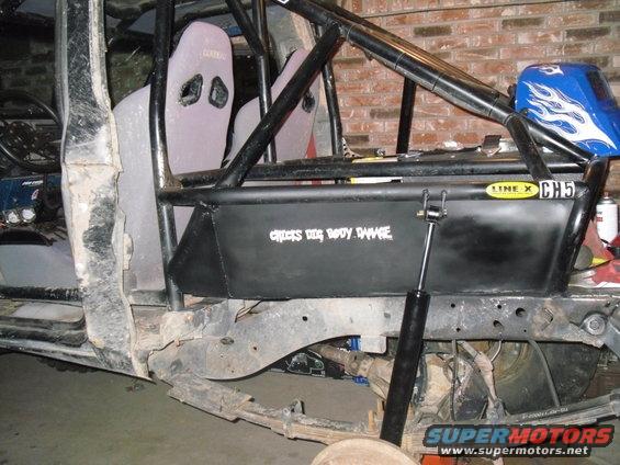

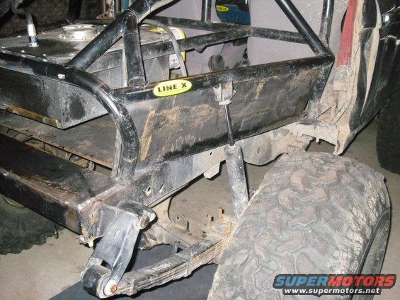

so I know I usually work fast and knock stuff out but this bed project has been slow. Havent had alot of time to tinker but hopefully it will be done tomorrow. Here is the progress from this afternoon, about 3hours worth of work.

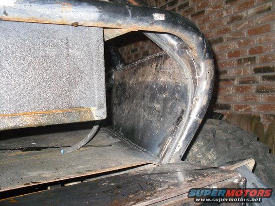

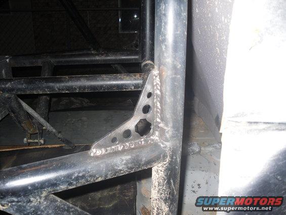

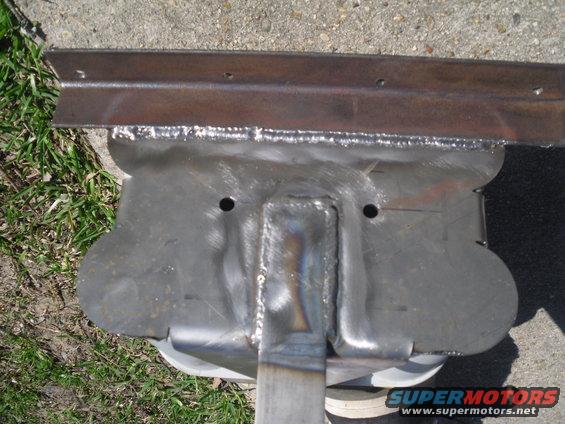

Finished welding skins in.

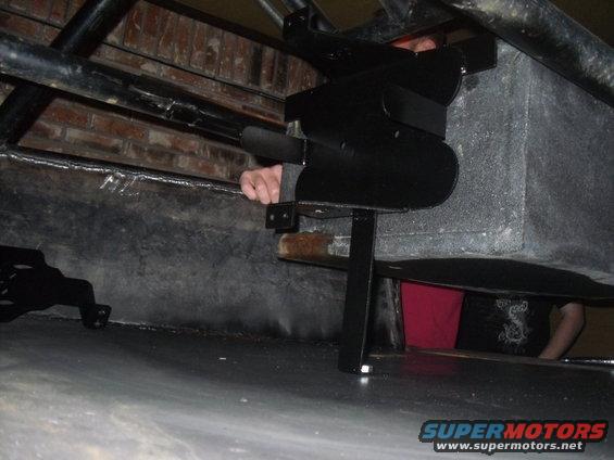

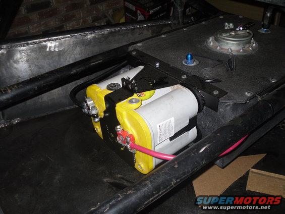

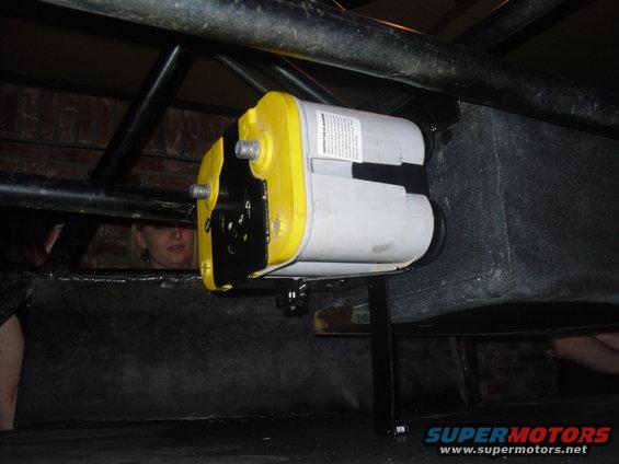

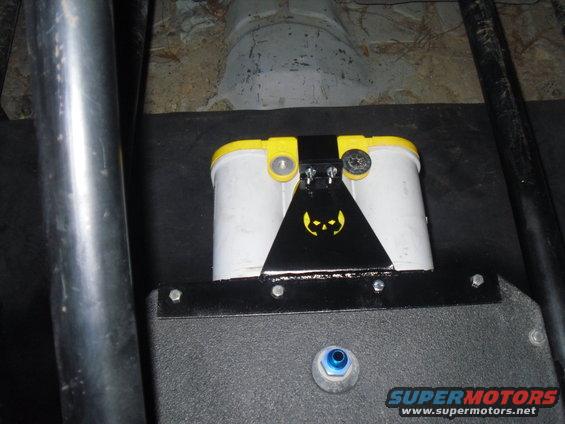

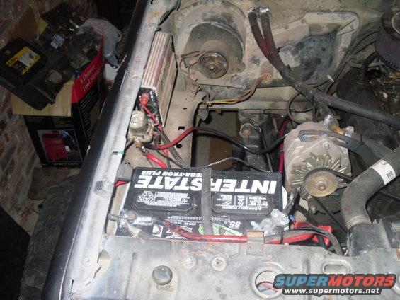

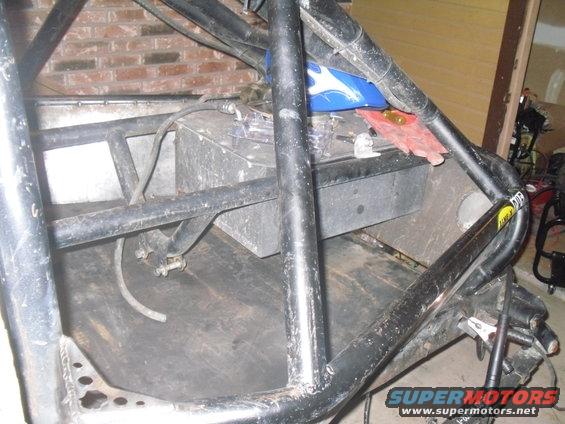

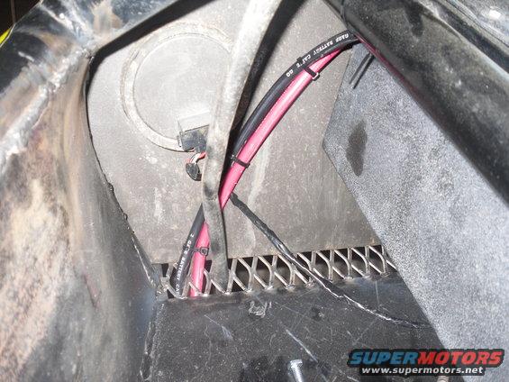

Modified battery box (adding lower foot tomorrow)

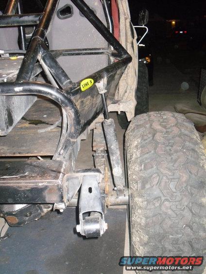

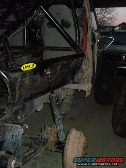

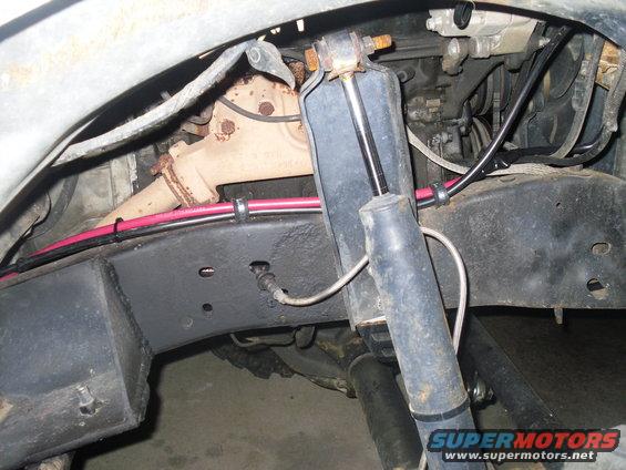

and the new Shock locations (already cycled suspension for clearance)

thanks. here is more.

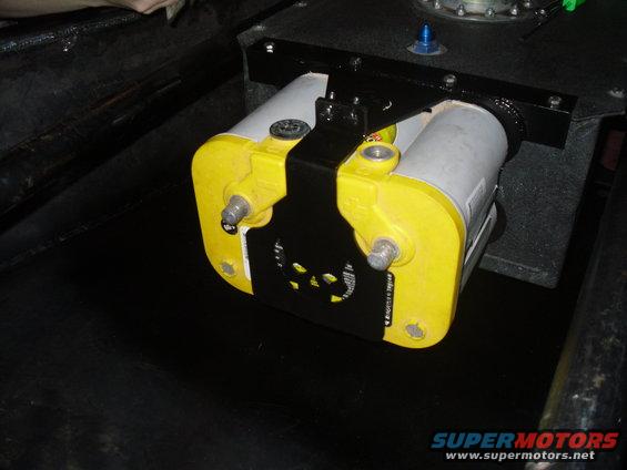

then you can see here, I welded the bolts in, and used wing nuts so there is no tools required to pull battery, thought it might come in handy.

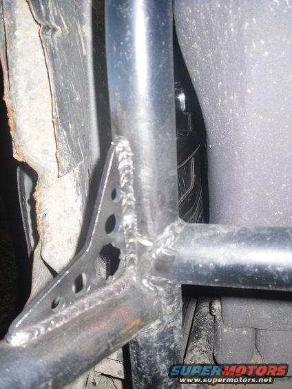

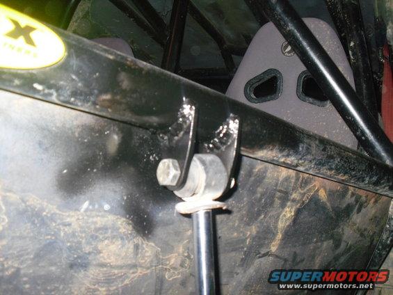

shock mounts welded in.

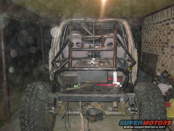

should have it mostly tied up today, here is progress so far
