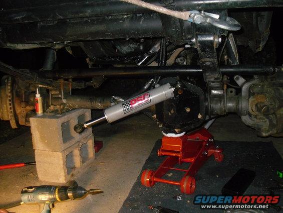

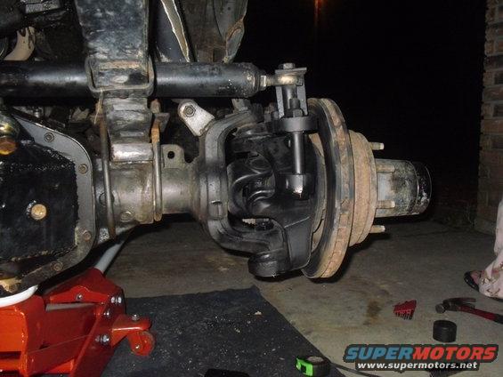

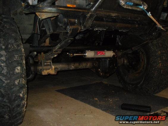

so I got to work tonight, luckily i was able to save all 4 wheel studs from being replaced with my die. I also looked into using studs instead of my bolts on my hi-steer arms and deided not to, checked all the bolts with my torque wrench and all bolts are still at the same specs. The hi-steer is 1-off "self designed and home made" so I'm still just getting comfortable with them. I did however finish the "bracing" that I've been meaning to do and I am now much more confident in the hi-steer arms and the knuckles themselfs with the full hydro.

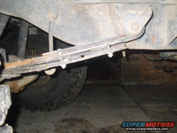

Never posted pictures of these, but they are so the springs wont wrap and break, the bolts i used proved too weak because ive broken a few, I will be adding 2 more on each side of the spring on both sides.

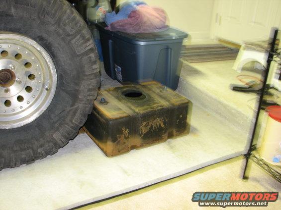

realized there were a few other things I never added.

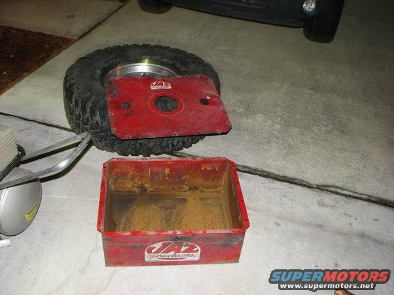

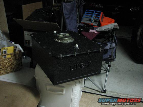

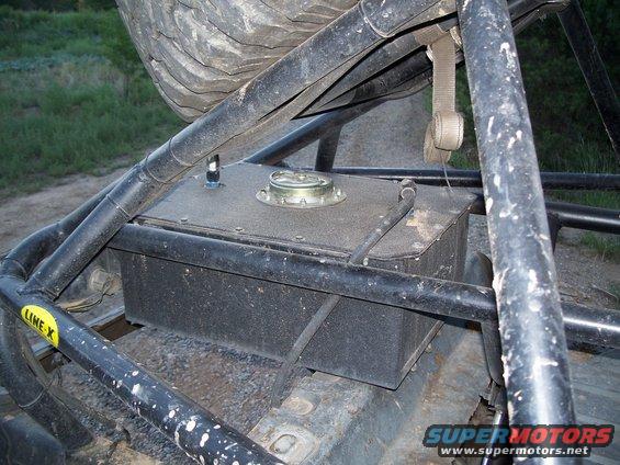

Fuel cell:
JAZ: 8.5gallon Fuel cell w/ rollover valve.
Purchased new, and this was after about 1yr of use.

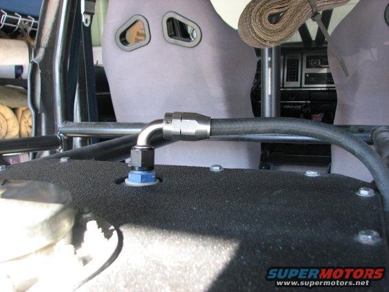

Trick fuel fittings
my B2
In this pic you can mostly see the vent routing, it goes up the driver side of the cage, goes over at an upward angle, then back down and you can see the overflow/filter at the bottom mounted in the frame rail.

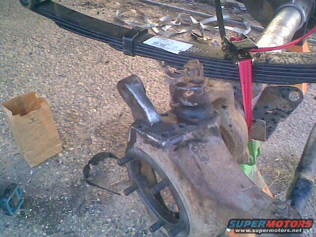

and this is how i did my Hi-steer arms.
Ground the knuckles as flat as I could, cleaned it up with my die grinder, Drilled and tapped holes, clearanced the upper caliper tab a little

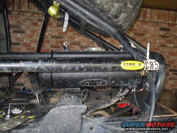

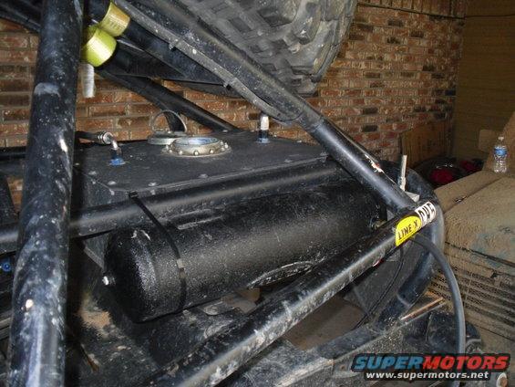

worked on the B-duece a little bit today. Mostly on the OBA which got put together then upgraded and never put back together, if that makes sense.
obviously this is temporary for the mounting, but the location is what im going to use, I am also ordering another 2.5gal sun performance tank to mount on the same spot other side. I am going to fabricate steel brackets off the cage to bolt them to.
