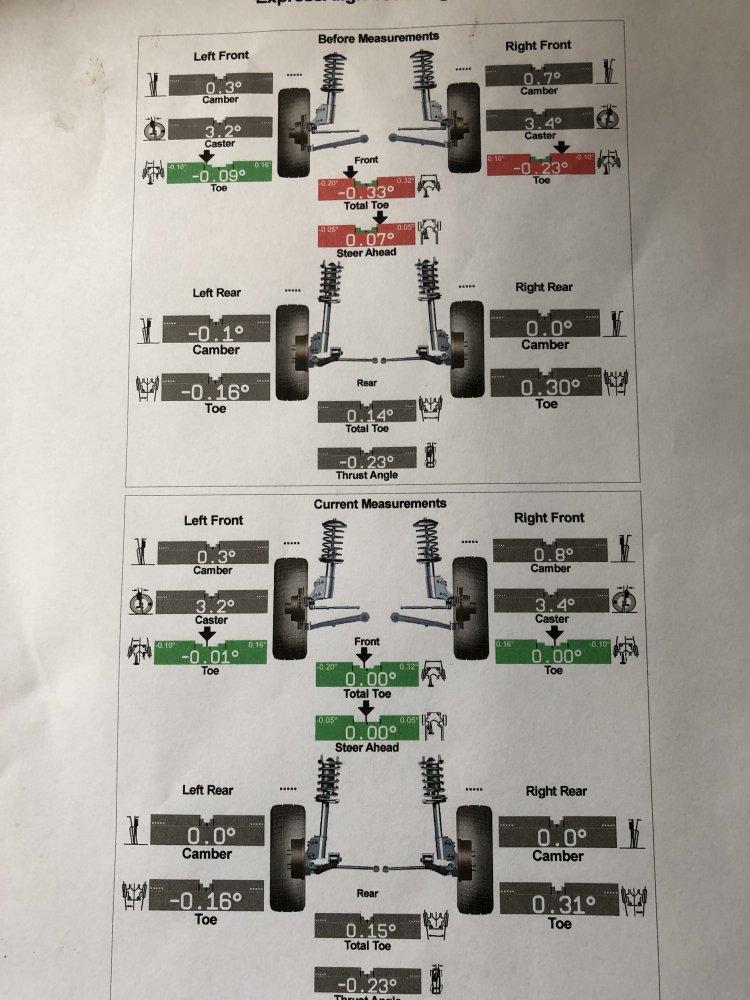

I replaced bushings, shocks, ball joints, inner and outer tie rods. I think I had it pretty close, but it is noticeably better now.

The only thing they changed was the toe?
That’s the only adjustment available. Caster is fixed and camber is set by changing bushings. I have the 0° bushings installed, and cross referencing the spring heights to the chart on the book, it’s in spec.
it looks like the driver’s side adjuster was moved an imperceptible amount, passenger side was moved from 10 to midnight.

‘85 2WD. Everything is set to factory specs.
