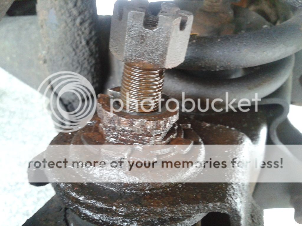

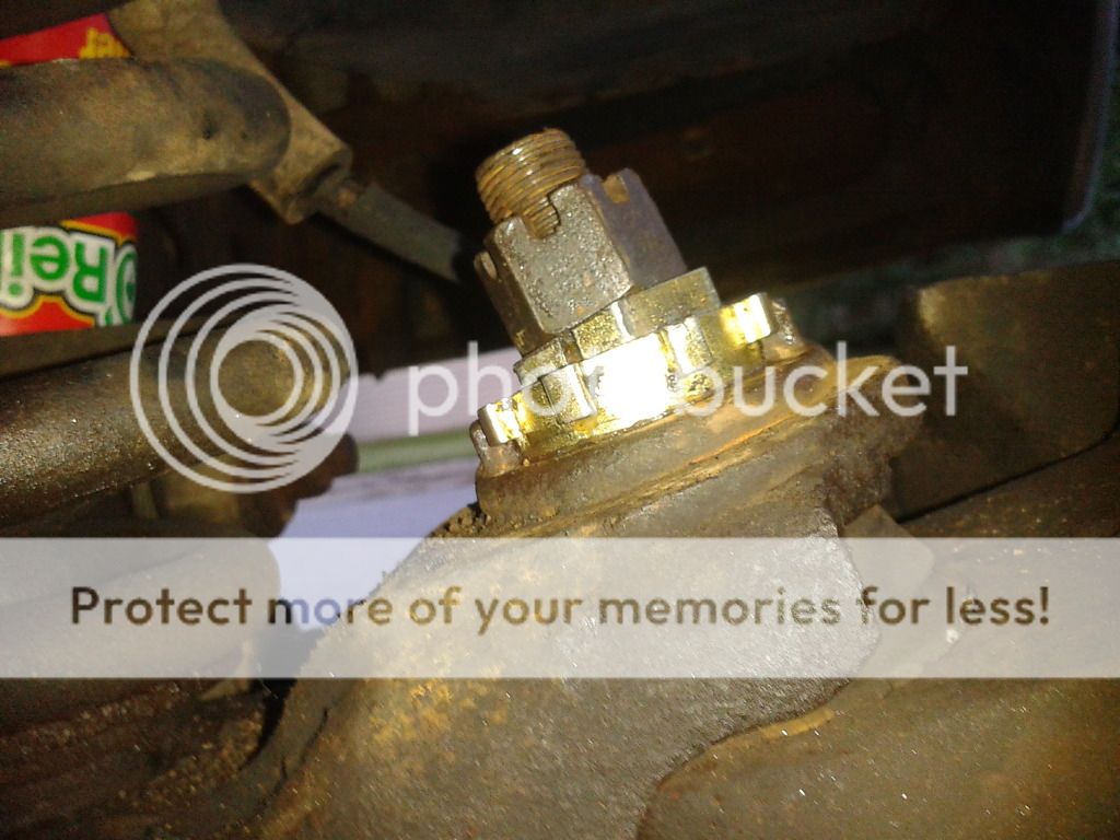

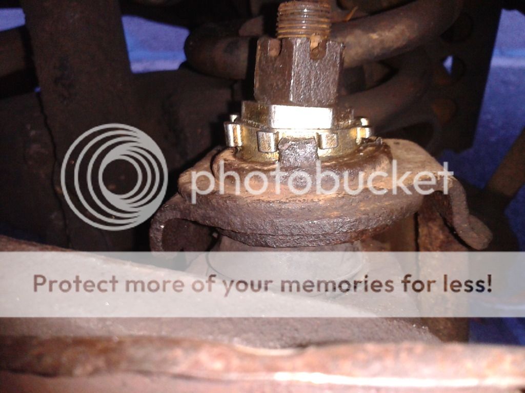

Ok, so I decided to take a crack at this today. I got the pin out of the top nut, took the nut off, then removed the c-clip. I've tried prying up on this, and twisting it, but I can't get it to budge. I've had PB on it for about an hour now. I can't seem to find a decent spot to grab to pry, that lip is only about an 1/8" of an inch. Is there something else I'm supposed to remove first before prying? I put the nut back on the top and beat on it with a hammer because I read somewhere that it can make the bushing come up if you do. I haven't had any luck with that. I did spread the gap slot a bit with a pry bar and then a chisel, but that doesn't seem to have helped.

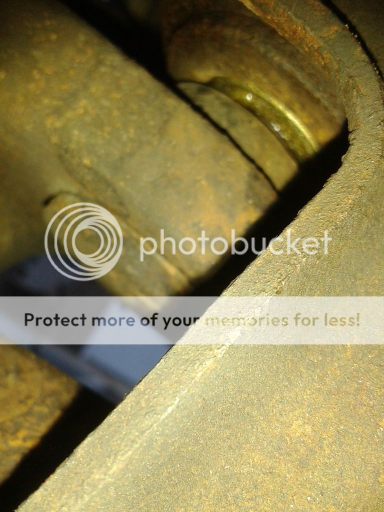

I finally got the passenger side to come out by beating on the bolt (with the nut on the bolt so as not to damage the threads) on the upper ball joint until the upper ball joint dropped down and then I could beat the camber bushing side to side until it came out. What a bitch. I dialed in the replacement adjustable bushing and beat it down as far as I could but it doesn't sit flush, I can't get it to go any farther. I torqued the upper ball joint nut to 100ft lbs. It still doesn't look right but I can't figure any other way to get it to go on there. The ball joint boot doesn't sit flush against the frame either.

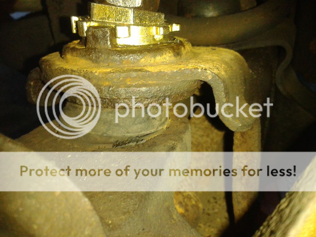

I've gotten it to go a little but farther down by using a punch on the outside ring tabs, but I don't think I can get it anymore. The ball joint seems to be angled back now too, but I guess that's the point right? The camber and caster change?
I see nothing unusual there, as long as everything is in place tight, it's fine. The boot is probably old and has taken a "set" in the old position the ball joint was in. It may flatten out after a bit, though I would probably suggest getting new ones for it.

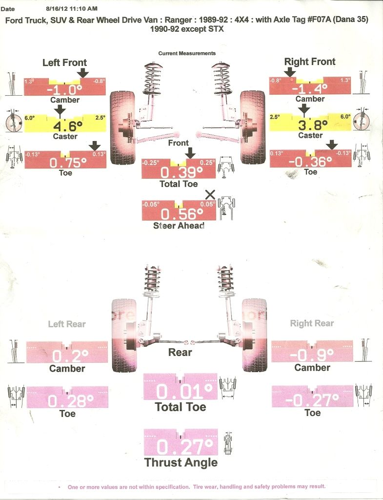

After making the adjustments I thought I needed I ended up with a pretty massive positive camber, so I decided to set the bushings to 0 degree and take it to the alignment shop and have them check it from scratch, then I would take it home and make the adjustments based on what they measured. Here's the printout of what the alignment looks like after I had set the bushings to 0 degree which is N/TU (N/TU on the chart below is 0 camber and 0 caster).

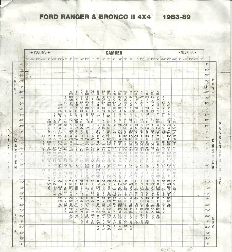

I was aiming for .5 camber and 3.5 caster since that's about dead middle. So using the chart below I came up with these figures:
-1.0 + 1.5 = 0.5 driver camber
4.6 - 1.0 = 3.6 driver caster
-1.4 + 2.0 = 0.6 passenger camber
3.8 - 0.25 = 3.55 passenger caster
So going off this chart I need to add 1.5 degrees to driver camber, -1.0 degrees from driver caster which gives me I/V. I need to add 2.0 degrees to passenger camber, -0.25 degrees to passenger caster which gives me ST/QR:
Now either I'm reading this chart completely wrong, my math is off, or I'm doing something really wrong here because once I applied the changes to the drivers side bushing and set it to I/V I had a massive positive camber. I haven't done the passenger side and have not had it re measured but I can tell just by looking at it that this isn't right. What's wrong here? I'm clearly screwing something up in the figures, what letters do I need to set the bushing to to correct the degrees?

your math is all right but you have the passenger side letters wrong, you did the camber right but you added more caster instead of subtracting caster. you should have HI/WX. but the driver side looks right.
edit: you were correct according to the chart, i misread it

I HAD LOTS OF PROBLEMS WITH THE PASSENGERS WHEEL WHEN USING THE CHART---I ENDED UP ADJUSTING THE WHEEL BY EYEBALL.....READING THE LETTERS ON THEBUSHING....then adjusting the bushing one letter at a time---driving the truck around the block---then adjusting the bushing another letter--making sure that the wheel was beginning to "lean" the way that it need to lean.....
THE CHART SHOWED THAT I WAS NO WHERE NEAR WHERE THE WHEEL SHOULD BE--EVEN THOUGH THE WHEEL STARTED LOOKING FAIRLY STRAIGHT....
so I continued slightly adjusted the passenger wheel caster/camber/toe from the reading on the bushing---NOT THE CHART---until the level/my eyeballs and the tape measure showed the the passengers wheel was correct....test driving the truck after each adjustment......
it took 3 times as long to get the passengers wheel correct (the chart readings just didn't jive with the bushing actual readings)
THE TRUCK DRIVES GREAT/NO TIRE WEAR AFTER 10,000 MILES.....
BUT THE CHART READING IS NOWHERE NEAR WHAT THE PASSENGERS BUSHING READING TURNEd OUT TO BE ON THE PASSENGER TIRE....
hope that makes a little sense about the usefullness of the chart....
