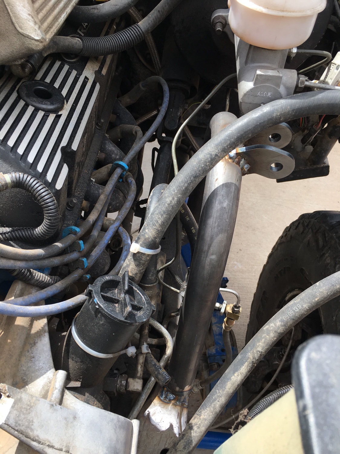

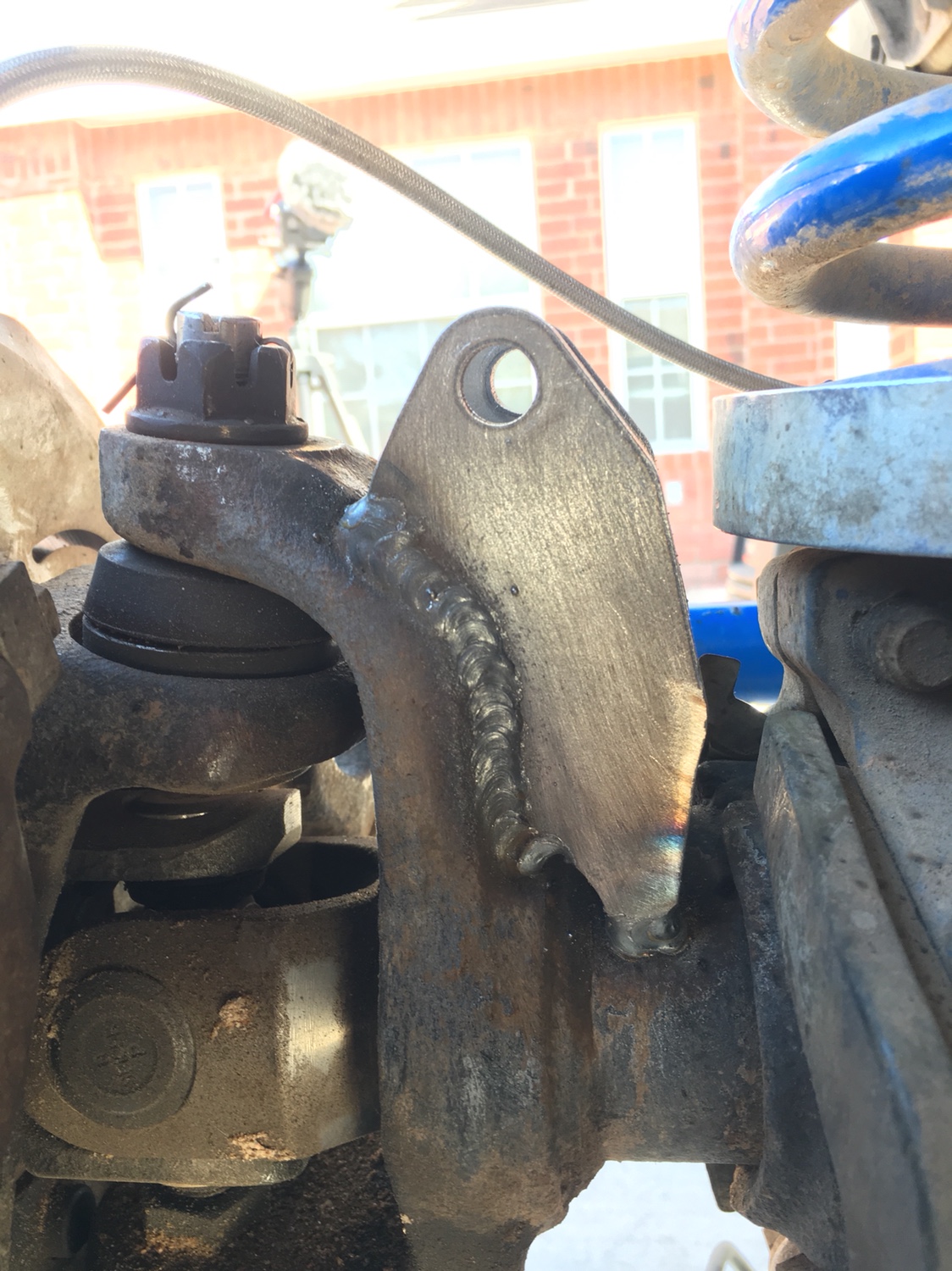

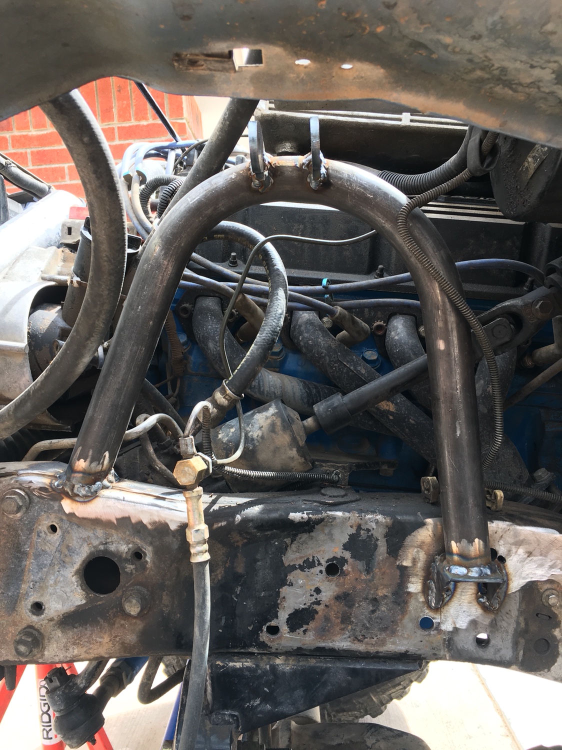

We got a couple tubes put on. This tied the exo cage into the front of the frame and should add a lot of strength to the cage. From those tubes, I build shock hoop tie ins/braces, and a front bar to support the radiator and hood.

The tube front is finished, and I threw on fiberglass fenders. I’m not sure how I feel about them. I should be painting it soon, maybe it will grow on me more once it’s all one color. Otherwise I still have my metal fenders I can throw back on there.
