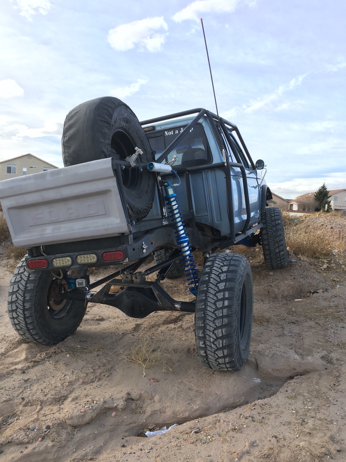

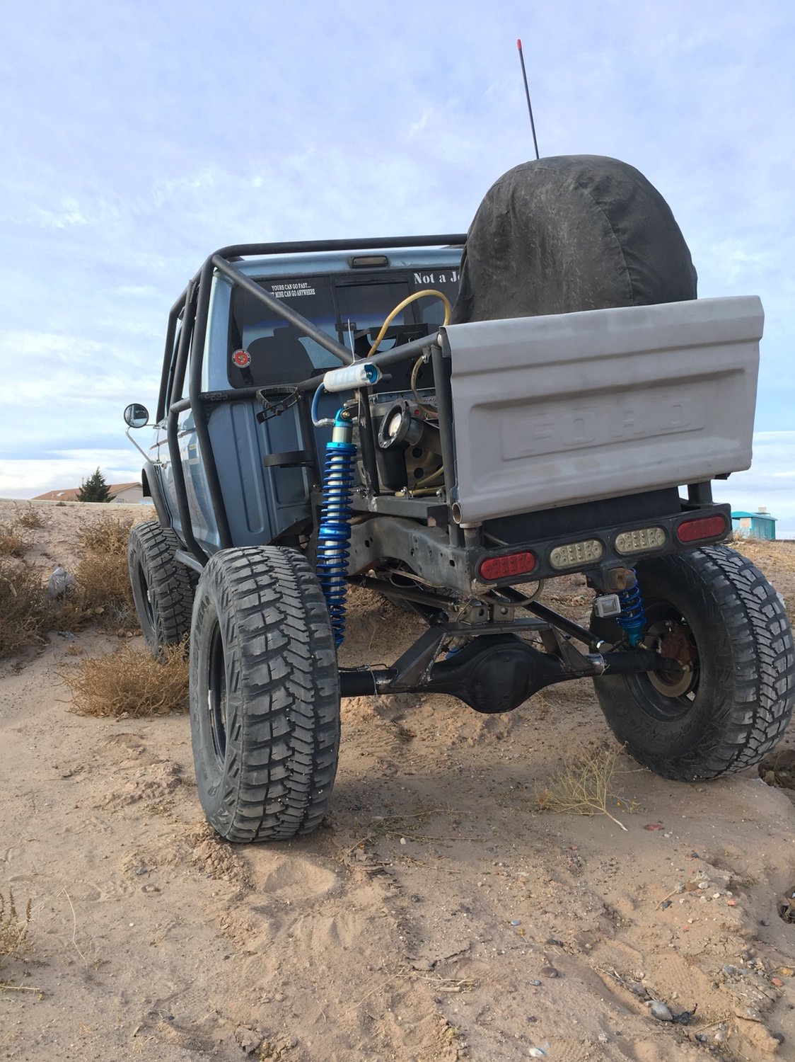

I got my limit straps, brake lines and bump stops all mounted up. I still have to redo the exhaust exit. I also need to change the springs still to drop it down 2 more inches at ride height.
Here are some flex pictures:
