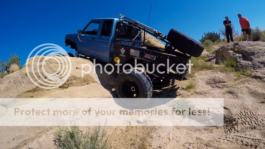

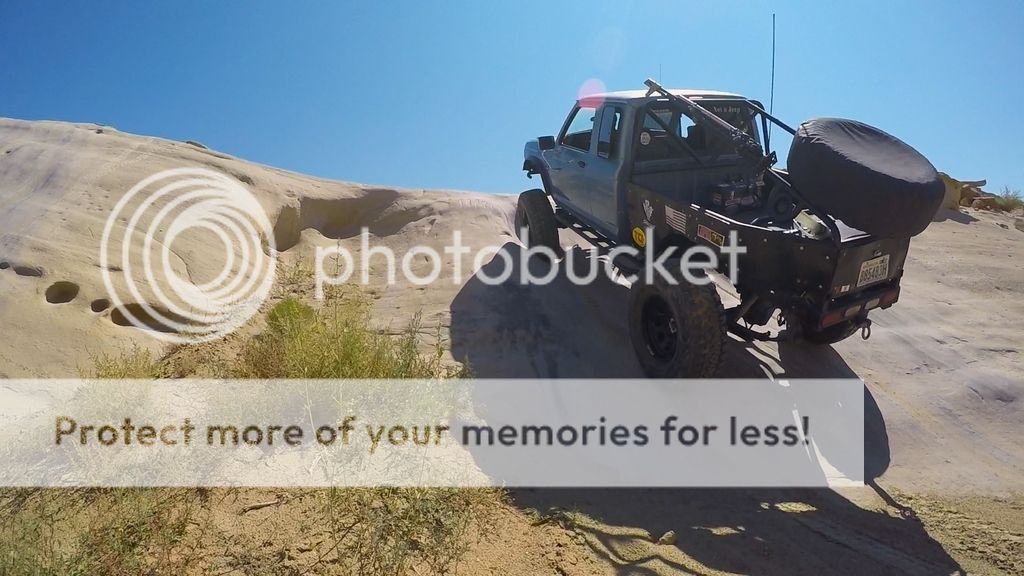

I have not updated this in a while, but I went wheeling a couple weekends ago. I have some things I need to fix but all in all a good trip still.
