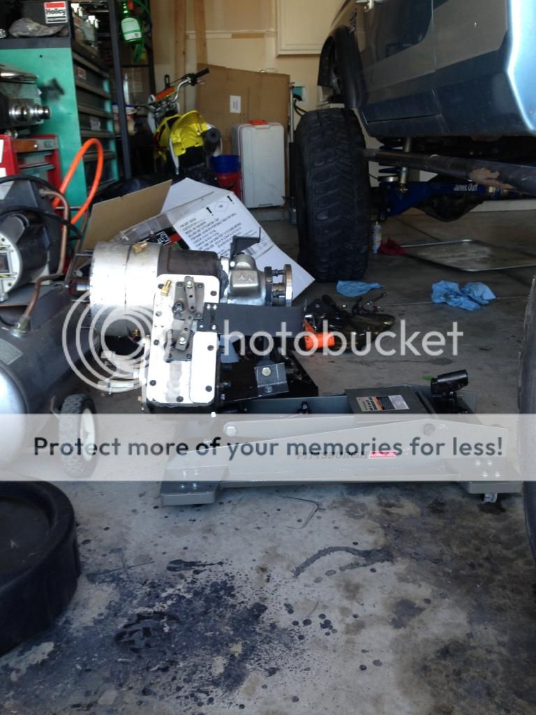

Well Iv'e been busy the past couple days getting stuff done. I had an issue with the doubler kicking out of high range at any speed over 5 mph. Called up behemoth drivetrain and he said about 10% of the initial batch he made had this issue. Sent me a redesigned shift rail right away. I swapped that out and that has seemed to cure the problem.
Here is my HF tranny jack with an adapter I made to bolt onto the doubler support so I can lift and lower the entire assembly out of the truck. It reaches high enough that I don't have to lower the truck any either.

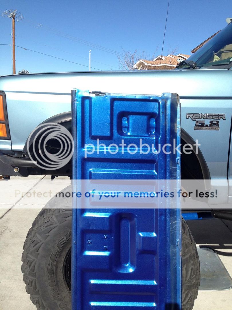

Here's a little test paint I did for when I repaint this thing someday when I work the bugs out and get 4x4

I'm not sure what that is, sounds fancy though lol. It's rust oleum metallic blue lol
