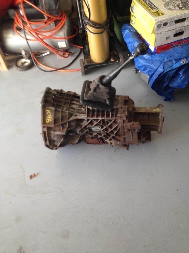

I finally got this pig. ZF5 47 from a 96 f250. I bought it off ebay 2 months ago. The original one I bought the salvage yard noticed a crack and sourced another from a different yard. They sent me that one and it was an M50dr2... So here we have the third transmission 2 months later. And they didn't want the m50d back so I have that laying around now...

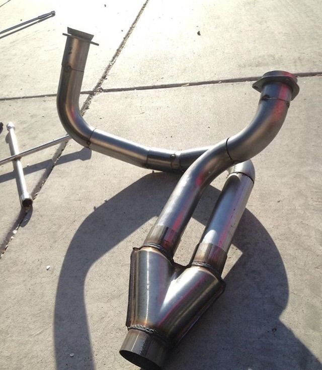

well I guess I will finally update this thread. I got the ZF5 in. It was a beast. I had to massage the trans tunnel a little bit even with the 2'' body lift. Also I had to cut the ears on the bell housing to make it fit. It was an extremely tight fit but I got it in and made a new trans mount and a new tcase support. I had to redo my headers and collectors with the zf5 in. I ditched the custom ones I made since they couldn't work no matter how I tried, and put some hedman 88400 headers in. Then I made a nice y pipe with 2.5 from the collectors and 3'' from the y pipe back and dumped it out the side in front of the tire.
