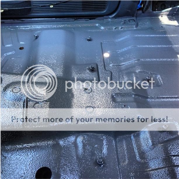

My 91 Ranger the stRanger
ripped out the interior, cleaned, scrubbed and wiped it down with mek. Then I put my first coat of monsta liner, tinted quartz grey down

How did that Monstaliner work out for you?
i was thinking about buying that for the rocker panels around my truck.
did you like the product and how it went on and ect.?
The kit was very nice, good instructions, labels and high quality stuff. It was easy to put on, just the surface prep takes a long time if you do it right. But you just now the catalyst into the big can, (or a 2 gallon bucket if using tinted monstaliner) and get to rolling. After the 1st coat dries do your second coat. Dry times vary but the instructions describe all of that
