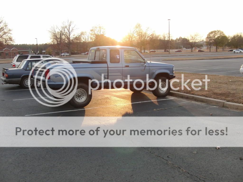

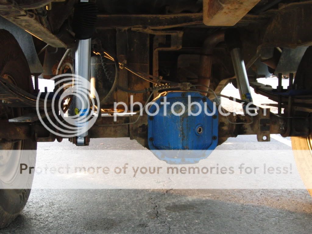

Heres a couple quick pics I snapped. Last night I thought the shocks were about perfect length but it seems the rear settled a bit and I might spring for the 10'' bilsteins instead of these 11''.

Awesome, it's gonna be sweet with proper meats under it. Yeah be careful you don't bottom out those shocks since you've got no bumpstops.
x10.......hate to see those purty shocks get FUBAR.....

Yeah after my christmas shopping is over I will be getting some shorter ones, I kinda just made an educated guess with the 11'' travel length.
