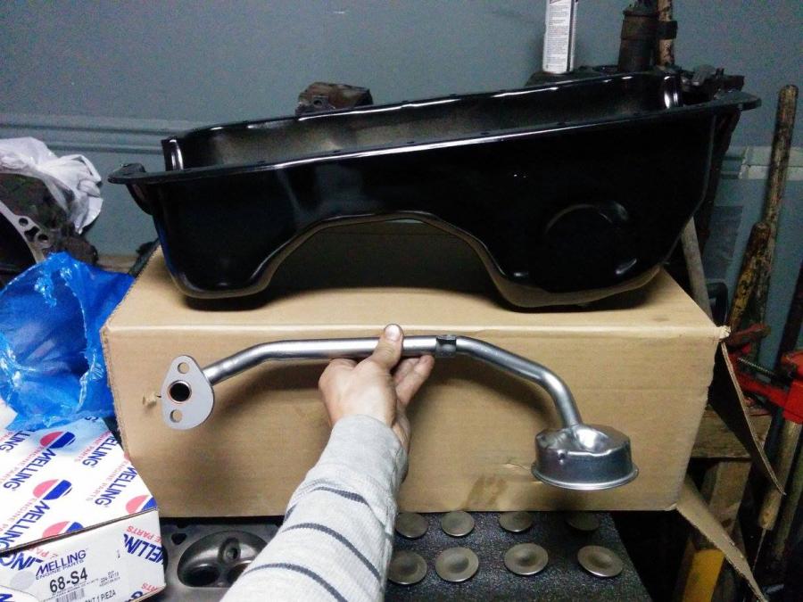

ordered a crown vic dual sump pan and pick up tube

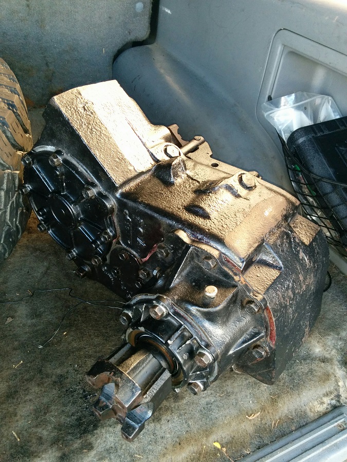

Getting transfer case out of the shop end of the month (new gaskets, seals, and speedo gear)

got my transfer case ready to rock but there was too much shit in the c6 pan for my liking, so refresh it is. and im doing it in my shed. lol. might film it, we'll see :beer: :beer:
t case

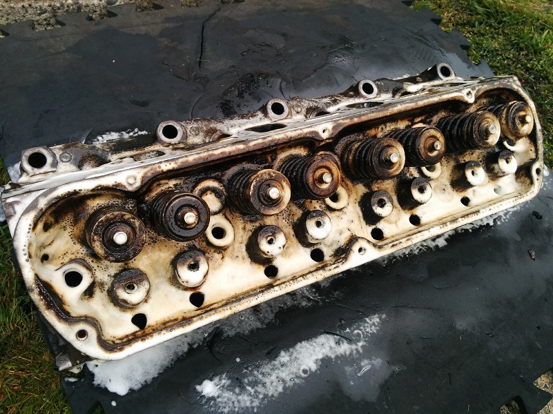

Modding some E7TE heads to replace the butt terrible D8 heads.
Polishing the combustion chambers and exhaust runners as well as removing the hump in the exhaust runners and blending the entrance right around the exhaust valve/exhaust runner entrance roof. I'll get new seals and lap the valve.

Crown Vic 351 pan & pick up tube :D
