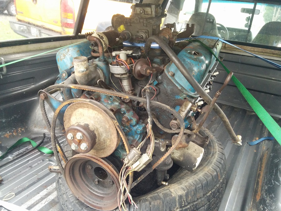

Well, later that same night i was able to back out of buying the 88 f150/302 because i found a 75 351w out of a 3/4 ton camper van for sale with only about 40,000 original miles on it. was selling the motor and transmission together for $500. got him to sell me just the motor for $300. Its a 1974 block though which is awesome because the 69-74 351 blocks are really damn strong blocks! Its running last summer and was pulled this past april and has been stored inside. Needs a cap and rotor (because he broke it pulling the motor), and plugs. gonna throw a carb kit and a water pump at it too. also have to heli-coil a couple exhaust manifold bolt holes. I need to find some early 70's manifolds now..
the drive home, valve cover sticker, casting numbers

Nice find! Are you just going to clean it up, paint it, and run it?
going to replace, the carb with a Holley 2brl, cap & rotor, water pump, harmonic balancer, might have a pair of 1970 manifolds here next week. Using the alternator it came with. I'll see if i have room to use the ps pump and bracket it came with as well.
other than that, just gonna run er as is. oh im gonna pop the pan and clean out the pan/new gasket. spray off the bottem end, prime er with fresh oil and fire the blue beast up!
