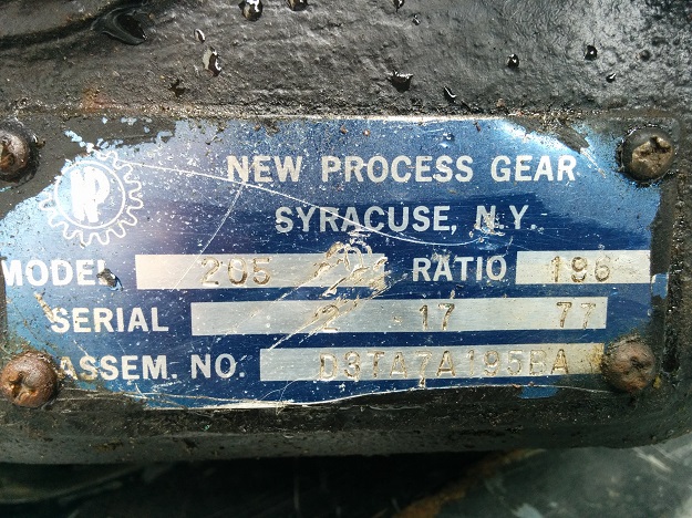

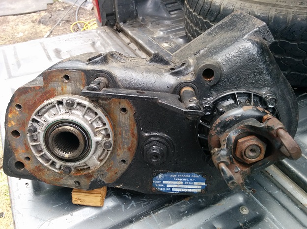

And i also picked up a NP205 for $180 today. stoked :headbang:
