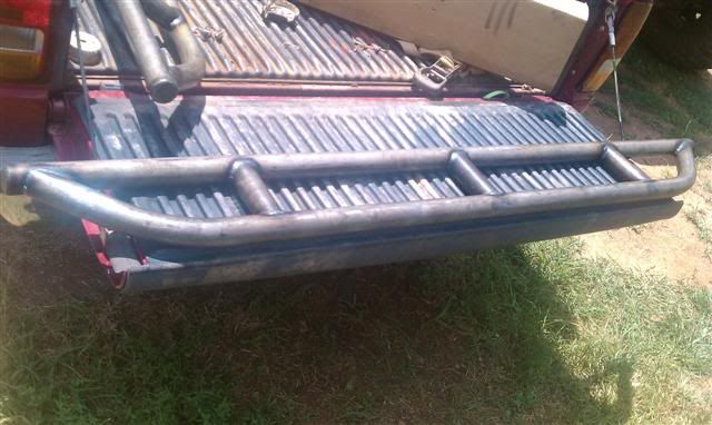

Got the sliders on today. Got some extra DOM to do 4 legs per side instead of the 3 that it comes with.
Ill clean them up and sand them down a little bit and paint them tomorrow. Ran out of time today. Going to test them out this coming weekend at URE.
Side profile shot. I spaced them out enough to help keep trees off the sides if it gets tight.
Mounts how it mounted to the frame. There are 4 of these per side.

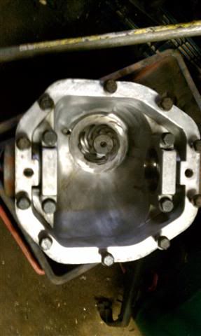

Went to Uwharrie last weekend with the group Explorer Forum and it was doing great. Did everything I tried. Never failed. Then it broke. Broke pretty good at that. Broke the bearing cap in the front diff, broke the axle off in the front diff, and a u-joint. So that ended the day. Pulled the front diff and this is what I found.

Anywho did about $125 in damage to the ARB so I called them up and they dont have them in stock and will be like a month until they can get them. I cant wait that long and he said the bearing cap failure was a common thing with that locker and big tires. They have updated it since with a new design thats supposed to be better. I was looking on a local 4x4 forum and found a Powertrax lock right that will work in the front for $100 that looks pretty much new. Now wear on the teeth or anything Score. Picked it up and it will work for now.

Got the old d35 housing I had laying around and cleaned it up and got the seals changed today. Got to get a new crush sleeve and take it to my buddys shop and setup the gears again.
Powertrax locker

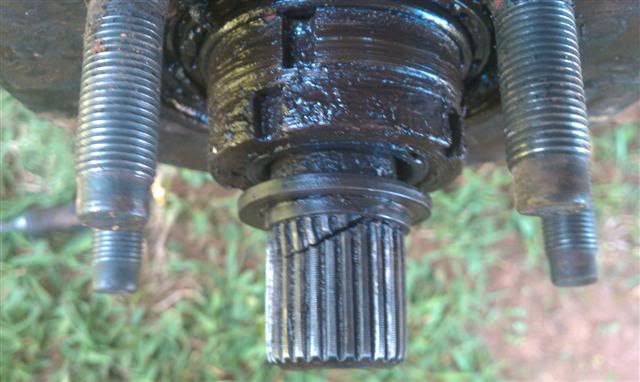

Well more carnage.
Guess 8.8's arnt as strong as they say.

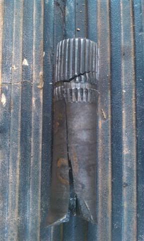

Where it broke the axle.
Also took out another front shaft. It got the stub shaft this time.
Almost split it in half. Cracked almost to the end on both sides.
