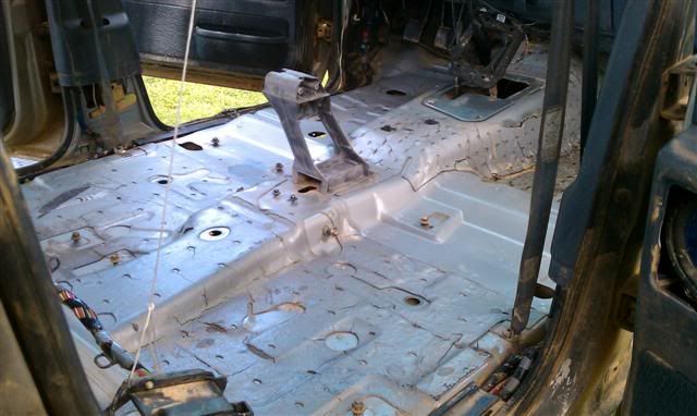

Got all the interior ripped out today and pulled the carpet out and sprayed it all out. Clean as a whistle now. Just running no carpet right now until I get some roll on bedliner to put down so next time I can just pull the seats out and rinse it out again. Im sure this will not be the last time. lol

Get some of that sound deadening mat. It's pretty cheap at Jc Whittney.
I didnt really notice a sound difference when I pulled it out. I can feel a little more heat but nothing unbearable. Maybe the bedliner will help that.

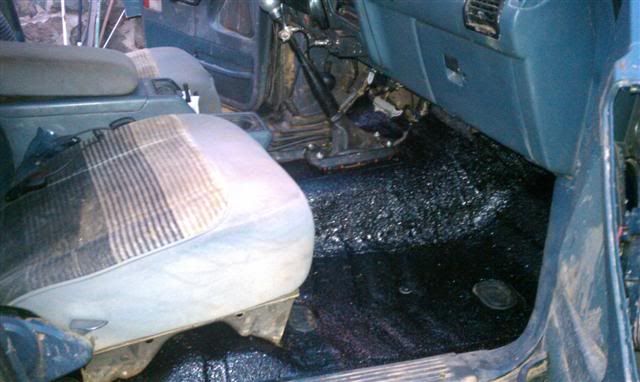

So instead I picked up a Herculiner kit and put it down on the floor today.
Put a medium coat all over first then a nice thick coat then another thick coat in the areas where people feet will be. Still have about 1/4 of the gallon left and its coated real thick all over. Should hold up pretty good I think.
Its still drying right now so whenever it sets up enough to put the seats and everything back in I will get some complete pics. These pics were after the first coat.
Prepped and cleaned the best I could get it. Its hard to get it clean with the sound deadner crap down.
Just got done putting all the interior pieces back in. The pictures dont do it justice. It was getting dark and the pics are with my phone and the flash makes it look a lot more glossier then it really is. Ill try to get some better pics in the day light tomorrow. I think it turned out pretty good. Time will tell.
