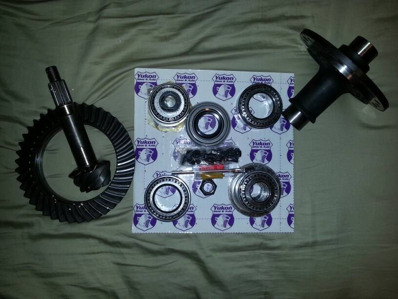

Going with 5.13 gears and a spool up front.

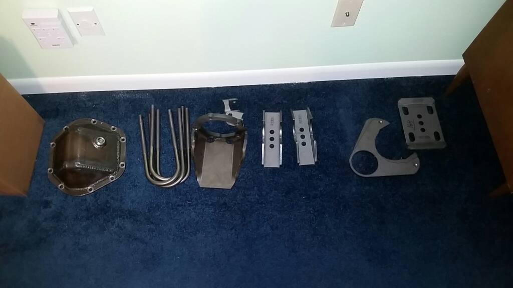

All Yukon parts.
Yukon Grizzly for the 9"

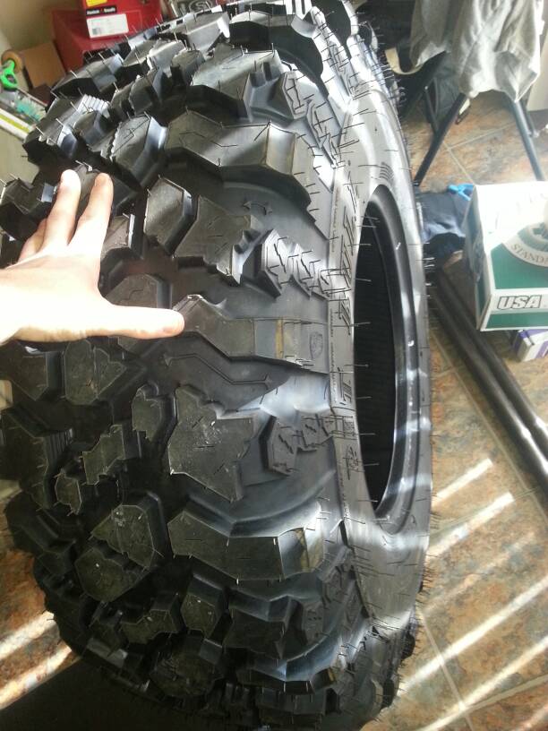

Went with 37x12.5x17 Pit bull Rockers. Damn these things look mean as hell!!

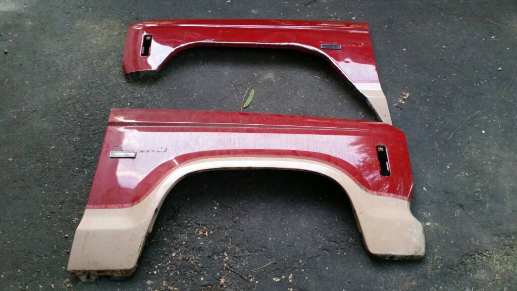

Cut the fenders to clear the Pitbulls.
Still need to trim a few things here and there. I'll need to flex out the suspension to see exactly what will have to go.

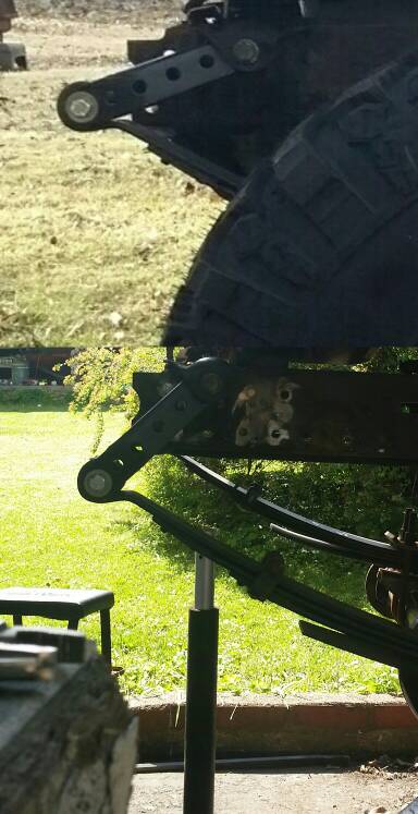

I went with skyjacker 6" lift leaf springs and 7" Chevy drop shackles for the rear. Moved the spring hanger back about 2-3" and flipped the leaf spring around backwards to achieve the stretch I was looking for. Tape line shows how much I'm going to hack off.
After the hack job.
Shackle angle was way off. I moved the rear spring hanger back 2".
Before and after. Right at 45* perfect!

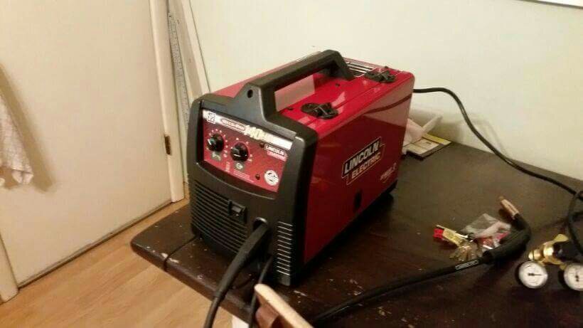

Bought a new toy. Lincoln Electric 140HD
