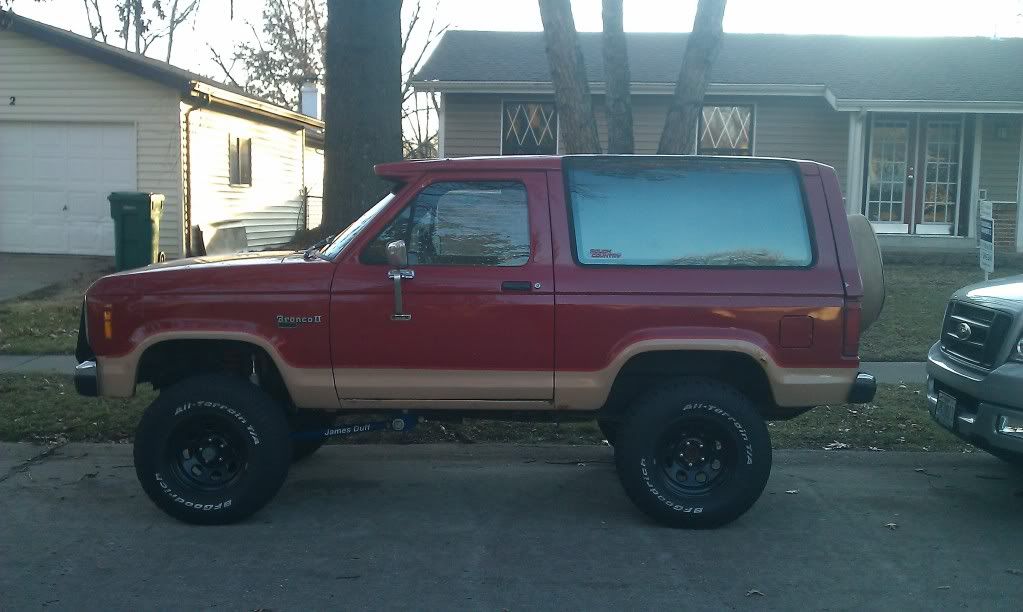

My 88 BII Build!!
looks nice!
How do you like the bedliner?
thanks!
I love the bed-liner, looks awesome! and the road noise is not that bad. I hear my exhaust more, but that because I put a Thrush welded muffler on. lol

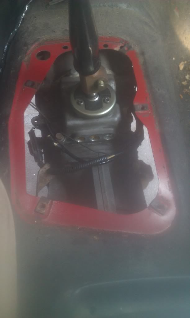

Shift rail fixed!
Alright I'm finally making a little progress with the M5OD swap! I took the top cover off the trans and took it to a shop to have it fixed. They replaced the broken piece and replaced the rubber plugs with some metal freeze plugs:headbang: Now I don't have to worry about them leaking.

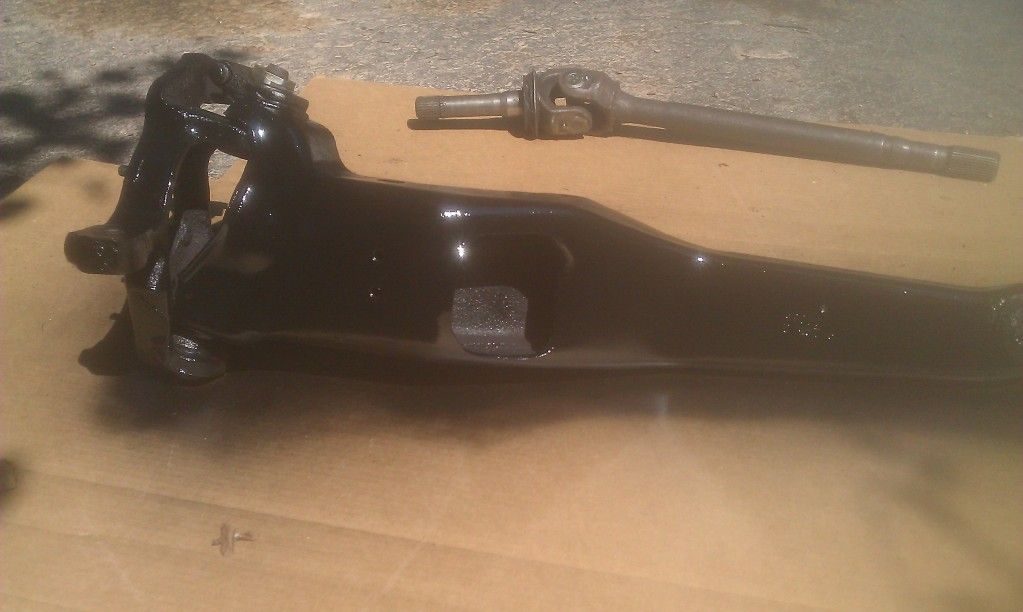

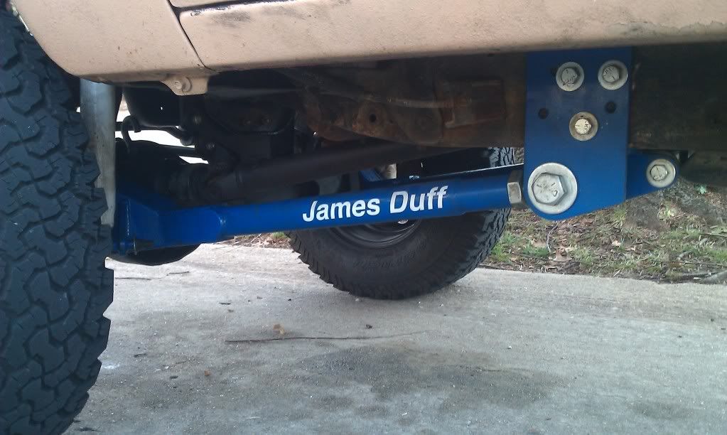

The 5 speed swap has been put on hold for now. I had to do something about my radius arms. The stock mounts were cracked and falling apart:icon_surprised: So I ordered some James Duff long arms and installed them:headbang: This thing rides pretty damn smooth know.
I also picked up a Dana 35 and some Spicer 760x joints. I don't have the axle back together yet, I'll probably wait until after winter to do all that, and get it under the truck.

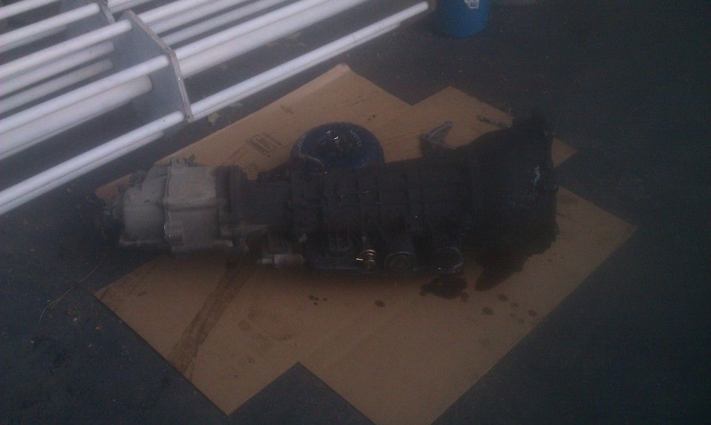

Well, this past summer I was going to get the Dana 35 swap underway but my truck had other plans...A4LD fried:annoyed: So began the M5OD-R1 swap:headbang: It took about 4 months only because I could only work on it over the weekends and I did a good amount of the work by myself. I already had everything I need to to the swap along with everything to do the 4.0L clutch upgrade.
Old and busted A4LD
I also went ahead and changed out the oil pan gasket, the old one was shot. That was by far the hardest thing I've had to do to this truck:shok:

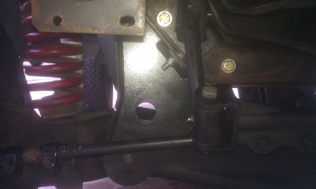

I also did a lot to the front end in preparation for the Dana 35. I picked up some skyjacker class II brackets and installed them. Along with the super lift super runner steering kit.
I also have some skyjacker XJ coils waiting to go in when I do the Dana 35 swap this spring.

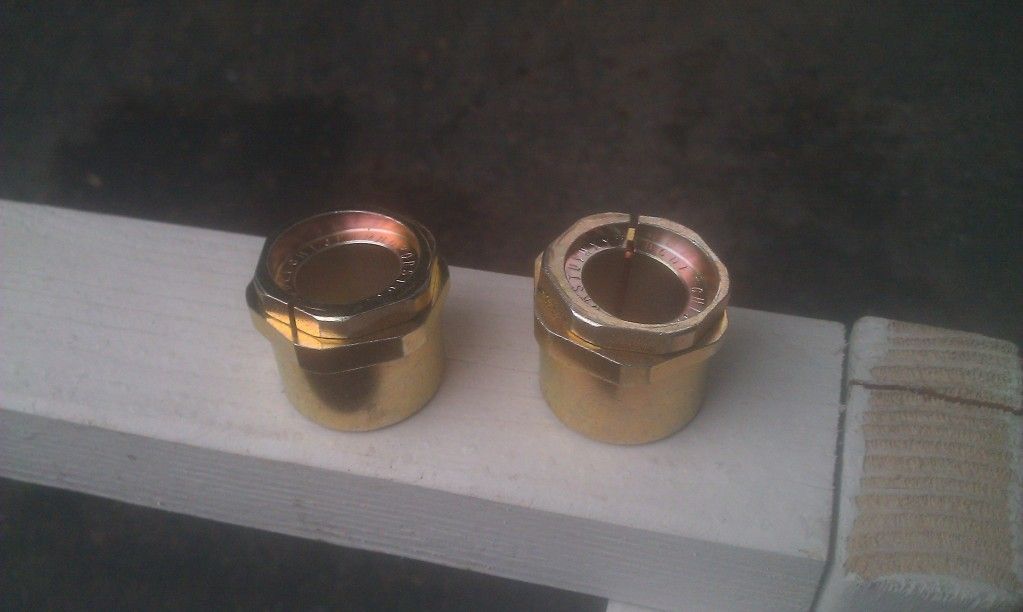

Moog adjustable camber bushings

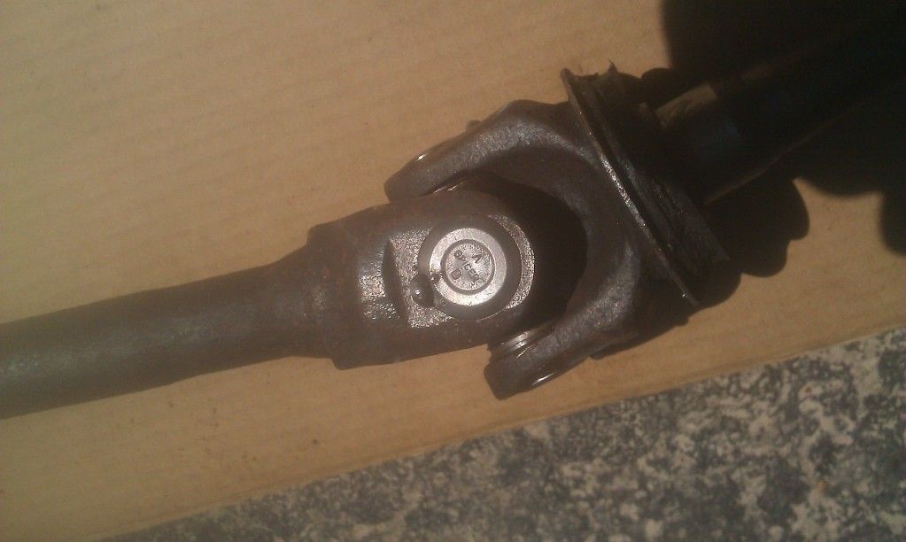

Dana 5-760x installed and welded in
coming together
