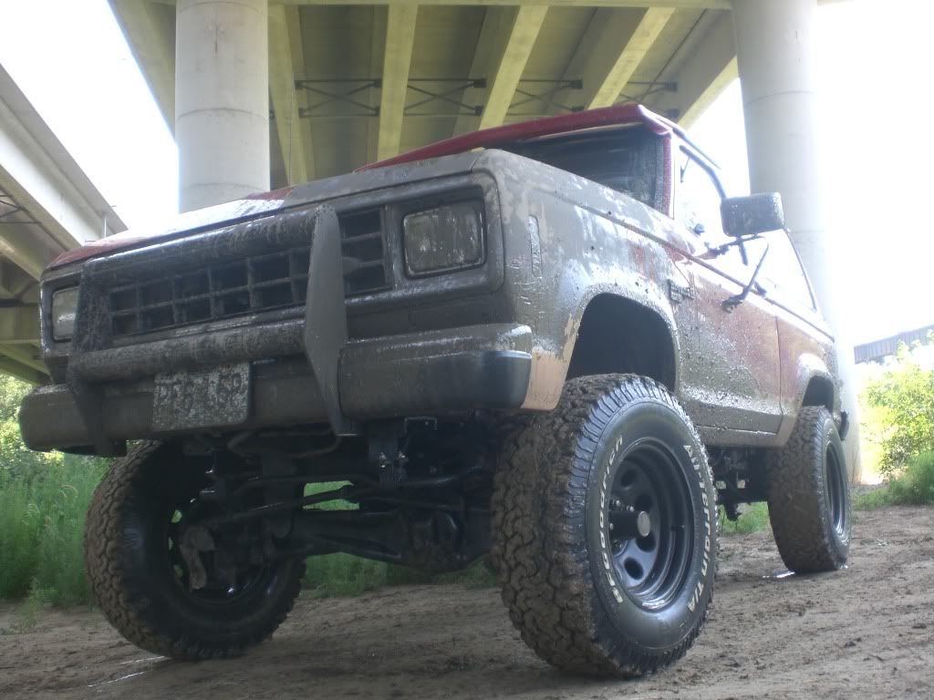

Well the lift was about $530.00 but I also had to get extended brake lines, that coasted about an additional $200.00. I also replaced my cv shaft with a u joint style, witch is a must if you lift it more then 2". I used an explorer sport shaft that coast me about $30.00 at the local JY. Then I had it rebuilt and shortened for about $135.00. So total coast was about $895.00:icon_thumby:
UPDATE for you guys:yahoo:
I finally took the bronco out for some fun and I have to say it didn't do to bad:headbang: My buddy and I went to a local mud whole down my the river. Nothing to major but it was a lot of fun!!!

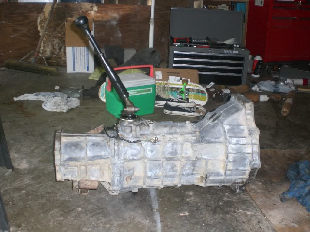

Well here are some pics of the M5OD-R1 trans all de-greased and ready to be cracked open.
My 88 BII Build!!
My 88 BII Build!!
I've never tried to re-build or even work on a trans for that matter, so this is going to be a slow process. I'm going to have a friend help me tare is down and make sure it good to go in the bronco. Plus I still need to get everything for the 4.0 clutch upgrade, and that's like $500.00 in parts that I'll have to save up for.

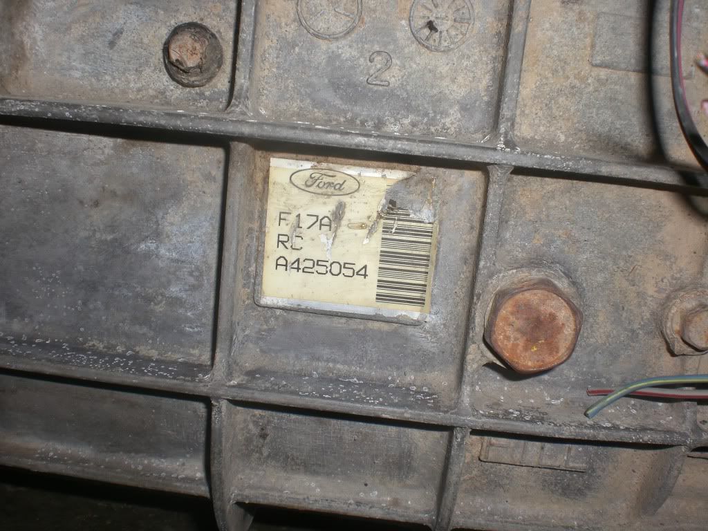

Finally got a chance to take a look at the M5OD today. I just took the top cover off and checked all the gears for missing teeth. I have to say it looks pretty clean. All the gears are in good shape and the syncros look good to. I'm by no means a tranny expert, I just took a good look at everything. The only thing I can say that might need some attention is the front bearing on the input shaft. It seems a bit to wobbly. But other then that it looks great:icon_thumby:
My 88 BII Build!!
My 88 BII Build!!
My 88 BII Build!!
I also noticed this tray. I'm not sure what it is, but it has some dirt and grime in it. Can you guys tell me what this is, and if I should be concerned about the dirt?

Any input or suggestions you guys have I will appreciate. Like I said I'm no tranny expert.
thanks
i have a question, the bottom piece sticking out in this pic goes to the speedometer cable, did you have to cut it to get it out? i've been trying to figure out how to get mine out, but it aint workin
