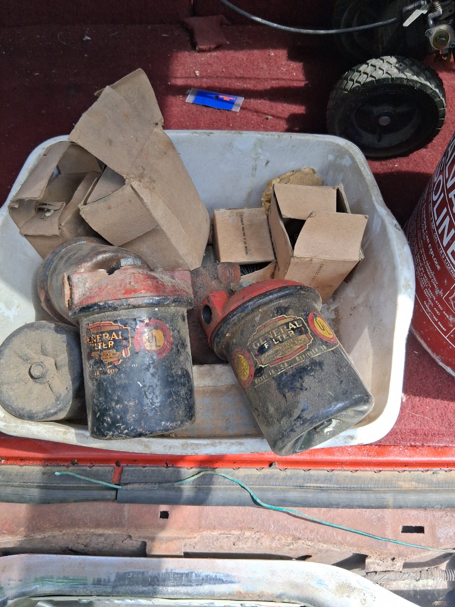

Some of you know that my B2s fuel system is kinda butchered.
Anyways....as of now my canister is gone and replaced by a regular fuel filter.
Ive heard the factory canister is actually more so the high pressure fuel pump doesnt get ahead of the low pressure in tank during high fuel demand situations.
I found these at an auction today...got them in a box full of other random shit for 10 bucks...
Can i use these?
I know they are for fuel oil (didnt untill i bought them)...but seeing as how my fuel line is already rigged it wouldnt be hard to get some barbed fittings that screw into this and use it as a canister.
My return line already goes directly back to the tank. Im thinking about using this (if i can) then putting the fuel filter infront of this...unless i can find a filter for these.
Any input?
