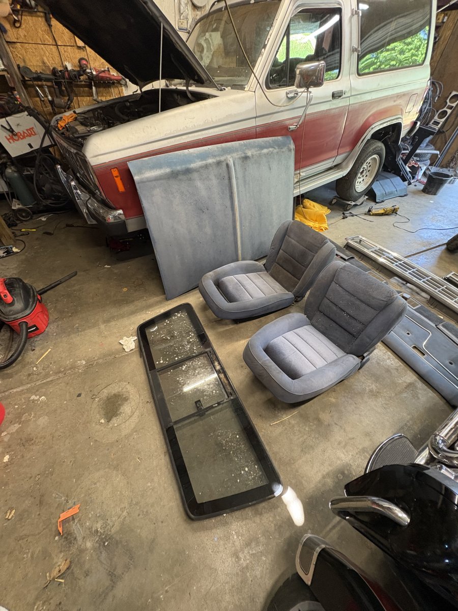

The rear bumper was a bust but I did get a bit of good luck. Found a guy on marketplace and his nephew had an abandoned Ranger extended cab on his property from’96. It is a rust bucket. He is tired of the tire kickers and seen I am restoring my Ranger. He is a Chevy gear head and had several older model Chevys so no use for a Ranger.

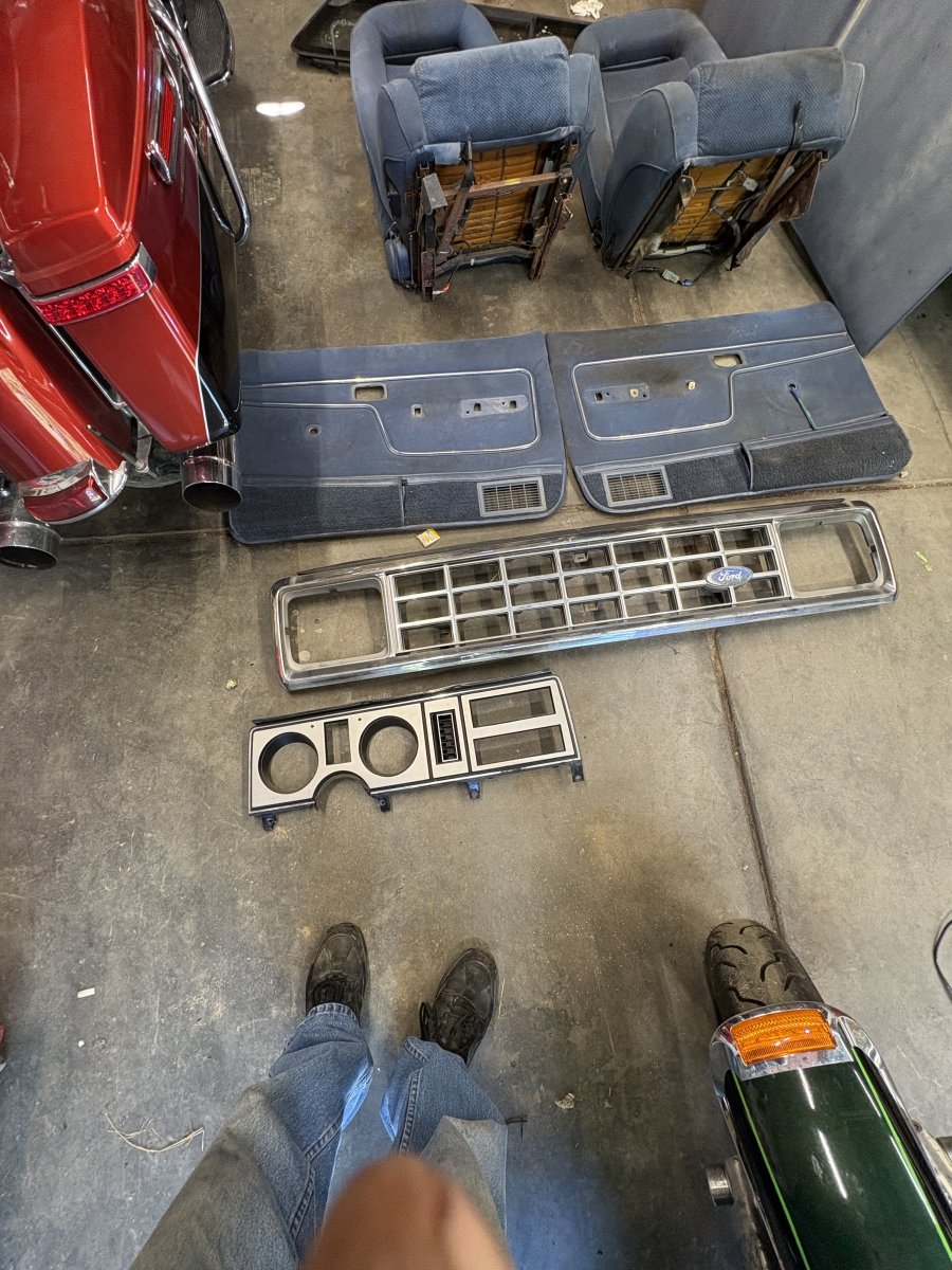

My hood had hail damage, a sliding back glass and lumbar seats. I am also buying another set of same seats. He did not want these to go to waste.
A nice grill , door panels and bezel.

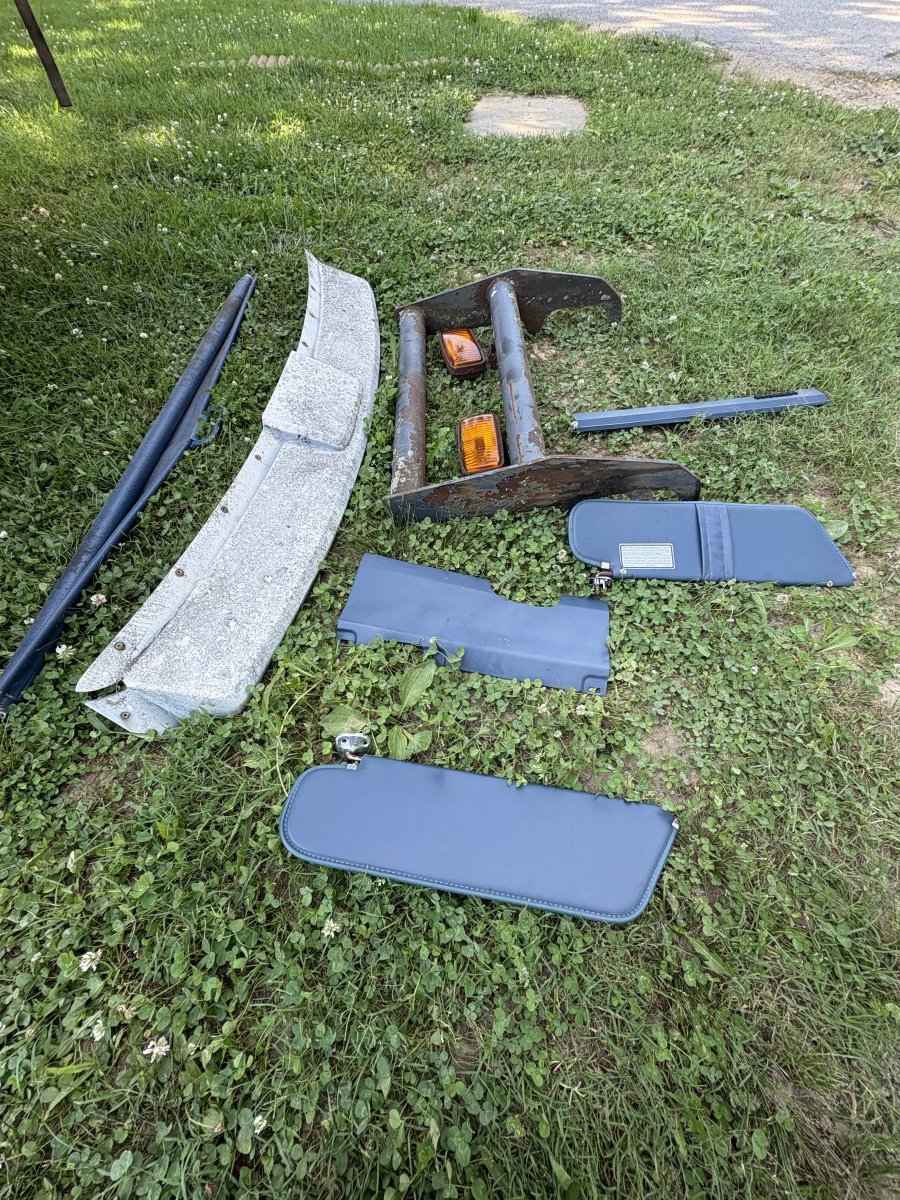

Nice sun visors, fuse panel cover better then what I have currently, dash trim, windshield visor, brush guard,and something I did not know is a sun cover for the extended cab back seats.

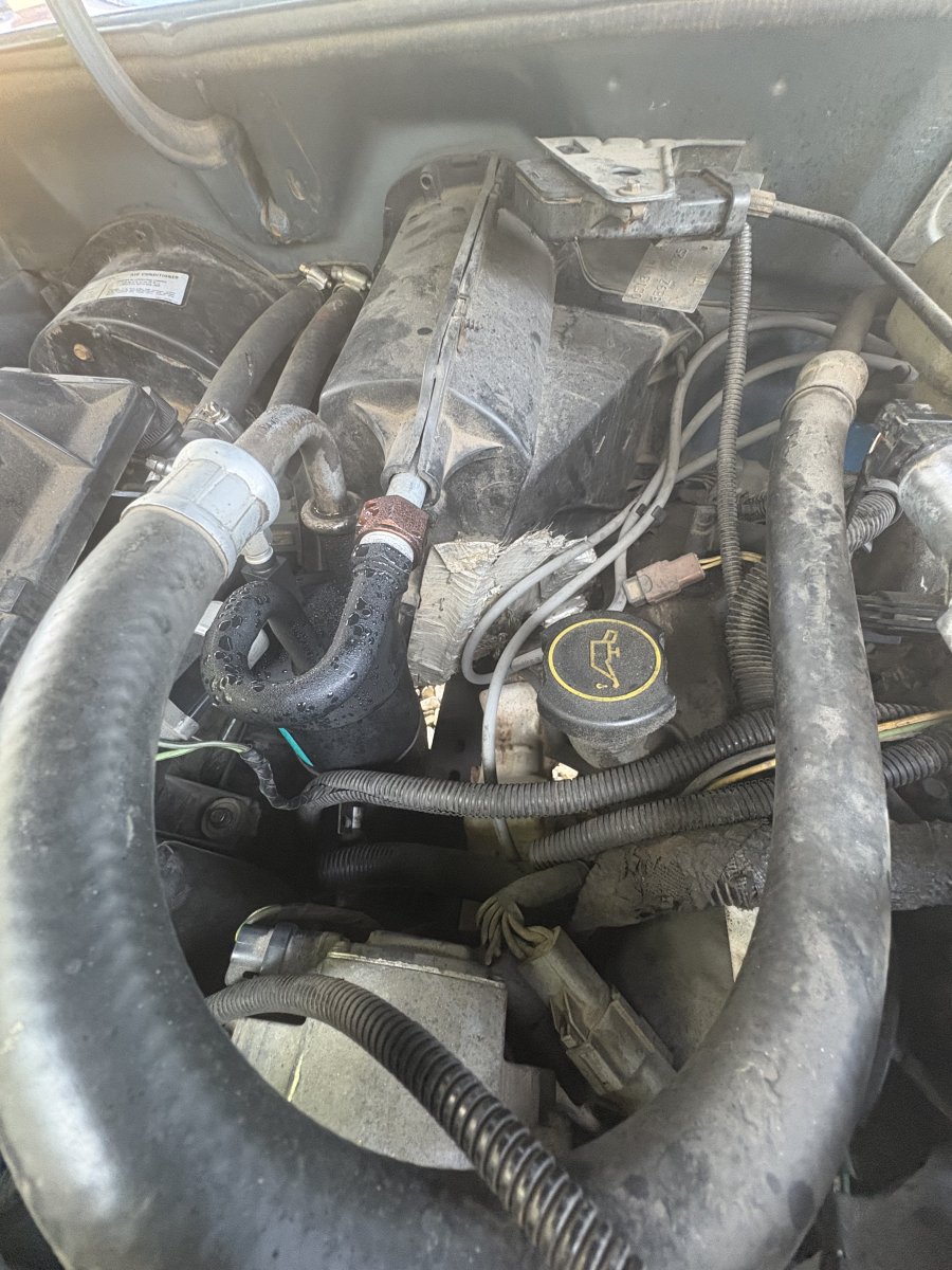

I got my AC recharged after the hose blew off. I was in the boneyard and every Ranger and Bronco I seen did not have the safety clip. I hope the one I have on will hold it from separating again. It is blowing colder than before. Condensation on the dryer.

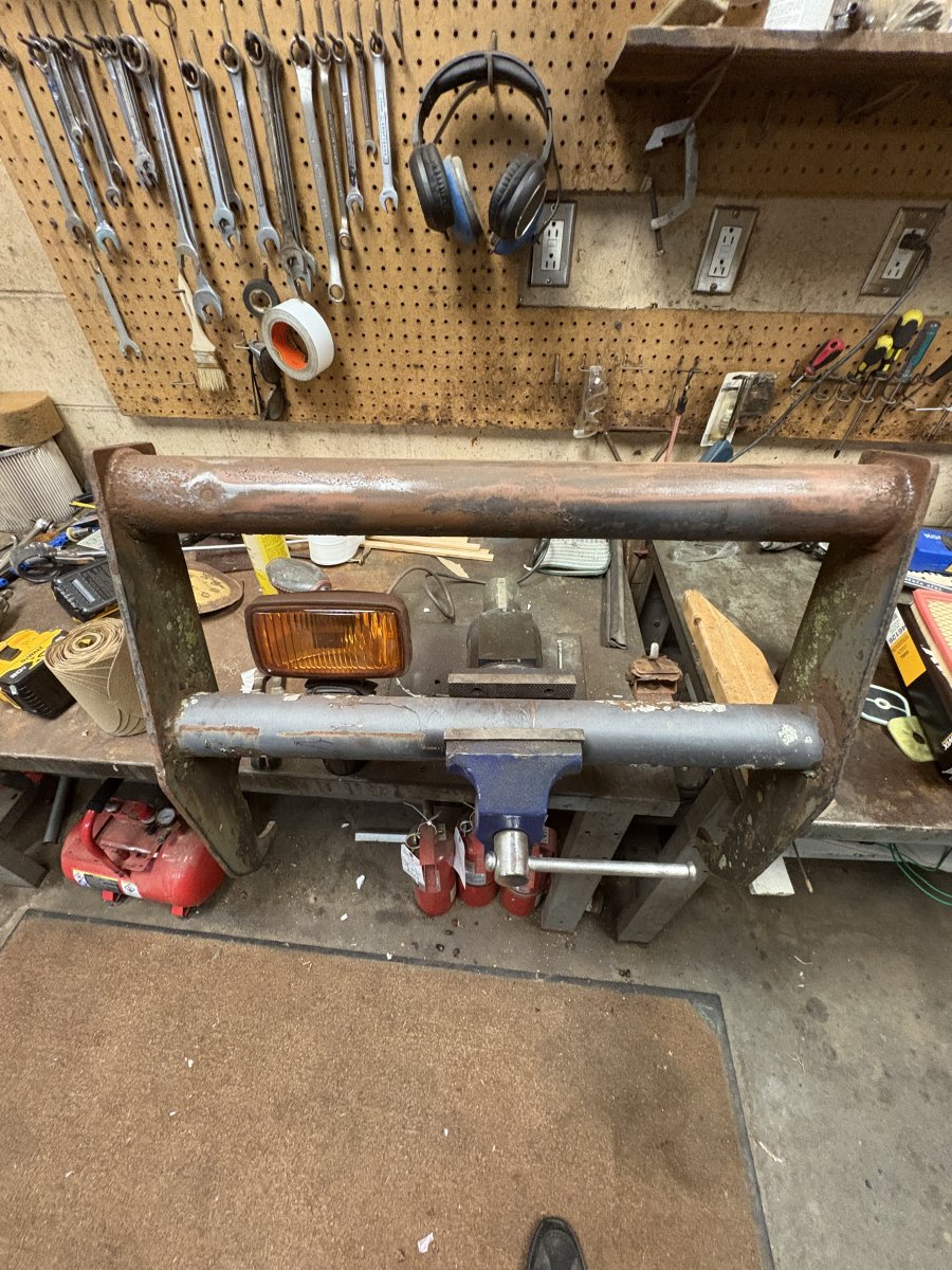

Got the bulket covered in body filler and the rest of the brush guard in about as good of a shape as it is going to get. A lot of work involved in it.

I was all excited to get it installed and the one bumper bolt that has been on the list to get replaced bit me in the rear. I think I need longer bolts fit the bottom anyways and I have to remove the bumper pad to get it to bolt on. Eventually I want to get one of my friends to weld a tube that goes around the headlights ti protect the grille.

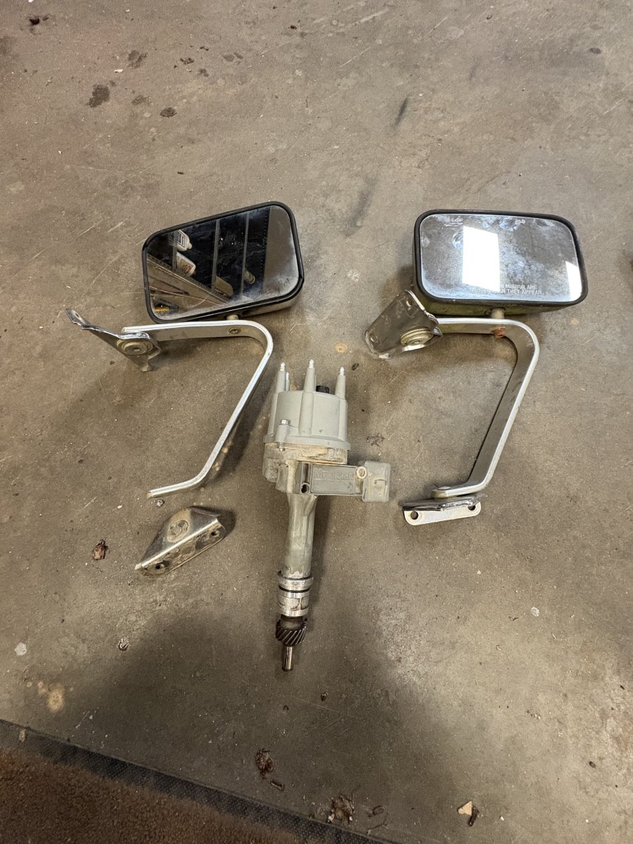

I was at the boneyard today. I got a distributor for the Bronco. I think I want to go flat black in these mirrors for my truck. Most are chrome. I think black would look batter. Any thoughts on this?

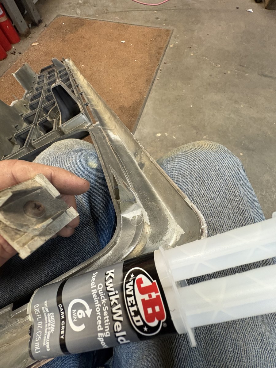

Of course, someone did not know to remove blinker lenses to replace head lights. I see so many different brands say they are the strongest glue. I’m giving this two parts epoxy a chance.
