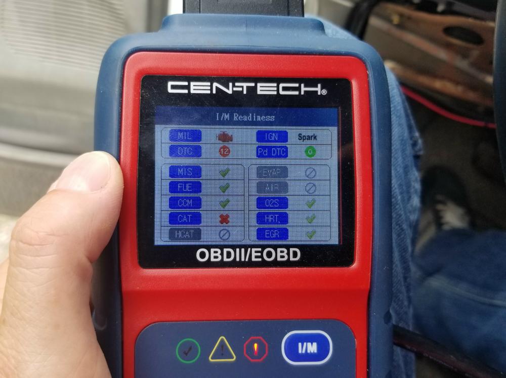

The Problem:
Since I towed the Ranger back to Texas with the battery disconnected, the Ranger is not test ready.
31800
Everything shows ready but the CAT.
Since I can't get the Ranger inspected, I got a Texas title and a 30-day tag. It appears that I need to drive the Ranger for a while to get it ready for testing. I've driven it a few times, and then today I drove it on the highway 14-miles each way to a Dairy Queen keeping it above 55-MPH, and the damn thing still isn't showing ready. WTF!?

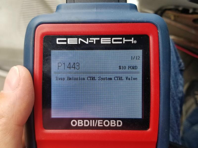

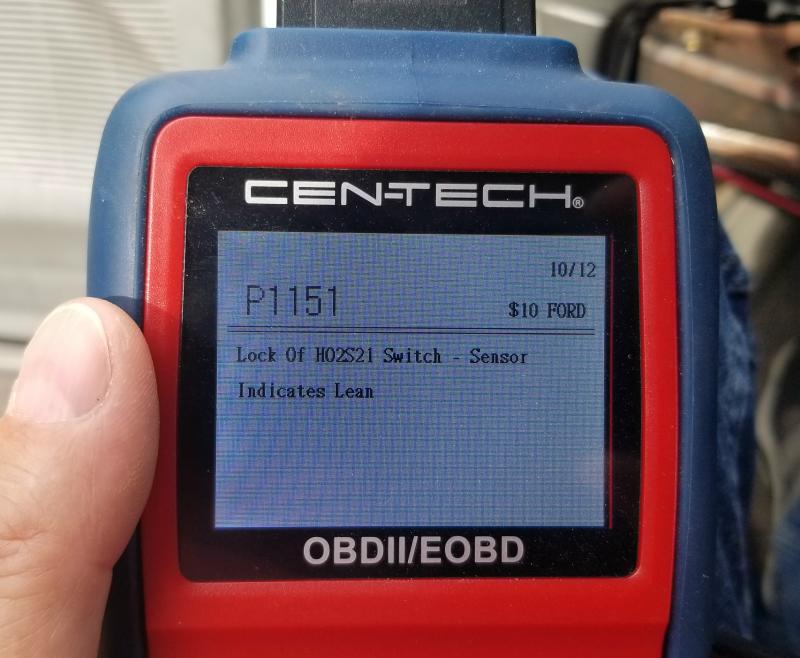

The other thing is that this is showing me (12) codes:
My 1996 Ford Ranger 4x4 (TRS-2) Re-Build
Code 1: P1443 EVAP Emission CTRL System CTRL Valve

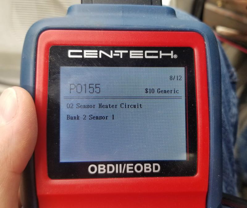

Code 2: P0155 O2 Sensor Heater Circuit Bank 2 Sensor 1

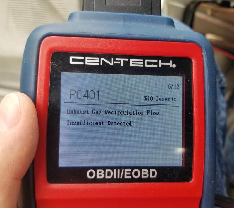

Code 3: P0401 Exhaust Gas Recirculation Flow - Insufficient Detected
Code 4: P1443 EVAP Emission CTRL System CTRL Valve

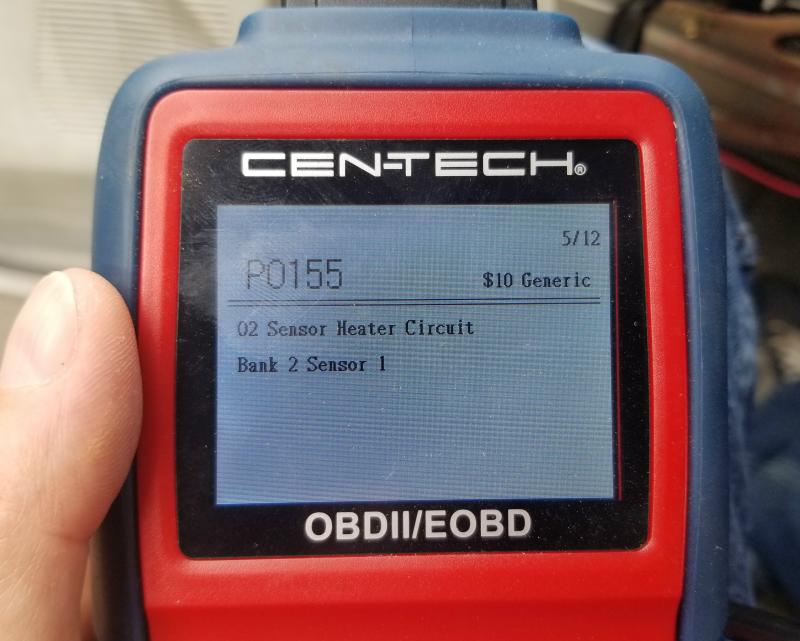

Code 5: P0155 O2 Sensor Heater Circuit Bank 2 Sensor 1
Code 6: P0401 Exhaust Gas Recirculation Flow Insufficient Detected
Code 7: P1443 Evap Emission CTRL system CTRL Valve
Code 8: P0155 O2 Sensor Heater Circuit Bank 2 Sensor 1
Code 9: P0401 Exhaust Gas Recirculation Flow Insufficient Detected

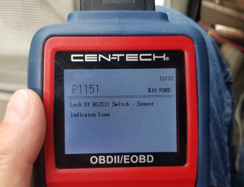

Code 10: P1151 Lock of HO2S21 Switch - Sensor Indicates Lean
Code 11: P1151 Lock of HO2S21 Switch - Sensor Indicates Lean
Code 12: P1151 Lock Of HO2S21 Switch - Sensor Indicates Lean
:dntknw:
I need to figure out how to get CAT ready, get rid of these codes, and get this damn thing inspected.

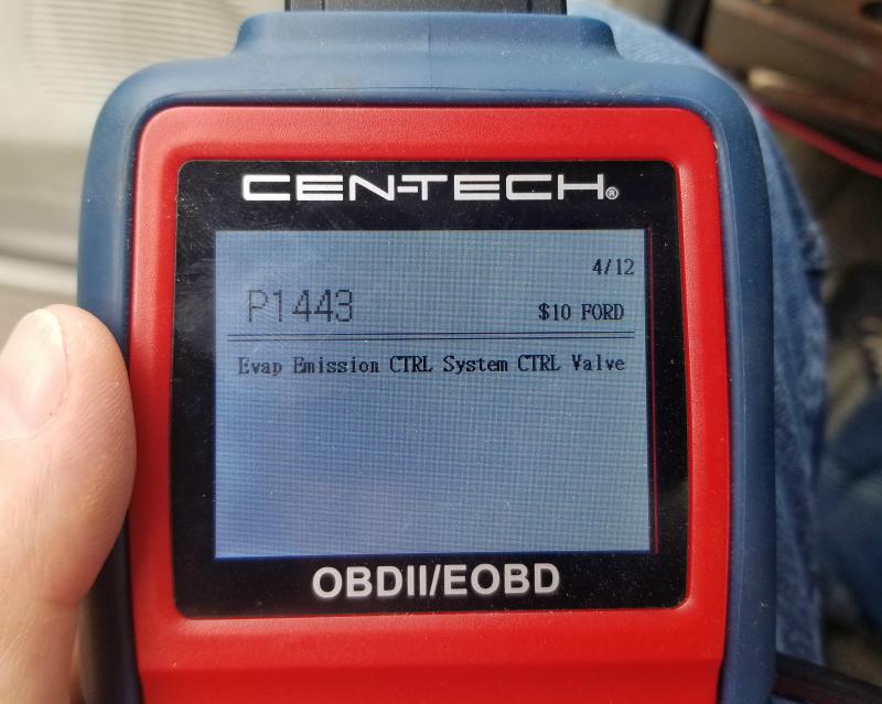

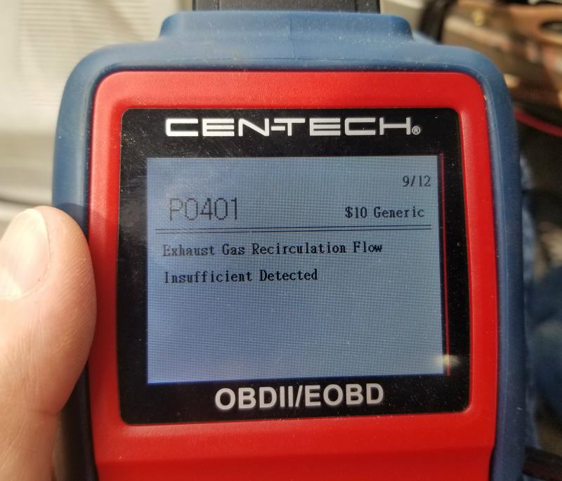

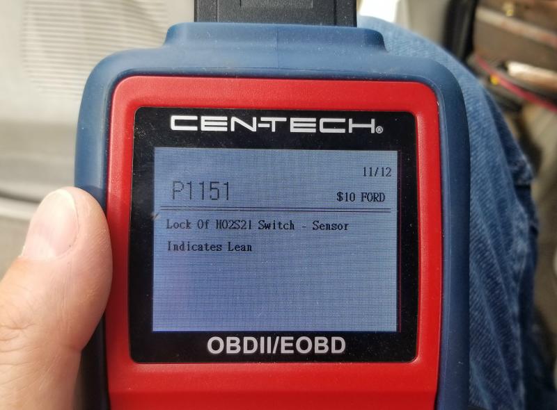

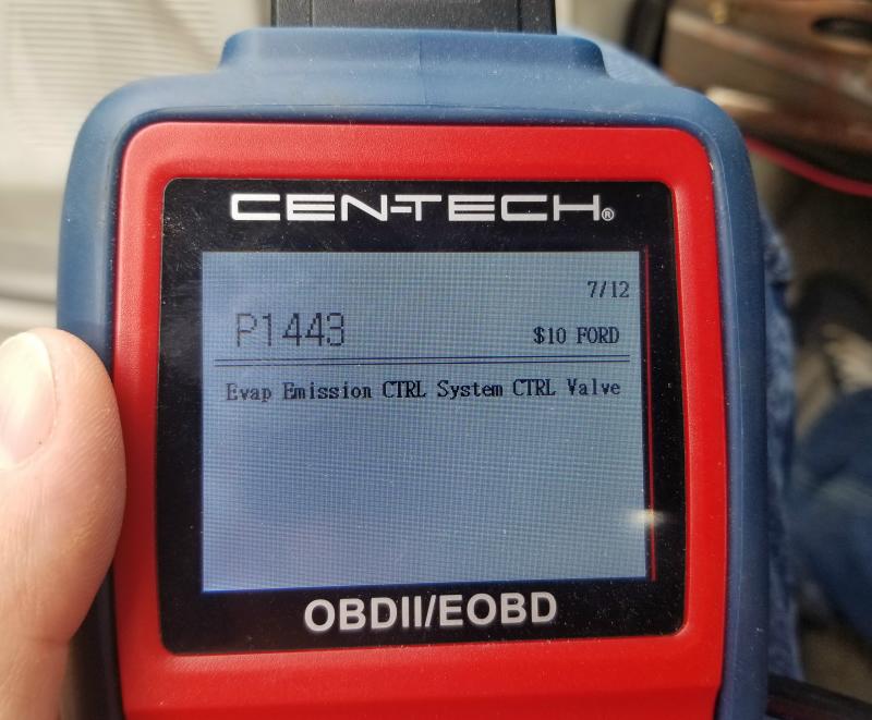

P1443
I read that "The P1443 in 99% of all cases is set due to a bad purge flow sensor (P0401 below) and replacing it will most likely clear this code"​

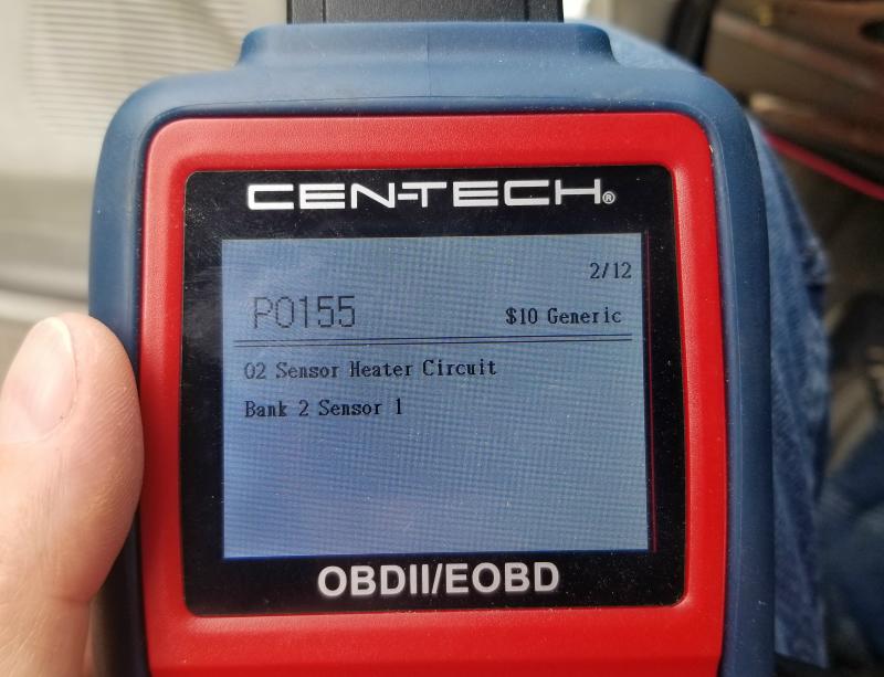

What are the common causes of code P0155 ?​
- Problem on the ground side of the O2 sensor heater circuit​
- Problem on the power side of the O2 sensor heater circuit​
- O2 sensor heater element has high resistance​
- O2 sensor heater element has an open circuit​

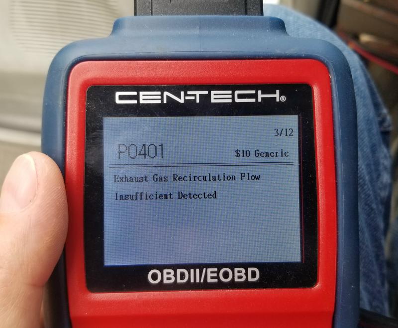

What could cause the code P0401​
- clogged or restricted EGR passages​
- faulty EGR valve​
- EGR valve stuck closed​
- problems with the DPFE sensor (Ford)​
- problems with hoses to the DPFE sensor (Ford)​
- problem with the EGR vacuum switching valve (Toyota)​
- clogged catalytic converter​
- carboned up EGR temperature sensor​
- vacuum supply issues at the vacuum-operated EGR valve​
- electrical problems with the EGR valve control circuit​
- engine computer problems​
P1151 FORD Possible Causes​
- Faulty Upstream Oxygen Sensor Bank 2 (P0155 above?)​
- Fuel pressure high or low​
- MAF sensor dirty/defective​
- Vacuum leak on engine​
- Leaking fuel injector or fuel pressure regulator​
- Faulty Powertrain Control Module (PCM)​
How is the switching rate.
Switching rate?

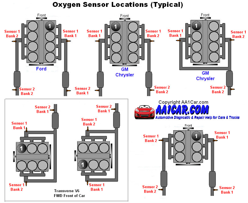

Correction:
P0155
I believe Bank 1 would be the side of the engine that cylinder 1 is on, which is the passenger side. So I think Bank 2 is actually on the drivers side. I initially said I thought it was the passenger side sensor.
32021
I would have guessed it the other way.
Seems to me almost all of those codes could be traced back to some kind of vacuum leak at the intake
