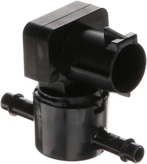

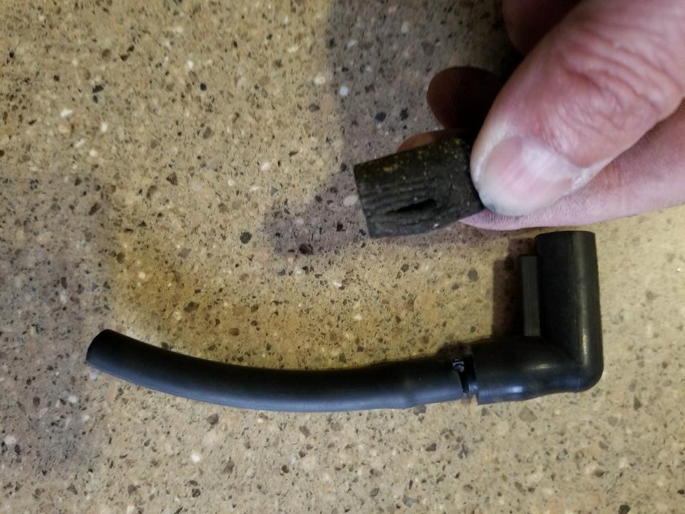

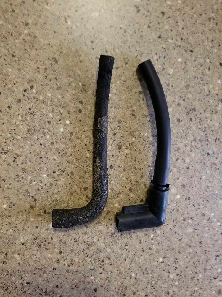

After getting the P1443 Evap Emission CTRL System CTRL Valve code again, I decided to replace the Canister Purge Solenoid. This is in a hose connected to the charcoal canister.
I also replaced the hose that attaches to the vacuum canister because it was cracking at the end. This hose is 3/8" on one end, and 1/4" at the other.
I used a 3/8" vacuum 90 degree elbow, and some 1/4" vacuum hose, and attached the two together with a 1/4" - 3/8" plastic connector.

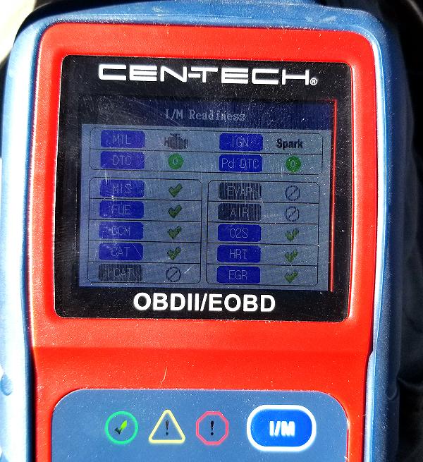

Ford Ranger Driving Cycle:
I've had problems getting the CAT to show that it's ready to test, so I tried a different Ford Driving Cycle that I found online that worked for the Ford Ranger:
http://www.obd2.com/support/reprog/downloads/ford/ford-imset_procedure.pdf
For all other Ford Vehicles
Pre-Conditioning Requirements:
· Cold soak the vehicle for 8 hours
· No DTCs present
· Fuel fill between 15% & 85 %
Driving Procedure
1) Start the vehicle and idle for four (4) minutes.
2) Idle the vehicle in drive for 40 seconds (neutral for M/T).
3) Accelerate to 45 mph, using ¼ to ½ throttle (M/T stay in second gear for at least 5 seconds). Accelerate for at least 10 seconds and shift through to 5th gear.
4) Drive with a steady throttle at 45 mph for 30 seconds.
5) Stop the vehicle and idle in drive or neutral for 40 seconds.
6) Drive at speeds between 25 and 45 mph for 15 minutes.
Use 1/4 to 1/2 throttle accelerations. Include the following conditions:​
· At least 5 stops with ten seconds of idle time.​
· At least 3 steady speed sections of 1 ½ minutes duration.​
7) Drive the vehicle between 45 and 60 mph for 8 minutes (use high gear).
8) Maintain a steady speed between 45 and 60 mph for 5 minutes.
9) Drive the vehicle between 45 and 60 mph for 8 minutes (use high gear).
10) Stop vehicle, idle for 40 seconds.
Believe it or not, this actually worked. After doing this drive cycle I pulled over, scanned the truck, and saw that it was now inspection ready.
32327
Passed Inspection!
Seeing that the truck was ready for inspection, I drove to my closest inspection station, got the truck inspected, and got my inspection report so I can finally get license plates. This all happened on Friday, and the temporary plate on the truck expired today. :yahoo:

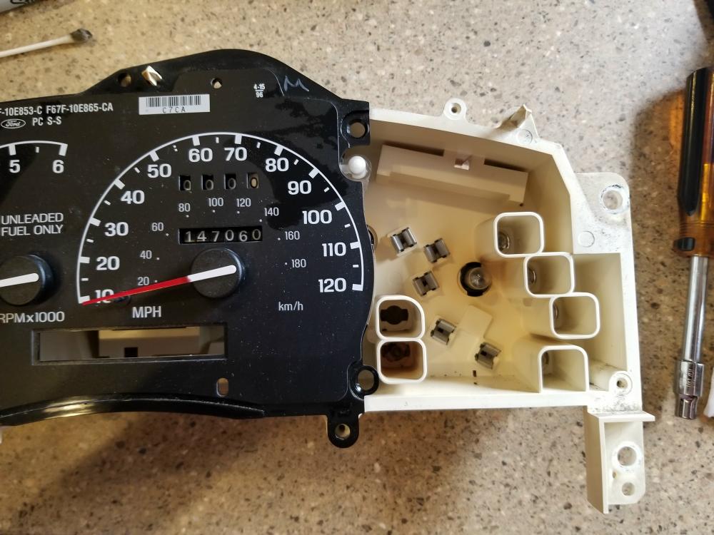

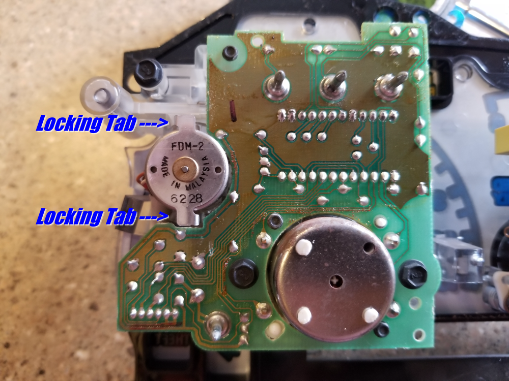

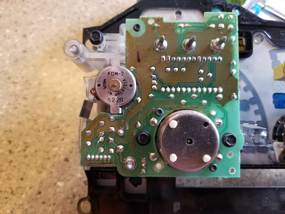

When I got the Ranger back, I discovered that the odometer was no longer working. I also discovered that the Check Engine light was burned out. I decided to remove the gauge cluster so I could repair these issues, and upgrade the (6) main lights that illuminate the gauges with LED lights.

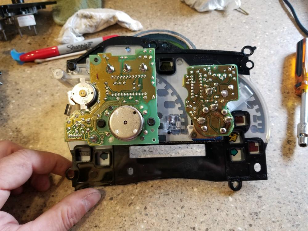

The gauges are in (3) sections. The speedometer and tech is in the middle, and then the gauges on each side overlap the middle cluster. This means you have to remove the side clusters to get the middle section out, and get to the motor that turns the odometer.

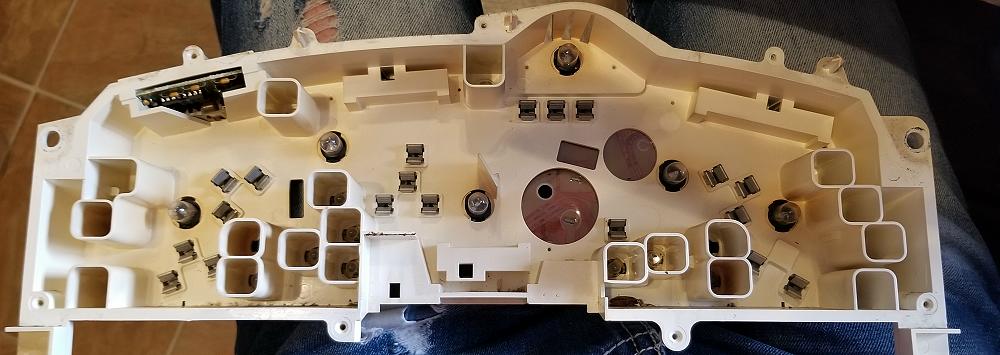

See the metal clips in the pic below where the cluster has been removed? Your gauges have long metal pins that slide in to those. When you start lifting the gauges straight up (gently), they'll be releasing from these clips.

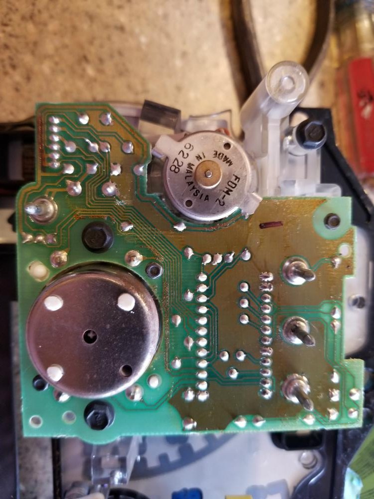

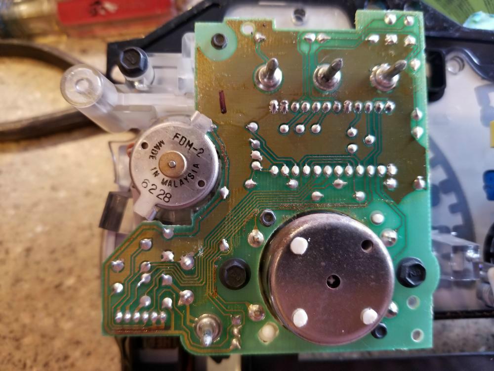

Here's the back side of the speedomter and tachometer cluster.
This electric motor turns your odometer. It's held in place by (2) locking tabs.
Turn the motor clockwise to get unlock it, and then lift it out.

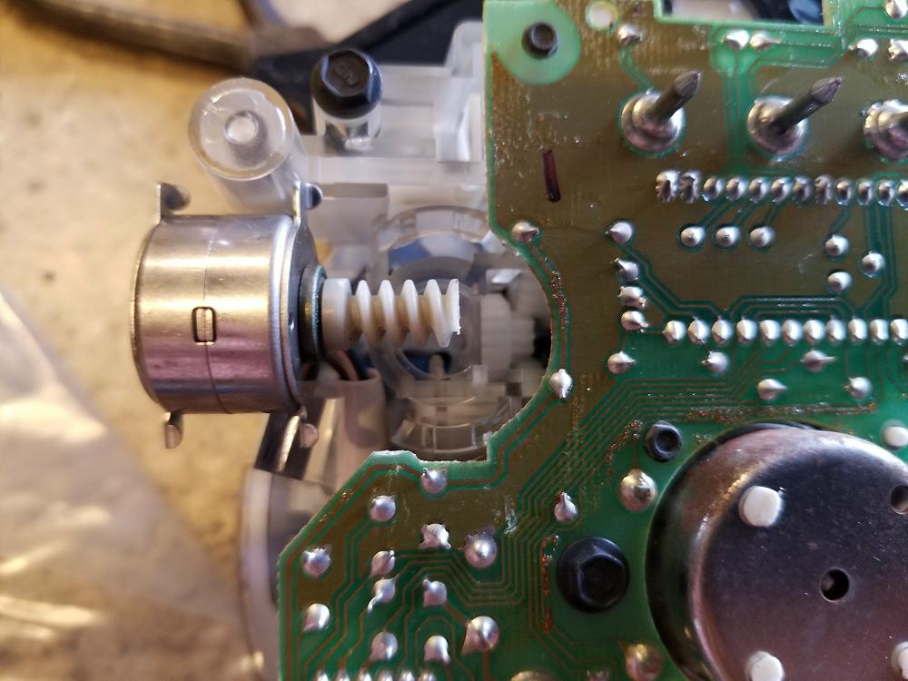

32335

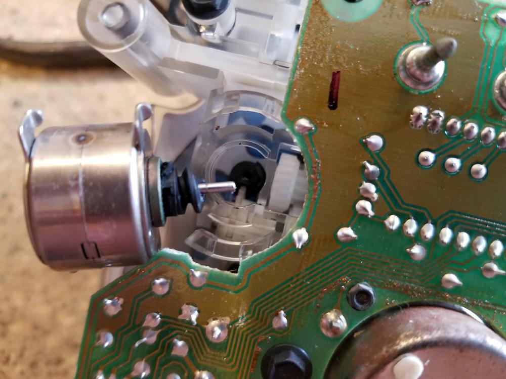

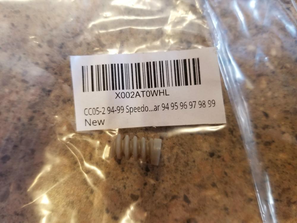

Here you can see the broken gear. This gear was so bad that it was crumbling in my fingers as I tried to remove what was left of it.
Here's the new odometer motor gear that I ordered from Amazon.
The new gear is installed on the motor and ready to go back in to the cluster.
All done.
32336
This was an easy fix, and only cost $10.00.

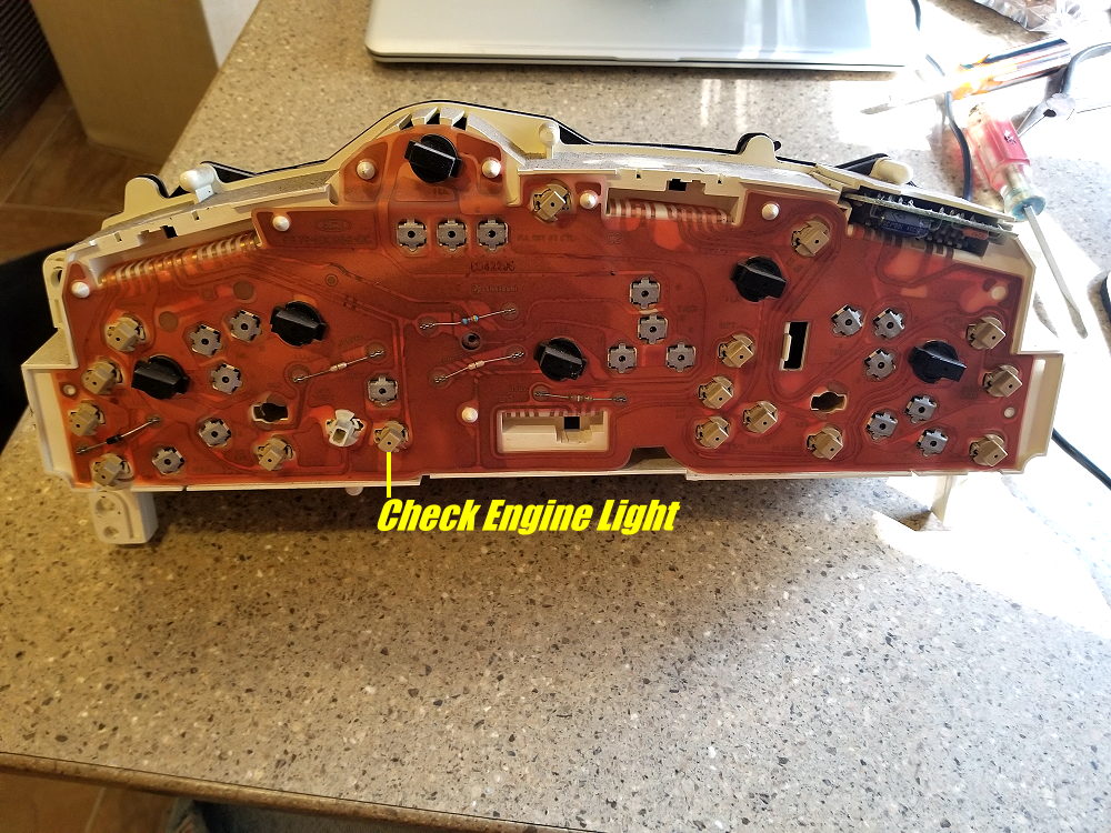

Check Engine Light & Gauge Lighting (Bulbs):
I needed to replace my burned out check engine light before I got the truck inspected.
The large black knobs are the light holders for the #194 bulbs that light up the gauges. The light brown holders are for the 'idiot lights' (check engine, etc).
32337
I labelled the socket for the check engine light. These tiny instrument lights (check engine light) take a #74 bulb.
32339
Here you can see the placement of the bulbs. Since I took the gauges out to fix the odometer gear, I just replaced the bulbs from this side.
32338

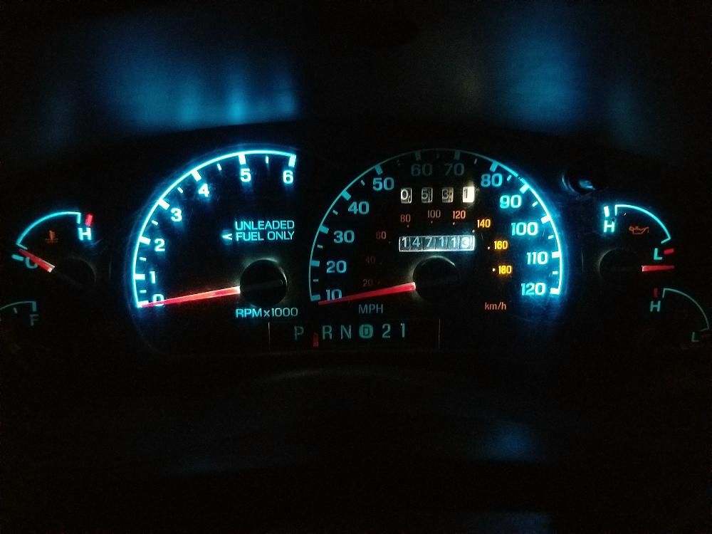

I replaced the (6) #194 gauge lights with Sylvania Cool White #194 LED light bulbs. You should be able to find this packaged with (2) bulbs at your local parts store.
32341
The package says that these also fits #168 bulbs.
A normal 168 bulb is 4.9 watts, and a 194 bulb is 3.8 watts. Both are the exact same size. When I looked at the LED's, they're both listed at 5-watts.
Some people will complain that they're not going to pay $7-$8 for a bulb. Yes, you can get cheaper LED's from Amazon, but I have found that those cheap LED's can start to flicker or burn out after a year. I chose to go with a brand name bulb to avoid having to pull my gauge cluster back out in a year or two.

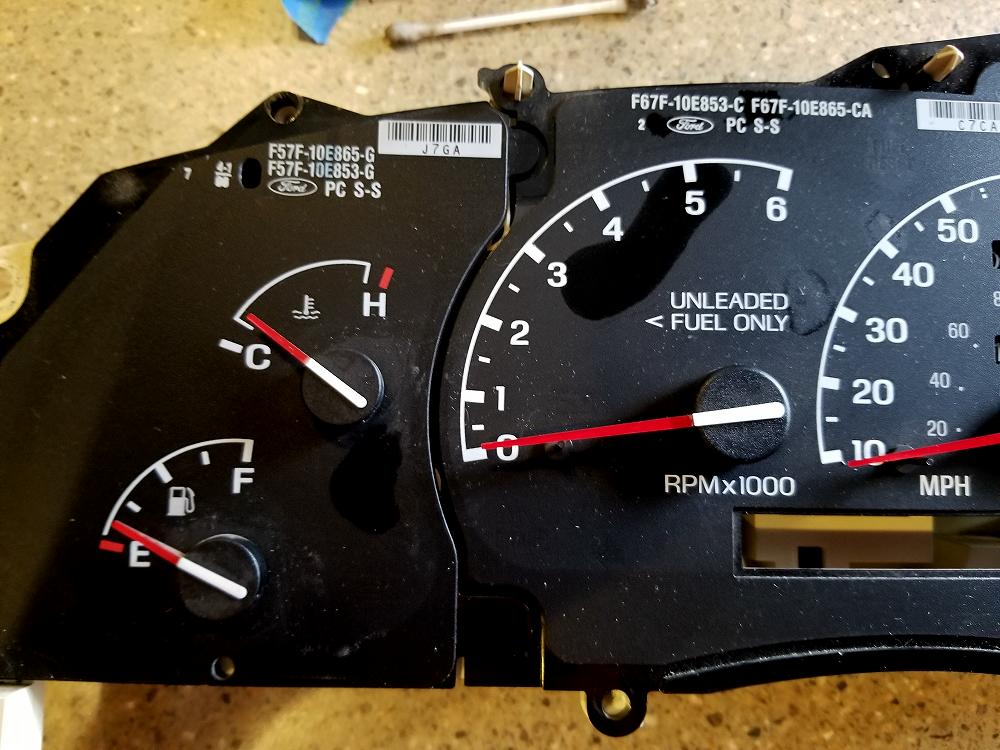

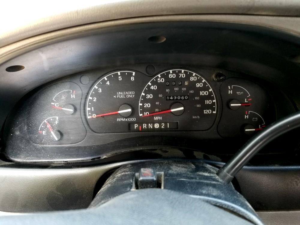

Red Gauge Needles:
Since I had the gauge cluster out to fix the Check Engine Light and odometer gear, I decided to clean it up and give it some red needles.
32360
Here's the boring stock gauges.
32361

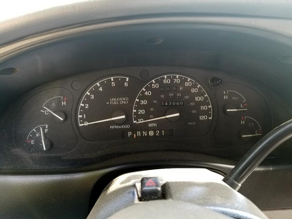

And here's the gauges after I made the needles red.

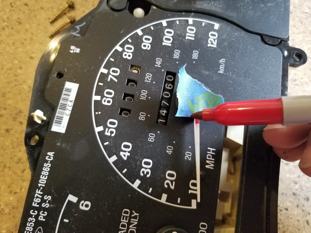

To do this, I simply used a red Sharpie (permanent marker), and coated the top of the needles. I used some tape to mask off the areas I didn't want the red marker to get on. I did not do the sides, only the tops.
32362
32363
The surface was pretty dusty, so I wiped them off with a wet cloth. I didn't use any cleaner, just water and a cloth.
Here they are lit up, along with the new 194 LED bulbs.
It looks like I should have used more marker. I'd suggest that anyone doing this apply several coats, and allow some drying time in between. I'll touch them up later when I redo the interior. Still, it's a neat mod that only costs the price of a permanent marker.
