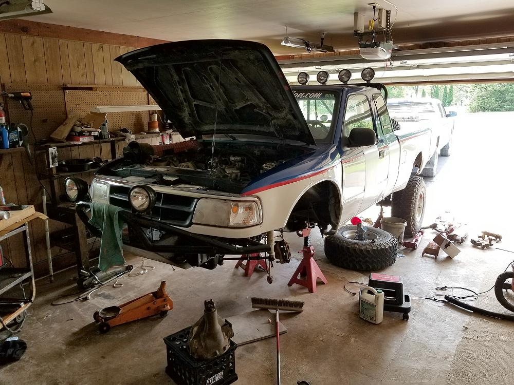

Once I got to Bobby's, the first thing to do was to access the condition of the Ranger, and determine what would need done, and what parts would need to be ordered.

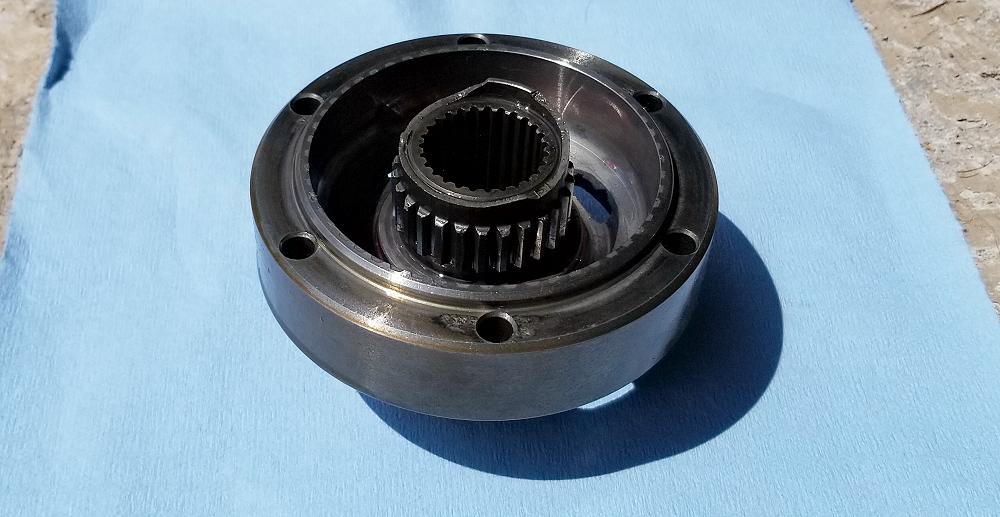

The front Detroit Locker wasn't unlocking, and taking it apart revealed a busted side gear. I contacted the manufacture to see if the side gear could be ordered, and got a part number (EATON PART # 71116 / DETROIT SIDE GEAR 162C-56A). I actually ordered the part from West Coast Differentials. It cost me $90.00 plus $40.00 to have it shipped from Mexico.
31728
The guy from Eaton was nice enough to email me an exploded view of the Detroit Locker in my Dana 35 TTB that showed all of the part numbers.
The drivers side front fender was cracked, and there would be nothing I could do about that right now.

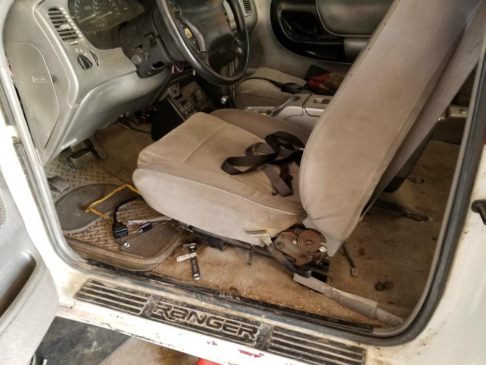

The interior was a dirty mess, and the teeth on the recline lever were stripped causing the back of the seat to recline if any weight was put against it.
Bobby had already taken the front suspension out, dismantled it, and removed and dismantled the front locker. The front beams and suspension components were sent out to get blasted.
At this point, I really wasn't sure what I had gotten myself into, and whether I had done the right thing buying the Ranger back. What made it worse was that I had no idea if the truck even ran, and couldn't drive it before we started working in it, so I just put my faith in Bobby when he assured me that it ran and drove.

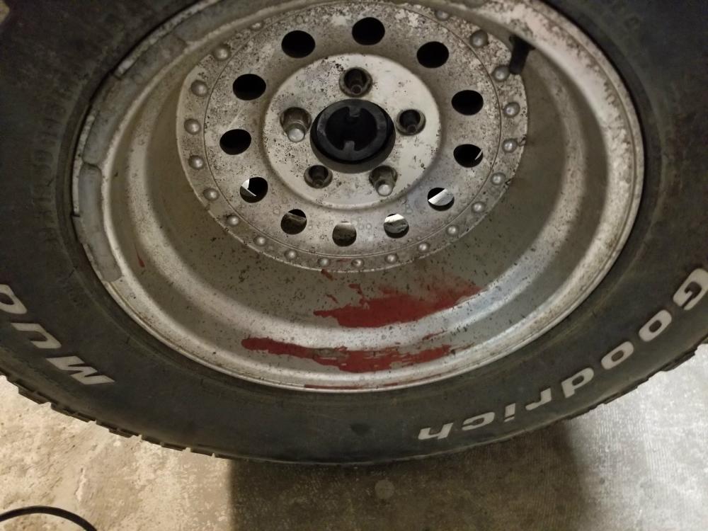

I already knew that the tires were dry rotted, and someone had splattered red paint all over this truck, including the wheels.

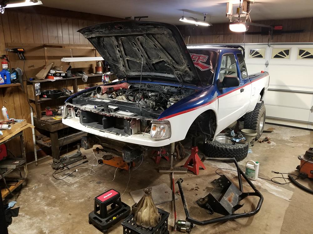

The headlights had mud in them, and the front bumper had some rust spots on it, so the front was disassembled.
31598

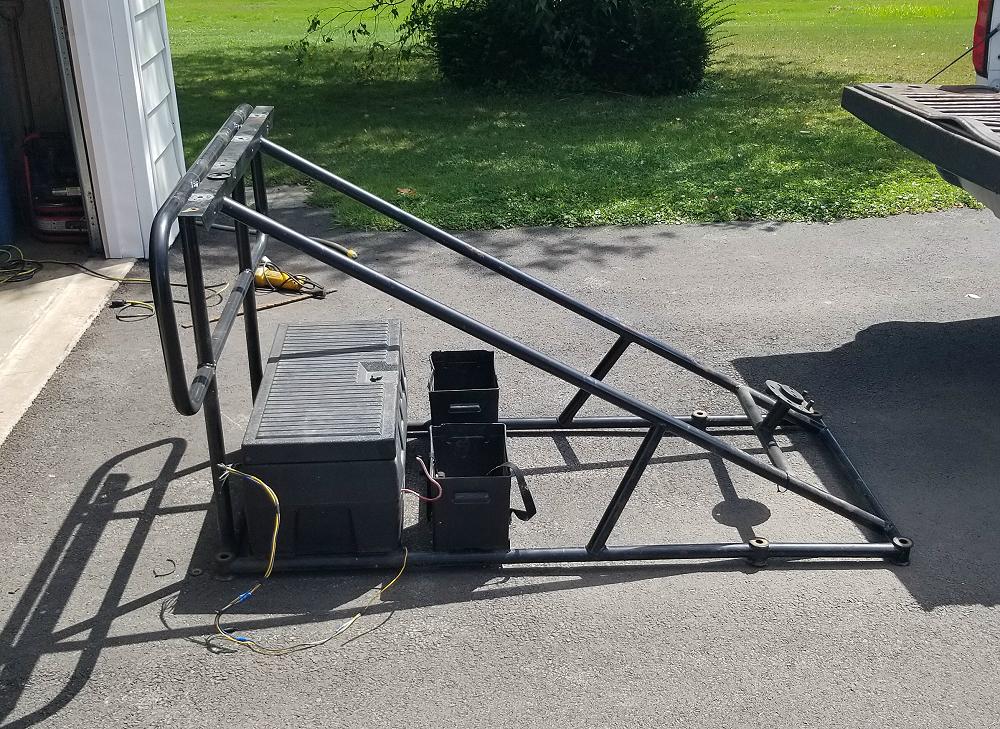

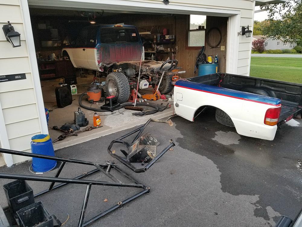

The bed cage was also removed so it could be stripped and repainted. All of the off-road lights were rusty, and their mounting bushings were trash, so they were all discarded. I would be putting the battery back in the engine compartment, so the dual battery boxes will get pitched as well.
31599

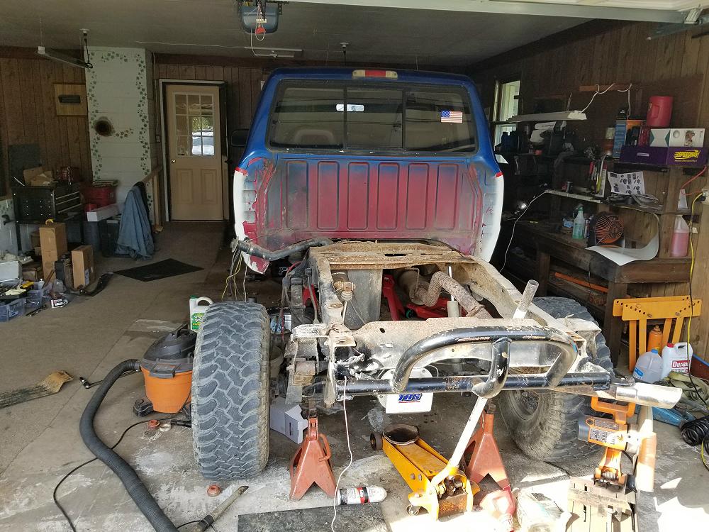

With the cage out, the bed was removed and set outside as well.
31600
Here you can see the 2019 'Loan Ranger' looking on.
31601
With the bed removed, you could see how much rust had developed on the frame since I had sold it.

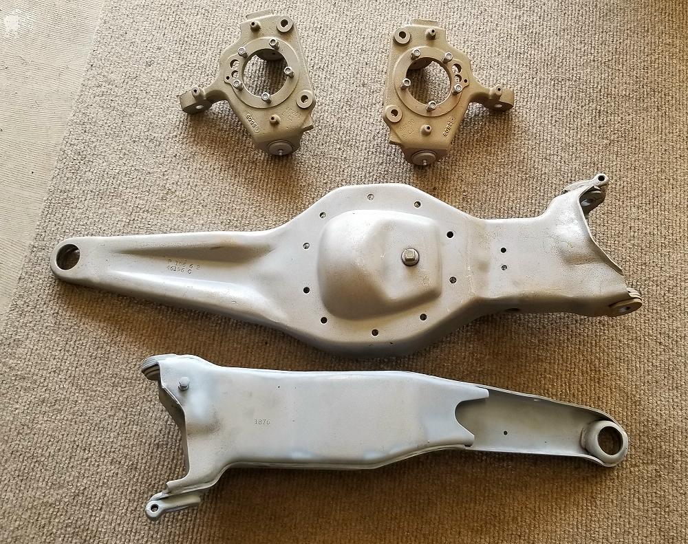

The Skyjacker suspension brackets and radius arms were inspected for cracks after being at the water blaster. Some of the welds on the ends of the transmission crossmember (tube in the bottom of the photo) were ground out and re-welded for better penetration. I found a few gaps between the welds and the mounting flange.
31623

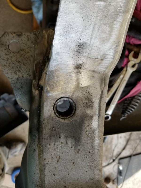

The Dana 35 TTB and steering knuckles were blasted as well. We knew there was a crack in the drivers beam near the bolt hole for the radius arm.
31624
Bobby fired up the welder, welded up the crack, and smoothed it out with a flapper wheel.

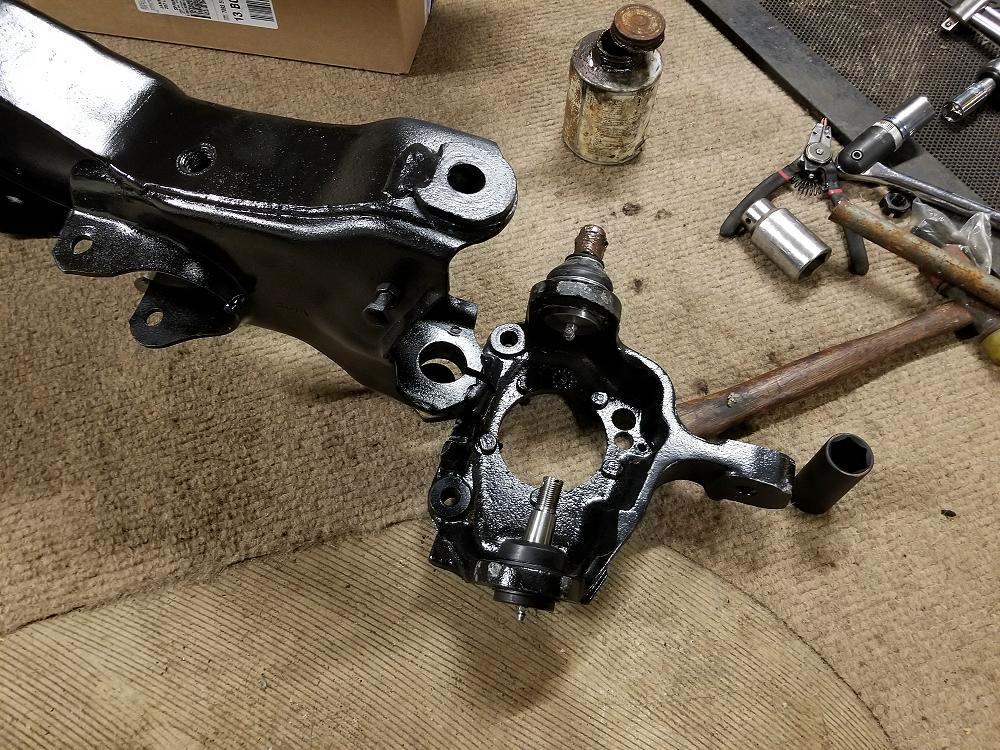

All of the blasted components were primered and painted black, and then new balljoints were installed in the steering knuckles.
31626
The Dana 35 axle beams also received some new Moog K8292 Axle Pivot Bushings.

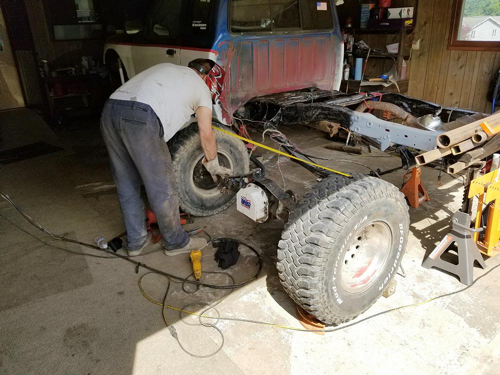

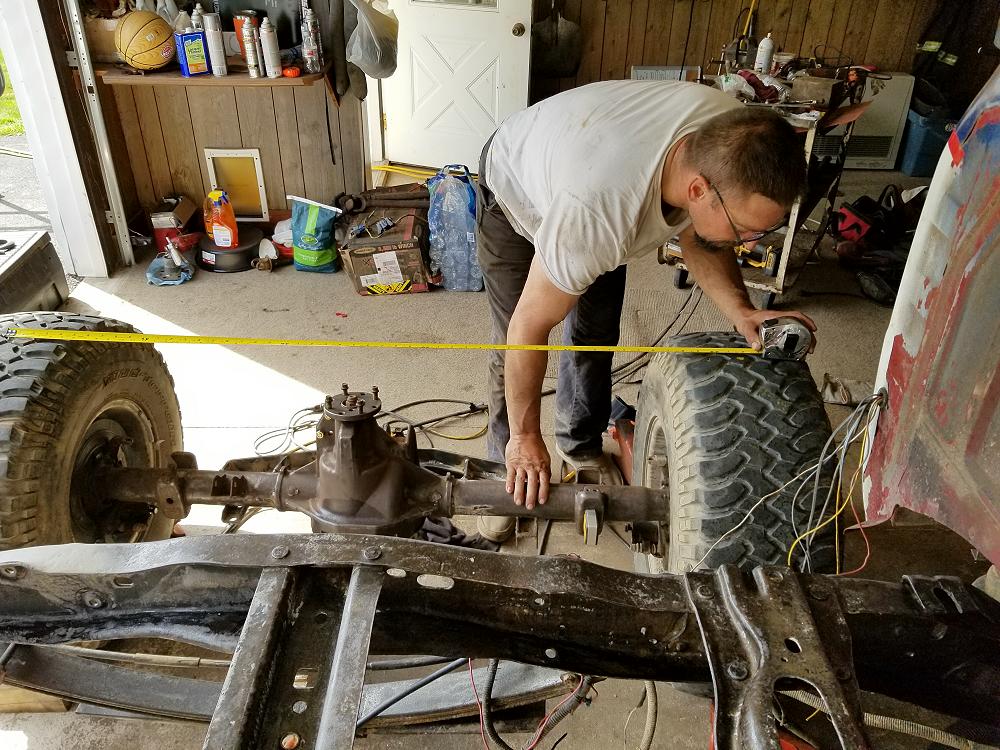

Bobby also welded the axle tubes to the axles center section.
Here, Bobby is turning the axle and reading the measurements. He would then run a bead of weld on the axle tube to heat it up, and draw the tube in the direction he needed it to go to get the axle straight. Once straightened, the weld bead was ground off.
31635
There had been some issue with the rear Detroit Locker unlocking, but it seemed to function better locking and unlocking after the axle was straightened out.

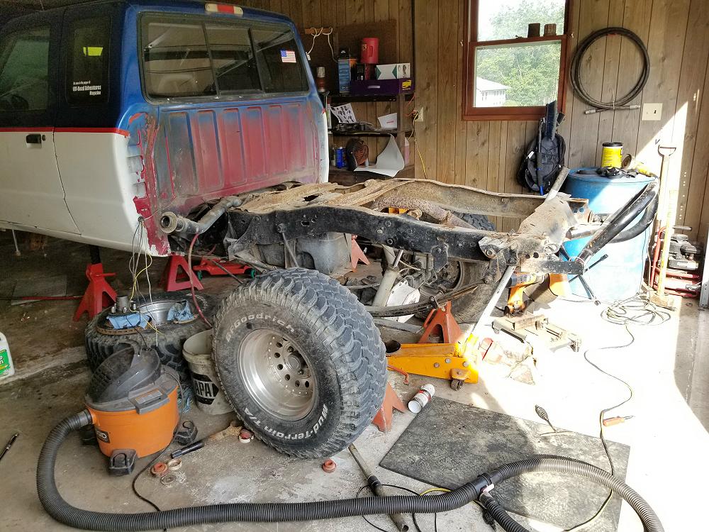

Time to get to work on the frame. Since it's all apart and accessible, I got out the grinder and a wire wheel and began cleaning it up. I think Bobby thought I was nuts.
31639

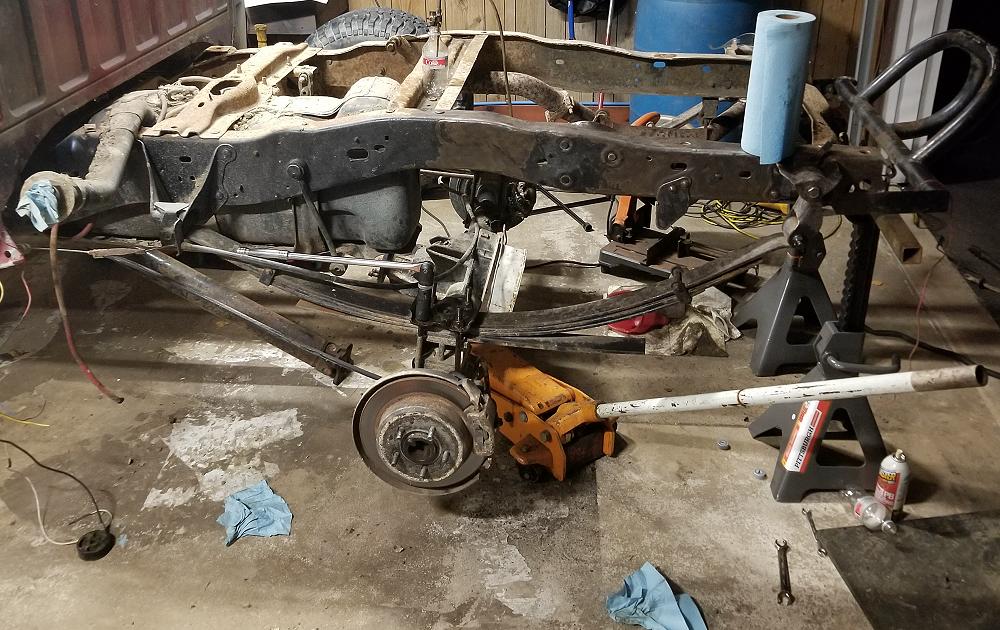

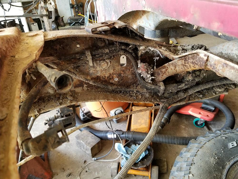

Ever wonder what the frame looks like behind the gas tank? I actually took this photo AFTER I cleaned most of the mud out that was packed in there. Looks like even a mouse had found a home in the Ranger.

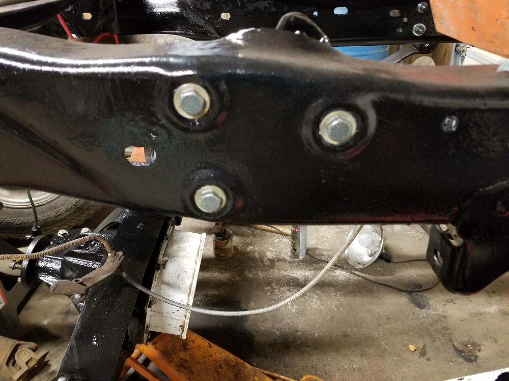

The brake line was looking pretty rusty, so the brake line from the rear axle to a spot around the middle front portion of the cab was eventually cut out and replaced (after this photo). The old line was flared where it was cut so it could be attached to the new line.

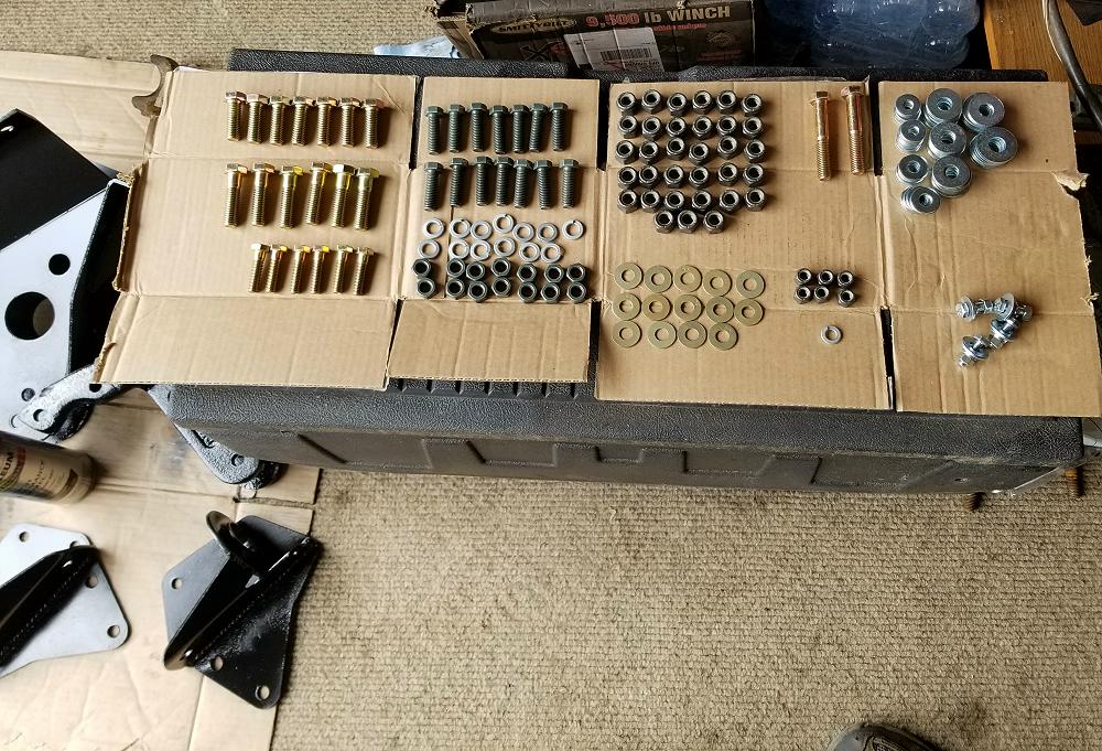

I made a list of all the hardware I was going to need to put the truck back together, and made a trip to the local Tractor Supply and hardware store. Here I have some of it organized and laid out so I can find what I need.

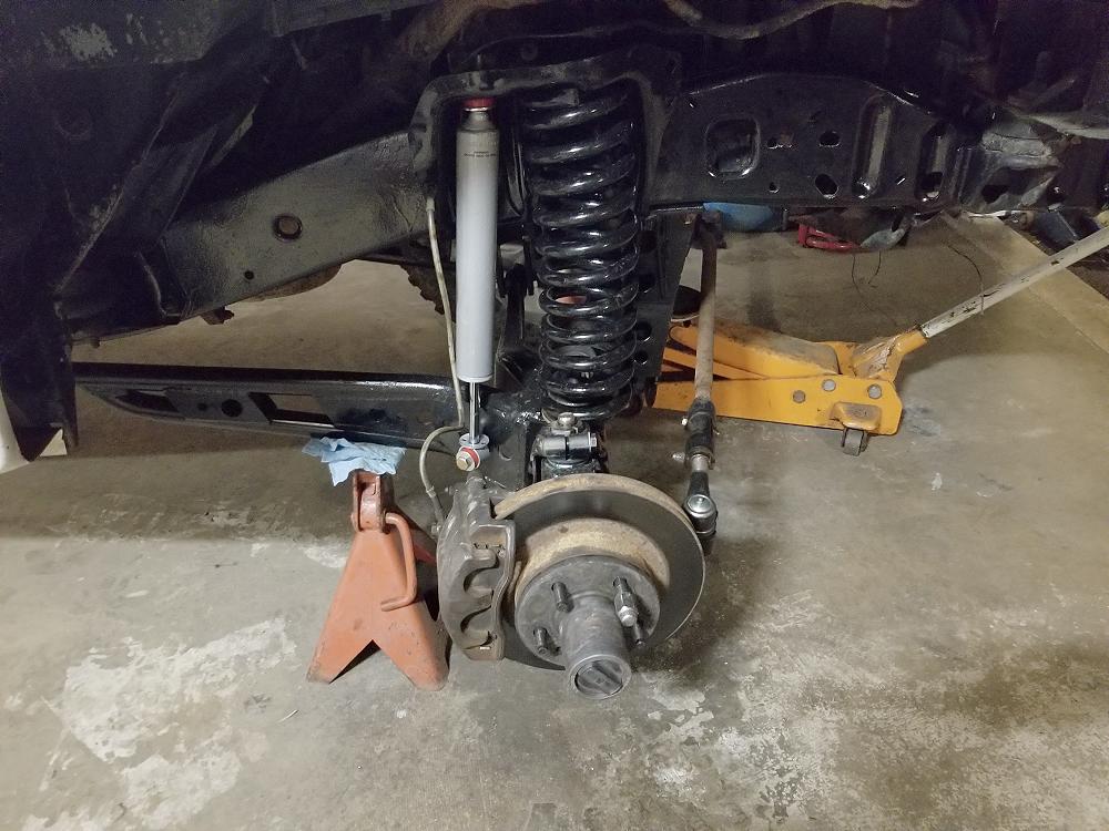

The front suspension and outer side of the frame rail has all been painted, and the front suspension is going in with new bushings and balljoints.
31682
The front locker was reinstalled in the carrier, which was reinstalled in the axle beam. The front locker was repaired with a new side gear, but was not 100%. One of the outer bearings had a broken race. Trying to replace the bearing revealed that the part it was mounted on was no longer round, and the new bearing wouldn't go on. I had no choice but to use the bearing with the broken race.
31683

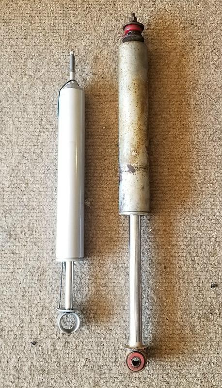

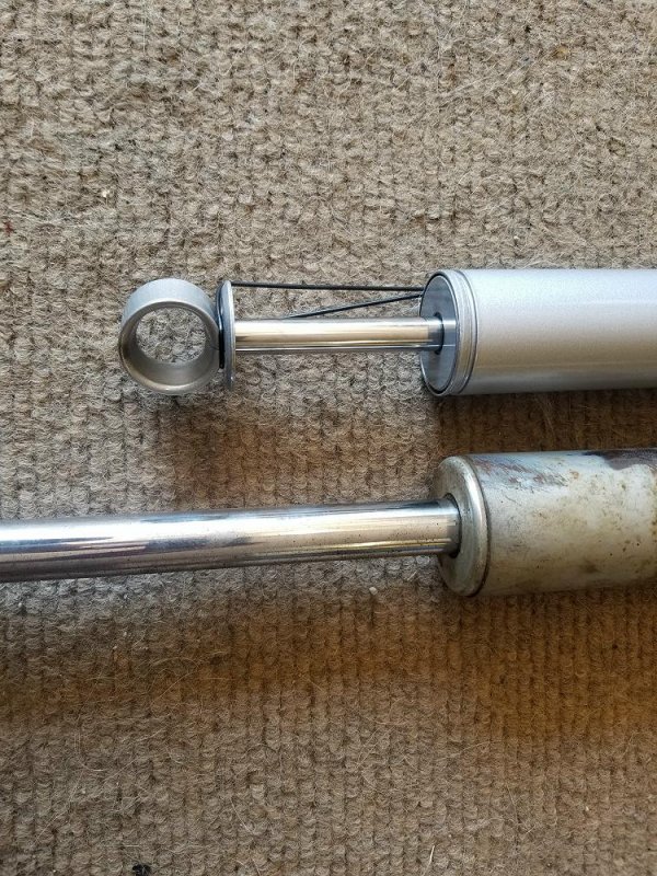

The Ranger received new Skyjacker M95 shocks (left) all the way around. Here you can see the Skyjacker Big Gas shock (right) they offered for a little while when the lift was first put on in 2004. Not sure why Skyjacker stopped offering this shock and switched to the M95, but someone suggested that the smaller piston allows for more fluid.

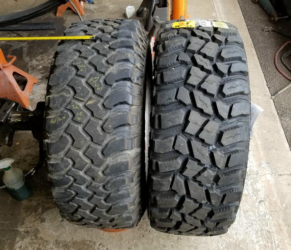

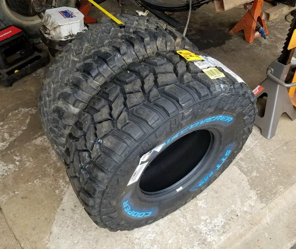

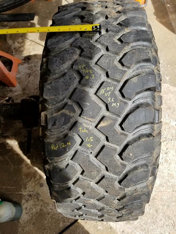

The 33x12.50x15 BFGoodrich Mud Terrains were dry rotted, and were replaced with 33x12.50x15 Cooper Discoverer STT PRO mud terrains. I actually purchased (5) of these through Amazon. Sounds crazy, but I had searched for them locally in PA, and discovered that I could get them from Amazon at a good price with free shipping. What really sealed the deal was that I could get them and pay for them for 6-months without being charged any interest! Check them out HERE. I'm an Amazon Prime member because I buy from them a lot, get free shipping and good deals as a member, plus I enjoy the Prime Video and Prime Music streaming at home. Not saying you should be a member, just that I got a free shipping and interest free offer as a member. You may not see the same offer or price that I see.

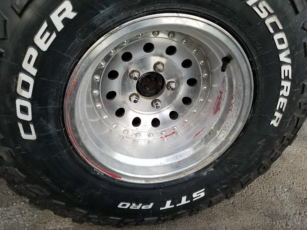

As mentioned before, the truck has spatters of red paint on it. I took a wire wheel on a drill to get the paint off the wheels. I knew it would mess up the finish, but their already screwed up. The good thing is that their aluminum. I can wet sand and polish them back to a shine. I got the paint off before the 20th Anniversary Trail Ride, but I didn't have enough time to get them polished up.

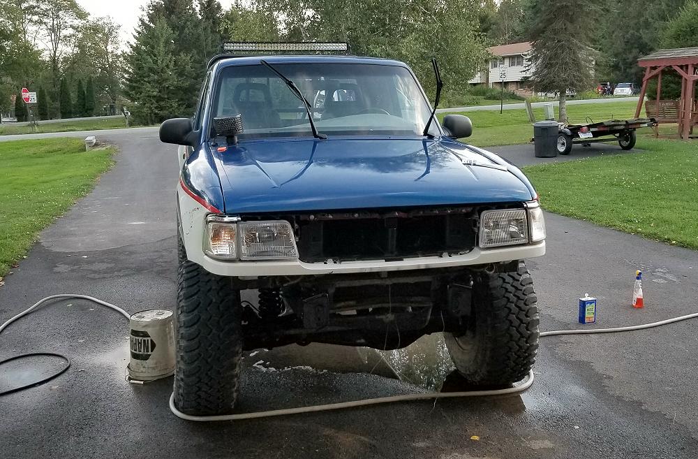

The bed and cage was installed, as well as the new 42-Inch LED lightbar to replace the rusty old 6-inch Pro Comp off-road lights. Here you can see where I have applied the black layer of vinyl for the TRS decal on the side of the bed. I used an application spray to keep it from sticking right away so I could position it. I'm waiting for it to dry and stick so I can pull the tape off. Then the red and blue sections will be hand laid over it to get the final look. I cut these on my vinyl cutter back in Texas, and took them with my to PA.
31689
Here you can see the finished result of the logo on the bed, as well as the paint removed from the wheel.

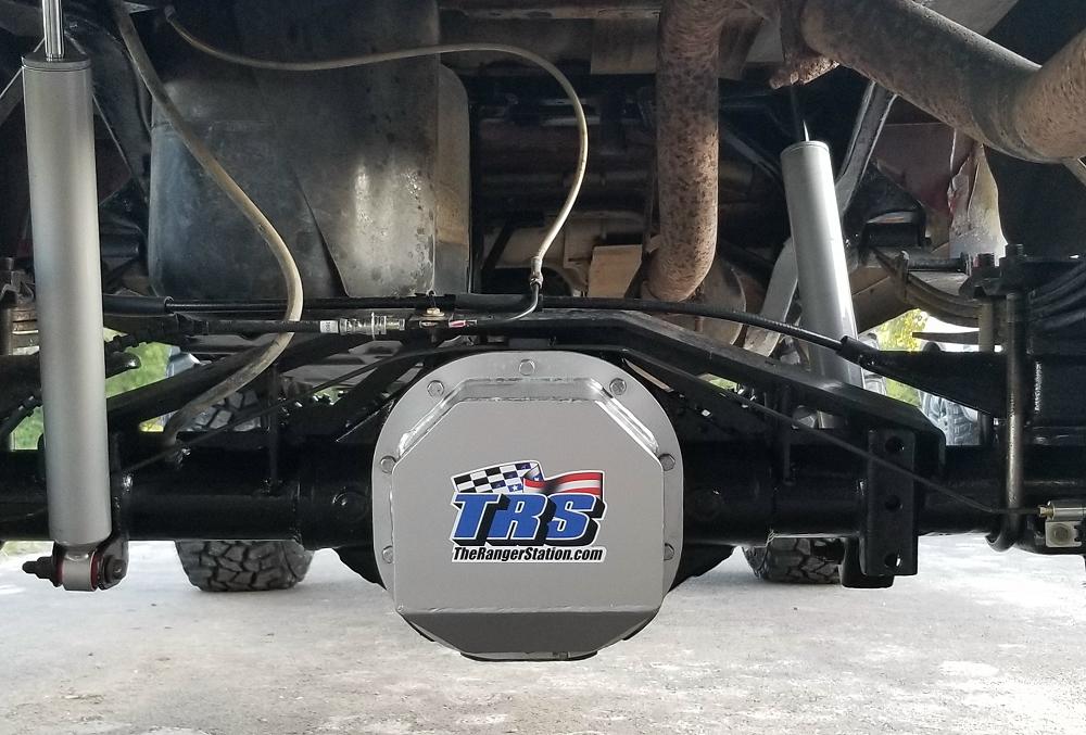

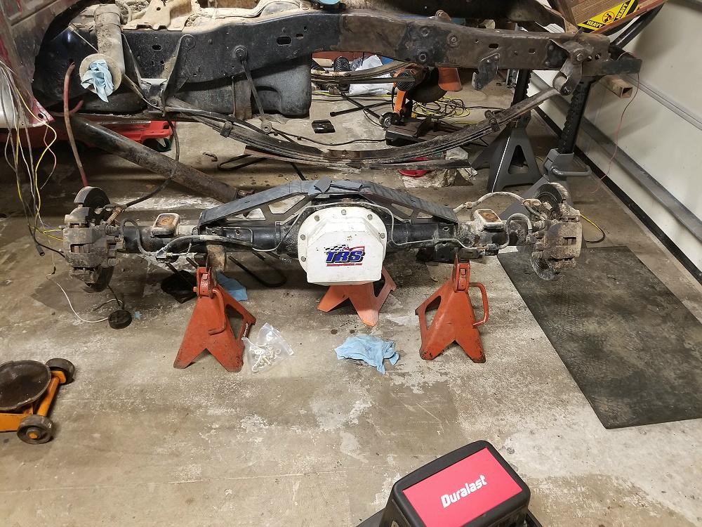

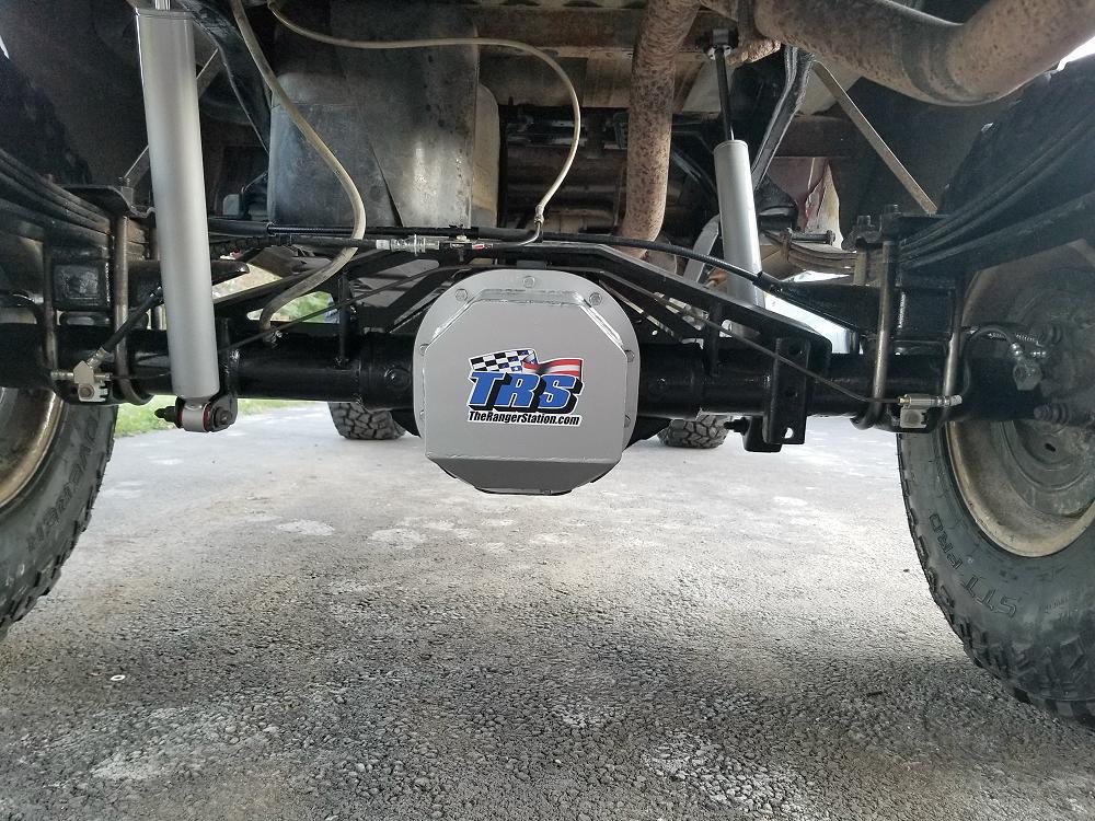

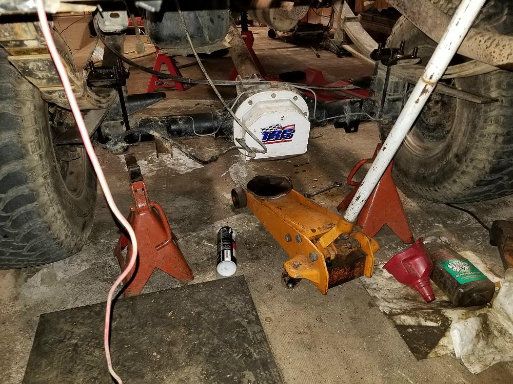

Here's a couple shots of the 8.8-inch rear with the Barnes 4WD axle truss, new brake lines, new parking brake cables, and the TRS diff cover repainted silver instead of white with a TRS decal. A lot of parts were bought from Amazon, but the parking brake cables and rear brake hoses came from Rock Auto. The hard line was purchased locally.
