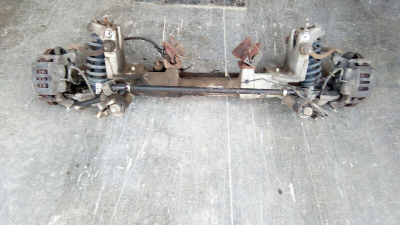

swap in a vic system. adapt it....buy big money brakes and 32 valve swap...
its been done.
you know you want to....
