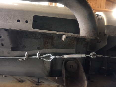

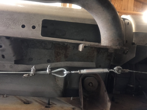

A turnbuckle!There is a simple work around for adjusting the parking brakes with the Mustang rear disk brake conversion.View attachment 116385
