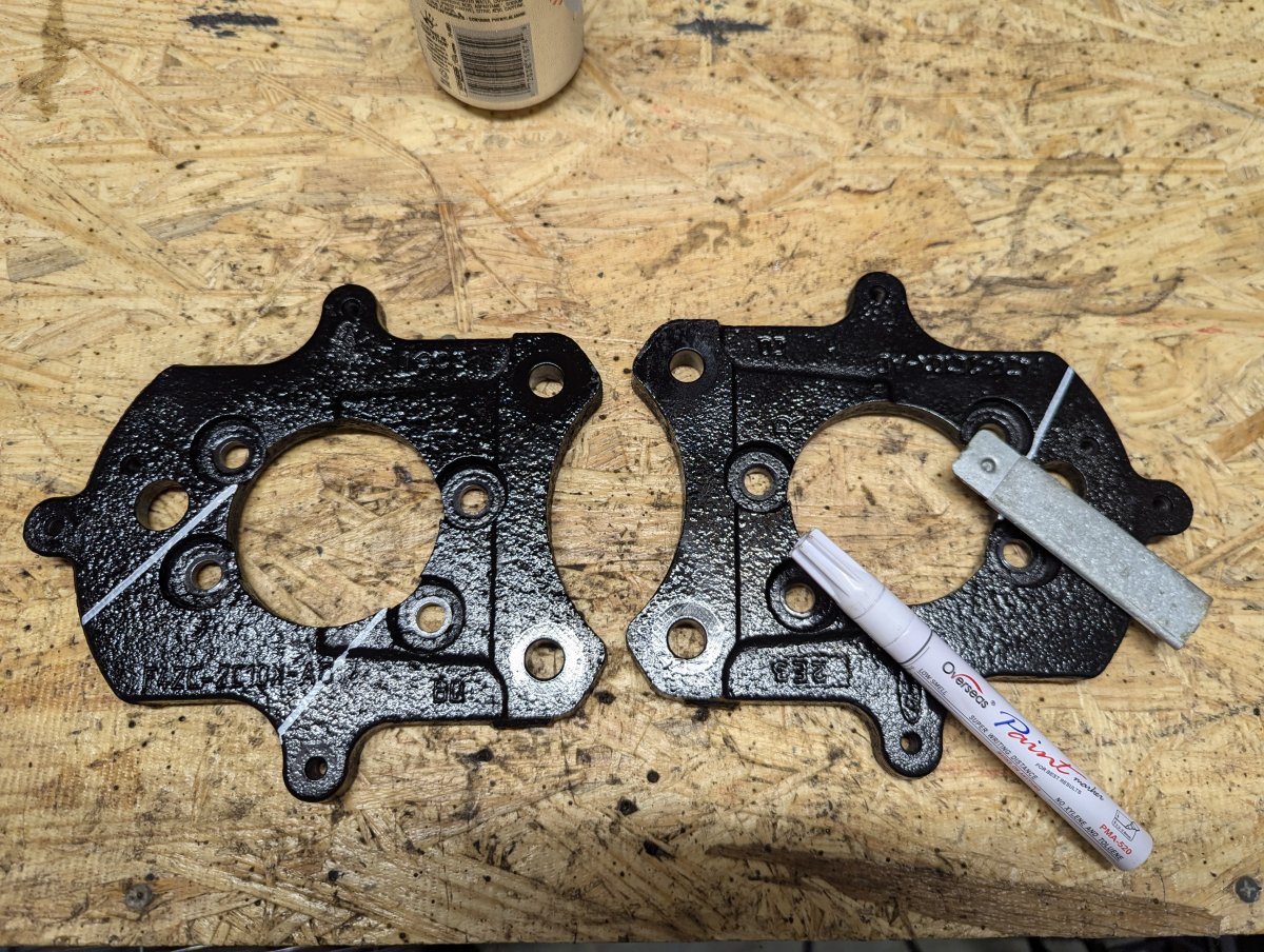

I'm marking up the caliper brackets to make the cut for the mustang rear disc brake swap. The left one is marked, the right bracket should be the opposite right? Like I have laid out here?
Mustang rear disc brake swap
That's what makes sense to me at least, but would like confirmation so I don't have to go digging for another in the junkyard again 😆
Thanks!
Just make sure when the caliper mounts up, the bleeder ends up at the top.
Yes, they need to mirror each other.

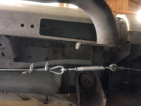

just back a while ago from a parts pulling paradise. did the mustang rear disc to '88 ranger about 6 years ago. thought it might be time to do the E brake. must have trashed the original E brake cables. found a series 3 long bed to scavenge. my calipers are the external E brake. as expected, the cables are too long. someone was going to send me pics of his copper pipe/tube cure but i never got them.
re: your pics. something doesn't look right to me in your set up lines. i think the part on the right should have lines following the marker and case cutter.

You're 100% correct. I originally drew the line wrong, why I ended up taking a pic and making sure here 😂.
