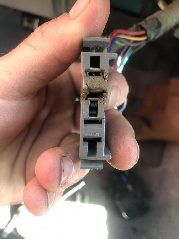

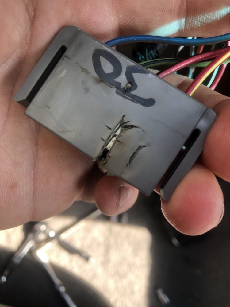

Ok so the other night Im headed home and i have a hard time seeing at night with my dim lights so I Went to use my Hi beams and I started to smell a really strong burning plastic type smell. I immediately turned off the lights and struggled home hoping not to get pulled over. well next day I got to look and find one of the connectors to the multi purpose switch lever is burnt out. It warped the connected and i have no idea what would even cause something like this to happen. Really need some help I work late a lot and can’t be driving without headlights is very unsafe. I know the lever burnt out and needs to be replaced but I don’t want to put a new part in for this to happen again. Please any suggestions or knowledge is very appreciate.

That usually happens due to a loose connection. Replacing it and making sure all the connecting tabs are clean is the best you can do. A little dielectric grease can keep moisture and humidity from corroding the connecting parts in the future.
The other thing would be to rewire the headlights on relays out in the engine bay. That reduces the current flowing through the headlight switch and multifunction switch. It also reduces voltage drop to the bulbs so they are a tiny bit brighter. But that's a bigger project.

A loose connection at the headlight bulb or at the connector to the multi purpose switch? I was able to get another multi purpose switch and can pick it up later but as for the connector that got messed I had to order it. Won’t be able to pick it up till tomorrow and I don’t want to plug in the new switch to that connector and have it burn out again. The wires on that connector are loose two of them can pull straight out of the connector without the need of a tool. The wires themselves are not burnt or messed up it’s just the plastic connector got hot somehow and yeah lol.
A loose connection right there where it's melted. Replacing the switch and the connector, as you seem to be planning is the best solution.
Once the connection gets loose, it heats up. That ruins the spring tension and the connection gets more loose, then hotter, etc.
