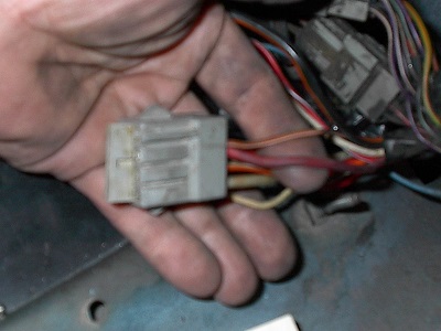

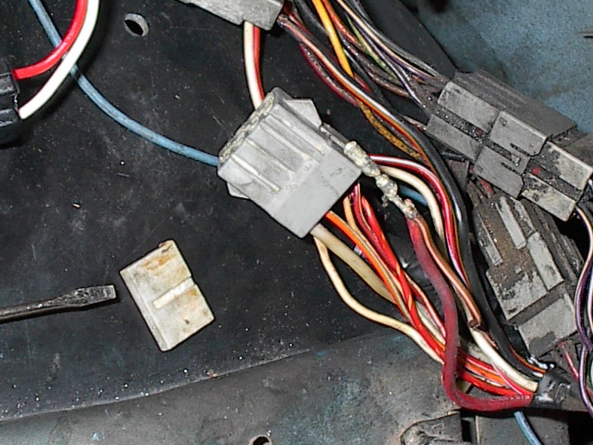

The two wires are "spliced" together at connector C102, on the cab side of the connector (the EVTM schematic shows this). Pics ain't great, but I looked and here's what I took when I did mine (back in 2009).
Red/Green and Brown/Pink going into the same connector cavity:
And here's the same two wires crimped to the same terminal after it was slipped out of the connector body:
Colors are usually hard to see on old wiring, and keep in mind, you're dealing with a truck, and wiring, that's going on 40 years old, so don't rule out that you that you may possibly have a wire or component issue that needs to be found, and addressed.

No, they need to stay connected together, so that the coil (or whatever you're running) has power in both the "run" and "start" ignition switch positions.
