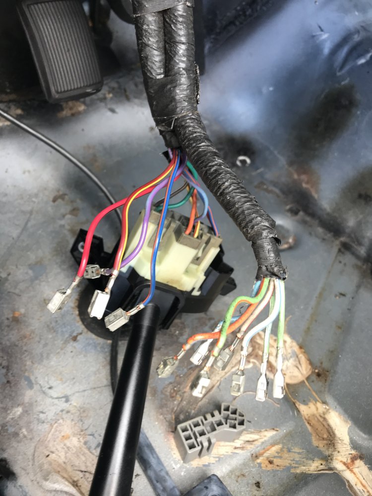

My multi function plug and a different 4 wire plug next to it fell apart. Can some one please post a pic of where my wires go back into on the plug(s).

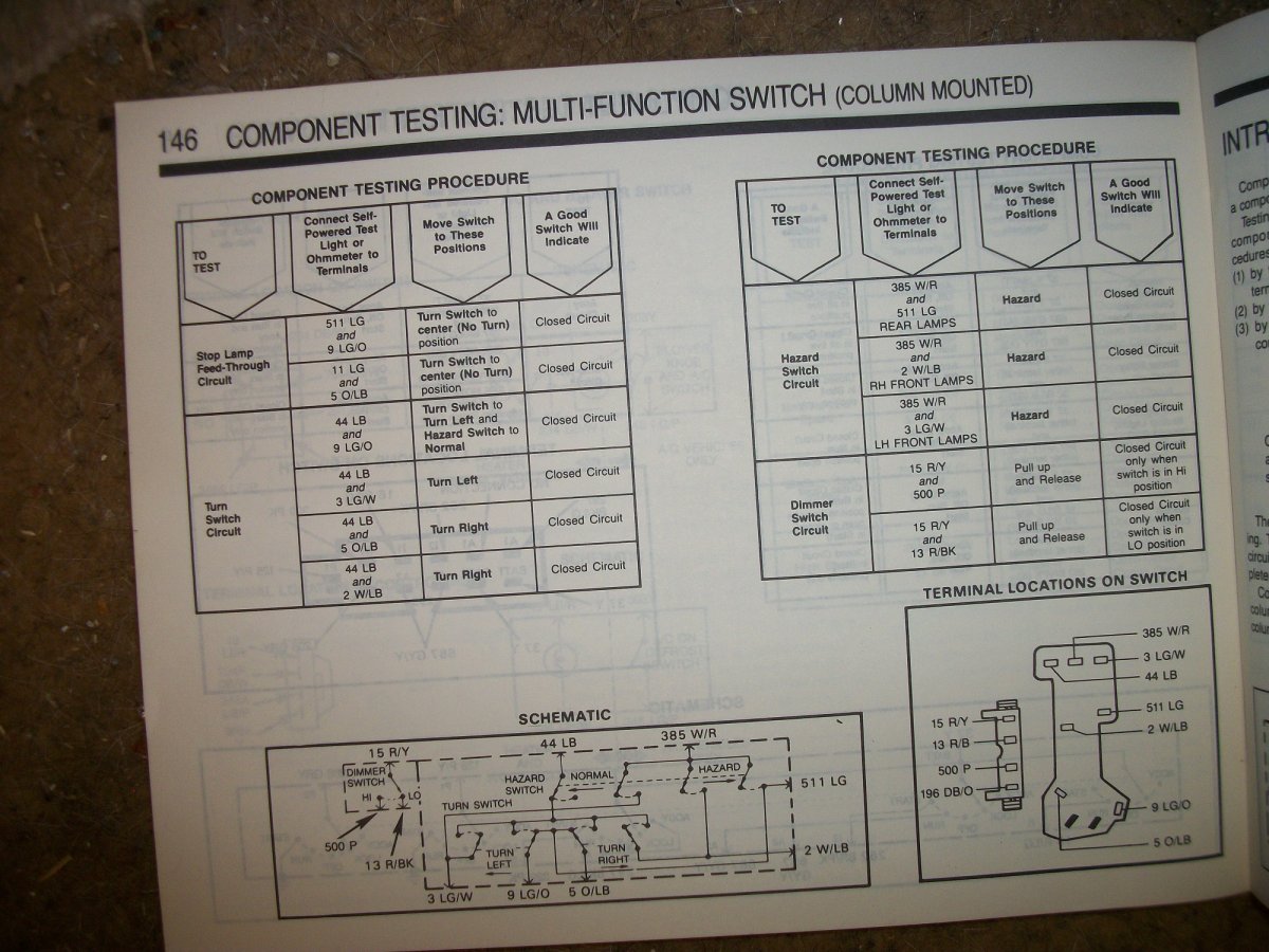

See if this helps; switch pin-out is on lower right of page (1989 EVTM).
