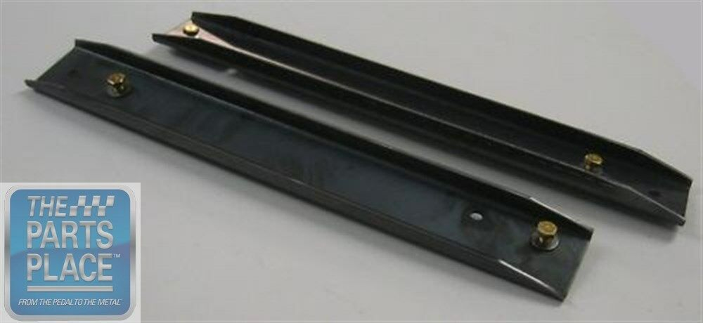

I bought and installed extensions for my '69 Camaro back in 2007. They are made from (2) individual pieces of channel formed from steel sheet stock. Each bar has (2) through holes to mount the bars to the floor, and (2) nuts tig welded to the bar to bolt the seats to.
Is there anyone out there that could create something similar. I'd pay for a set.
