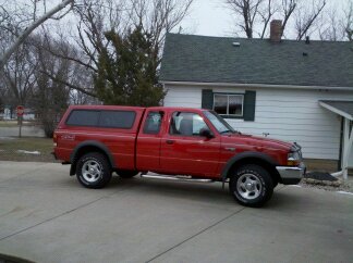

I want to put v8 in my 1999 xlt but i cant find a coversion kit for my 99 im thinking sb 302 or? what are my options with my truck for motor swap it has a 4.0 with an auto trans but is getting tired and i want more power

Definitely check out the article in the tech library. It outlines the differences between the fuel systems, PATS, etc, that will be the best source to figure out which engine will be best/easiest to swap in. Or honestly can do whatever you want if you can get around the PATS, put a 327 in if you want.

5.0 Explorer/Mountianeer will be the easiest route.
Essentially the engine bay is the same as what you have, and is almost plug and play electronically.
It would get you one of the best 302's built and the most modern EFI Ford put on said 302 in one whack.
If you want the most bang for your buck, go for an Explorer 5.0. It already has the GT40 high performance heads on it, and as 85 pointed out, very plug and play electronically.
