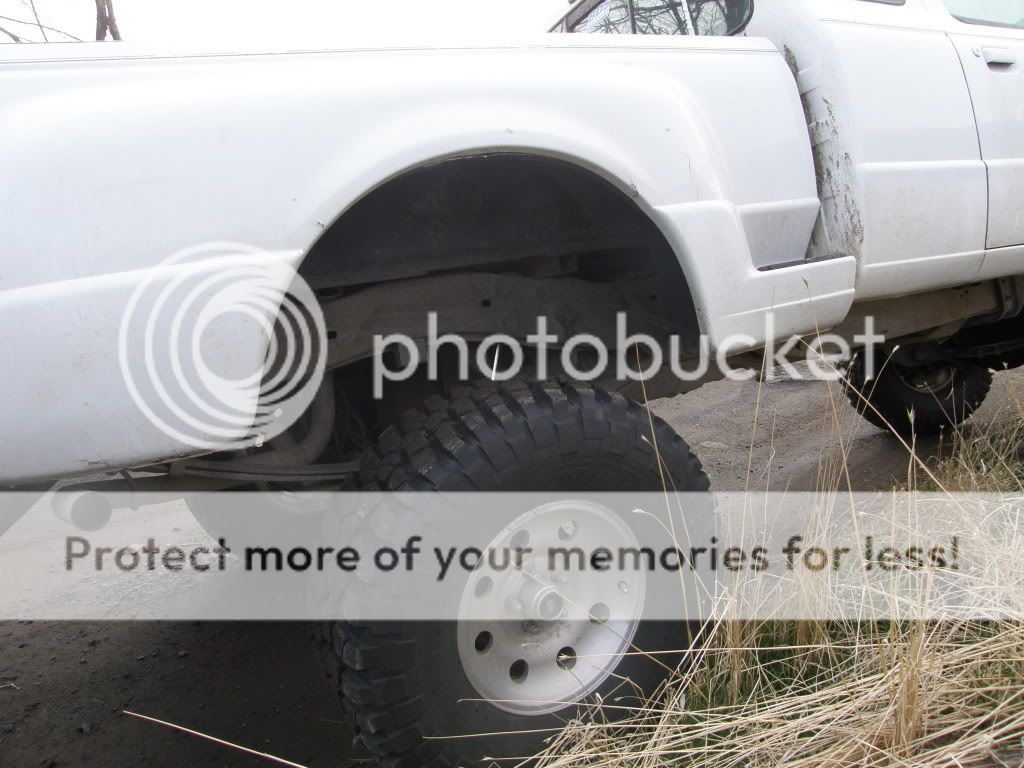

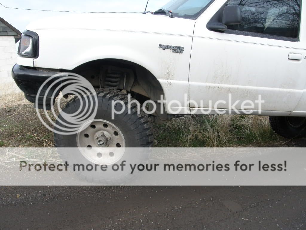

sorry guys i have been out of town. so i checked if the bump stop hits and it doenst it has about 2" before it does. i also went to a bigger hill this time. flexed well ut not quite enough for my quite yet. this is my last flex i just did.
more flex
more flex
more flex
let me know if you guys want any other pictures.
can you please post web sites of the parts i need and i can slowly get them.
WHat I would do is start by getting the extended radius arms under there, and check that your shocks are not limiting your travel. This alone should give you up to an additional 3-5" of flex and will give your suspension a good solid base to build on if you decide to go further with it.
After that, it will be all about getting the better coils and doing the rest of the tweaks needed to fine-tune the suspension for better performance.
