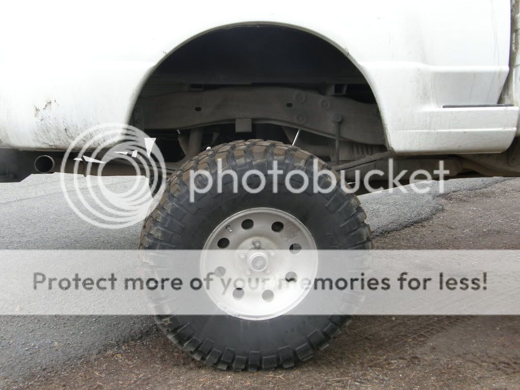

this is with just the front sway bar gone.

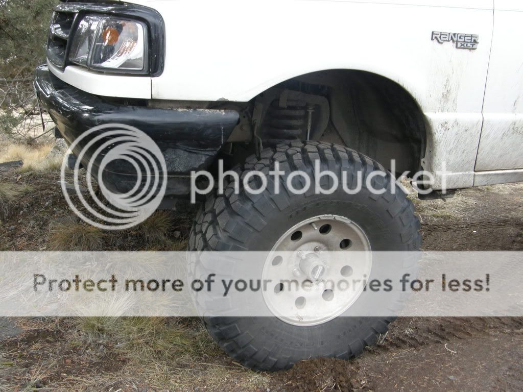

this is with front and back gone.

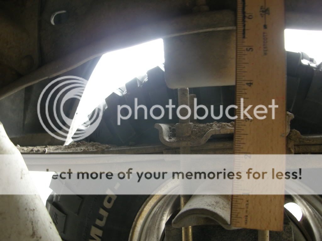

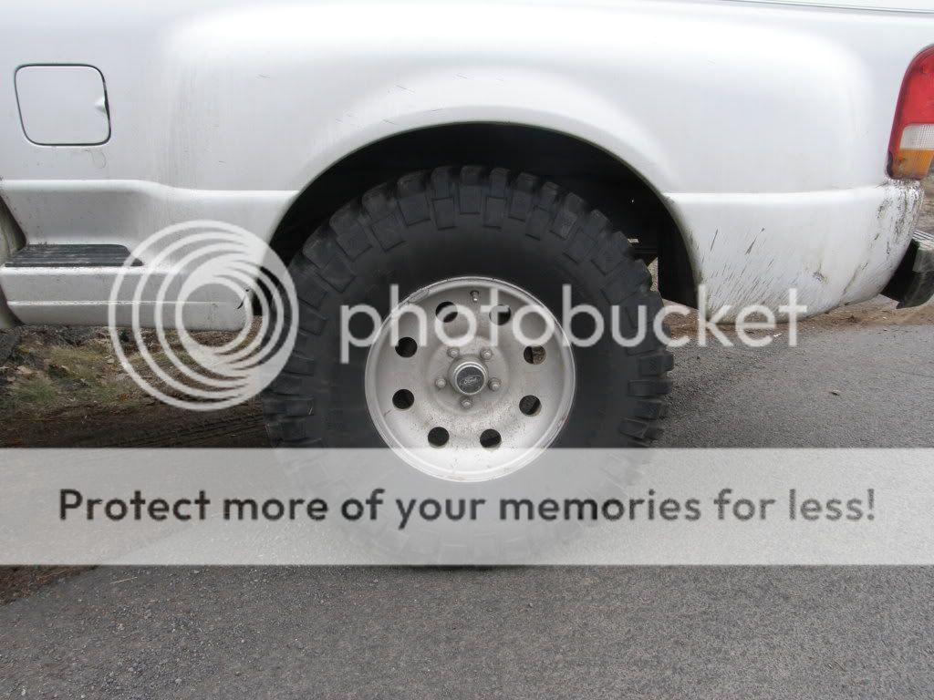

my bump stops on the rear are only about 3" from the frame when it is on flat ground could i move them to the lower and have the lifting block on top of it to help?
where would i go to get cab mounts?
amazing difference with the bars disconnected, Im not getting your question about the block and stop you should be able to get cab mounts at napa
if i swap them the other way and have the big block on top and the bump stop block on the bottom?

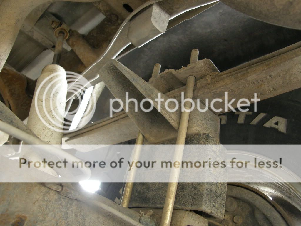

the cheapest ive found cab mounts are prothane through summit racing they are around 60 for a complete set of poly cab bushings and buy some lift shackles and get rid of the factory block stacked blocks are dangerous
one isnt a stock block
:icon_surprised::icon_surprised::icon_surprised::icon_surprised::icon_surprised::icon_surprised::icon_surprised::icon_surprised::icon_surprised::icon_surprised::icon_surprised::icon_surprised::icon_surprised::icon_surprised::icon_surprised: WHOOOHHHH!!!! Nelly never ever stack 2 blocks on top of each other VERY DANGEROUS! get lift springs and or lift shackles and keep the tall block and take out the bump stop block
i didnt install it. bend truck toys did. i just payed for everything. ill look in to getting shackles when i get back from Washington this weekend. im not talking my truck.
ooo i see wat u mean i thought u ment both blocks
does your bumpstop actually hit that stopper when flexed? Is so switching the blocks around will help for now, but i would get shackles and loose the stock block.

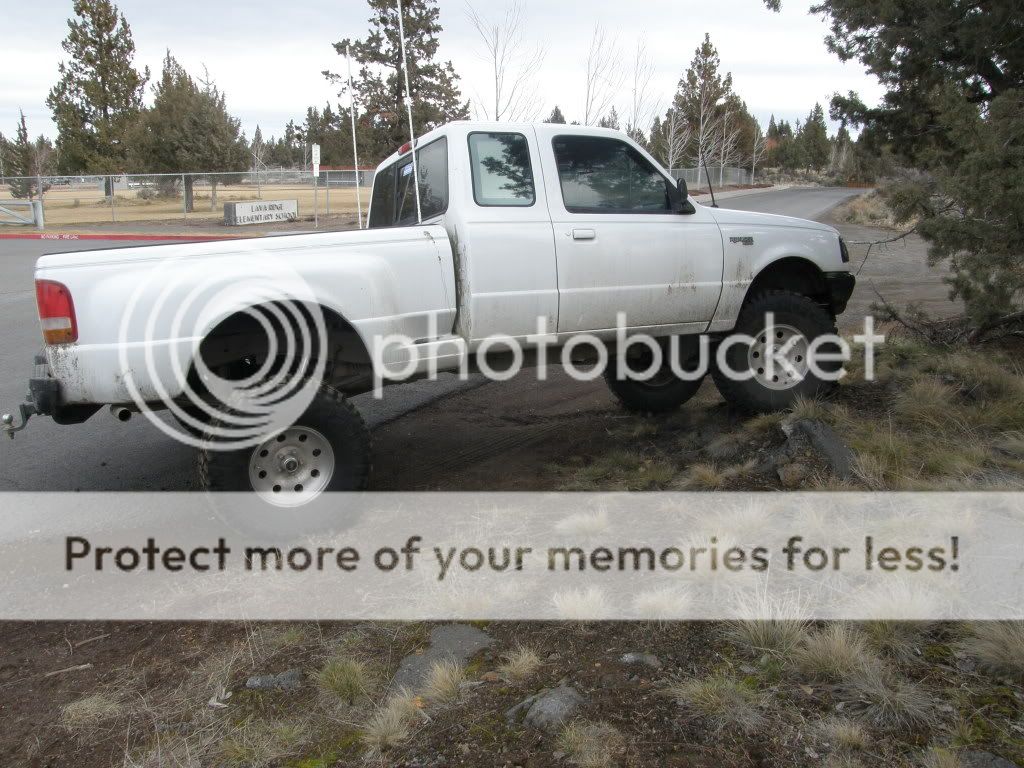

This is a mild short arm solid axle setup. tires are 35's 5.5" of lift. jeep ramps out at over 1000 limited by shock length. Oh and it drives down the road with AC working and cruise at 80. I drove it back and forth from AZ to Washington last summer a total of 3500 miles
With long arms and longer shocks 48" of total travel between the front and rear is easily achievable with solid axle a key to solid off road performance is uptravel the TTB is limited in that area. Im not saying it wont work but easier on an SAS rig Oh and steering is not an issue LOL

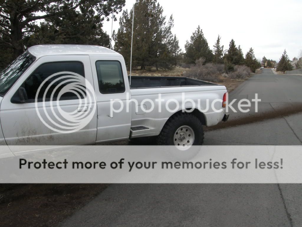

Since you tried to prove junkie wrong with a pic I may as well do the same for you.

Didn't quite ramp 1k but I think its steeper than a 20* ramp and I've still got the overload leaf in the chevy 63's too.
My TTB drove better on the road, but its not too bad. Still my DD anyways.
