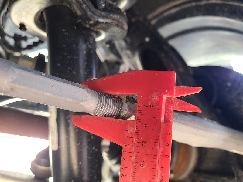

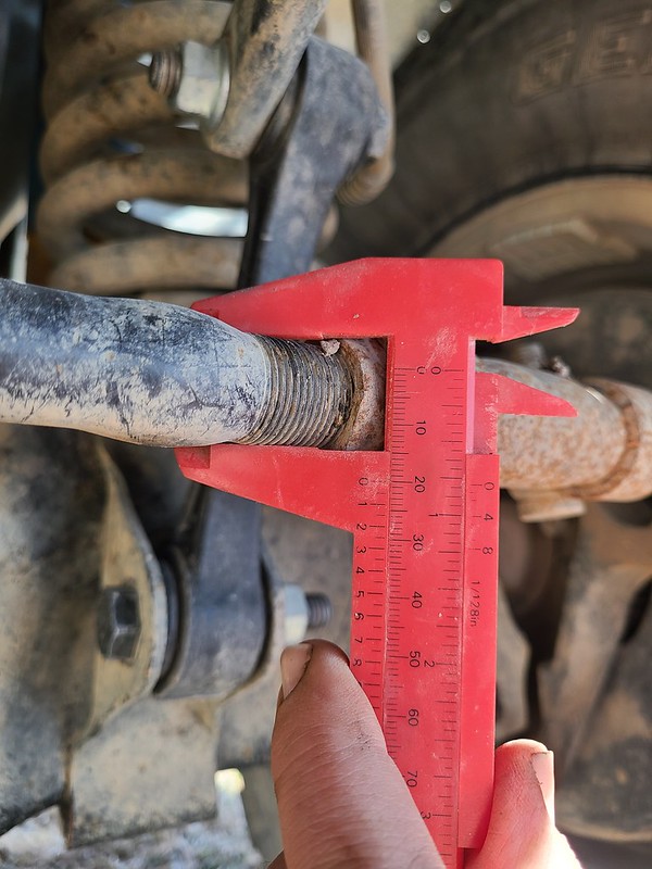

Smallest bit of 83-97 TTB RBV steering:
20mm or about 13/16"
Smallest bit of 2021+ Bronco steering:
14mm or about 9/16" of an inch
I'm dying laughing because that's so correct
Um... uh... yeah...

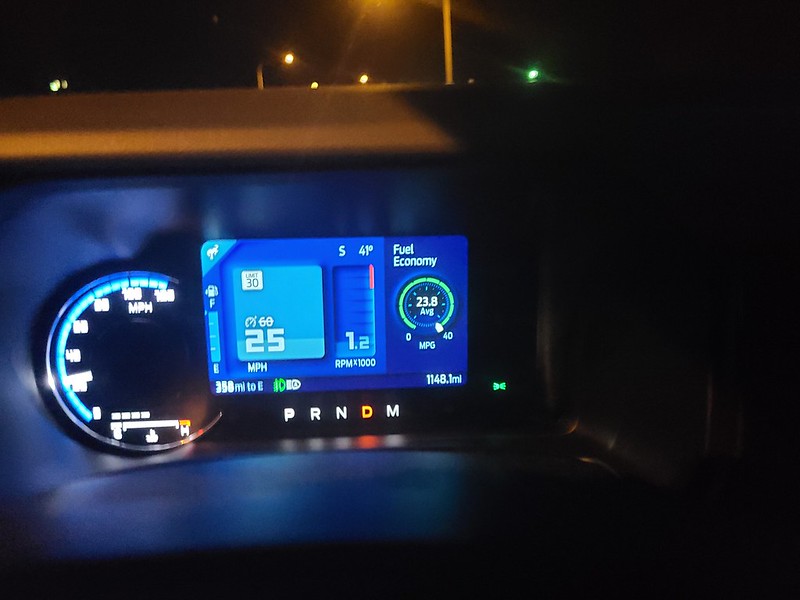

And for mileage 60mph is a definite sweet spot*. When I was running 70+/- today it was about 19-20mpg. When it dropped to a 55mph speed limit (I ran 60) I reset it and for half an hour in rolling hills it was doing really good.
Flat terrain where my Ranger gets its 17mpg (like the middle of Illinois) I bet this thing would be leaning hard on 25mpg, especially if it was running light.
*exact accuracy of the counter thing is as of yet unconfirmed.
And that was on "Normal" mode, I forgot about the "Eco" mode.
Um... uh... yeah...
*exact accuracy of the counter is as of yet unconfirmed
The factory fuel economy meter has been pretty accurate on the last 6 or so Fords we’ve owned.
