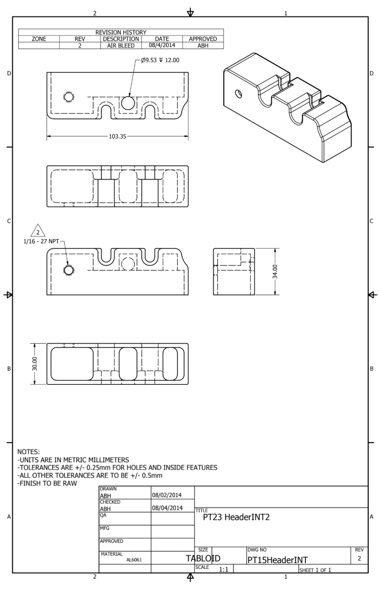

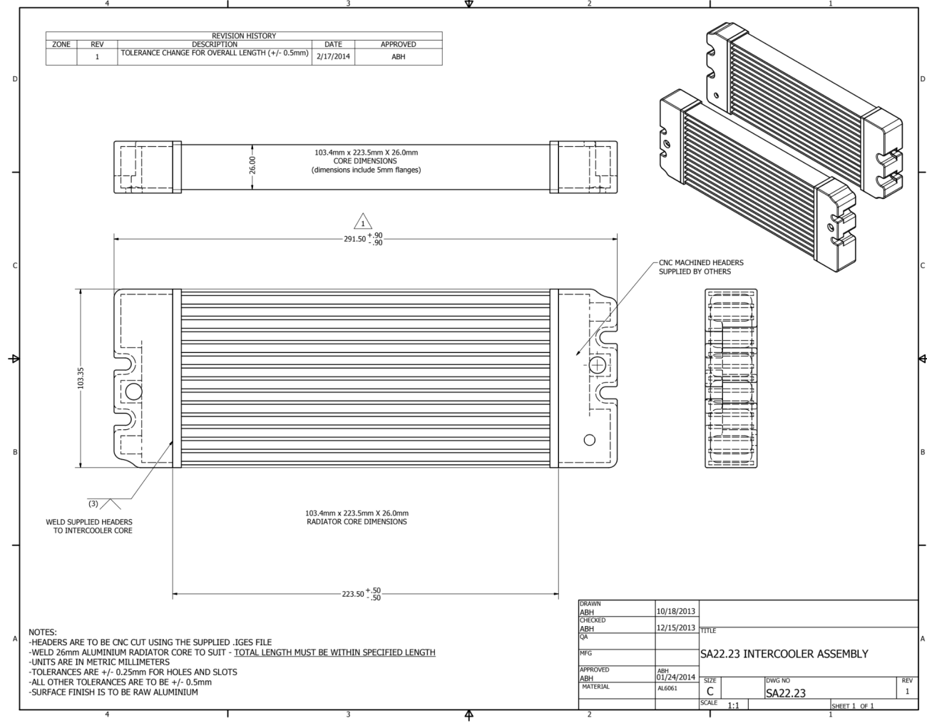

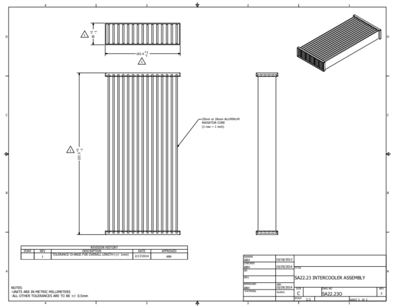

Do you happen to have those dimensions? Because I have the capabilities to weld aluminum and would love to give it a whirl
Sure thing, here is what buddy at moddbox gave me.
Cad files are here: https://drive.google.com/drive/folders/15xASp0h2j3khn9c1Lv8ukIwuvjCsYoWw?usp=sharing
Dude you’re a legend!! I’m gonna get on this as soon as I can, and hopefully my welds are good lol.
I've got a set of end caps already made if you want them. I stalled out trying to find the core.
