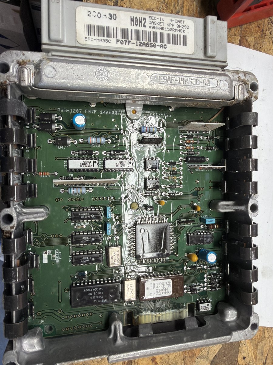

At this point I would probably just pull the computer then pull the cover off and have a look at the circuits to see if there is a bad capacitor or any corrosion or something somewhere. This has to be a bad ground or a bad signal of some form...

So I took the computer out and opened it everything looks ok this is the first time I’ve ever seen the inside of one of these

I don't SEE anything wrong there at a glance, but I replaced a half dozen capacitors in a tv that showed no visible damage but also had 0 capacitance once removed from the circuit. I got the sounds back.
