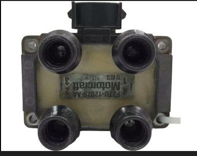

Here's a picture I stole from online which is what the stock coils would look like including the sticker labeling the cylinders, notice 1 and 4 are on one side and 2 and 3 are on the other, make sure both coils are set up like that, you can mix up 1 and 4 or 2 and 3 but NOT the other way.
Unless you have two injectors stuck open the firing order is your problem, heck even the injectors are batch fire combining 1 with 4 and 2 with 3, there shouldn't be anything in common between one and two unless something is wrong...
