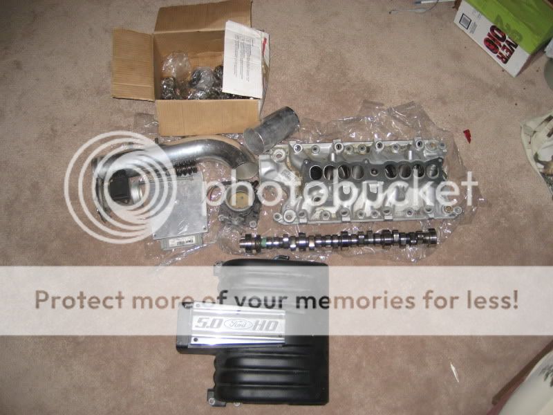

just in time for xmas! thanks kyle!
BAM!
Sweet deal, now put it on already!
The trucks are just cammed differently than the mustangs, they have a different firing order. The ecu's are pretty important mostly to match up firing order, they can be tuned to work around the cam difference. I dont know if you figure it out yet, but you can ditch that intake and use a gt-40 intake from a 5.0 exploder or merc mountaineer. A good port and polish on your heads annd intake will make a drastic improvement over any bolt on part.
A word of advice, 5.0 iron blocks work insanely well with offroad h-pipes, while the modular motors like the x-pipes alot better.
Awesome build, oh yeah, the difference between cams in the cars and trucks is the trucks are cammed for low rpms' and torque and cars are cammed for higher rpm and hp.
Your application will tell you which you need.
ill try it out stock and see if i like it.. the ported intake and throttle body will be the only thing ill be replacing atm. and new valve covers!

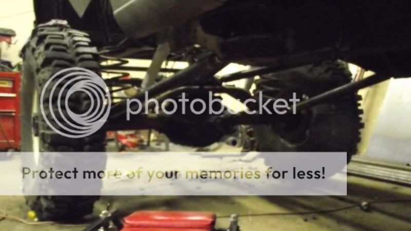

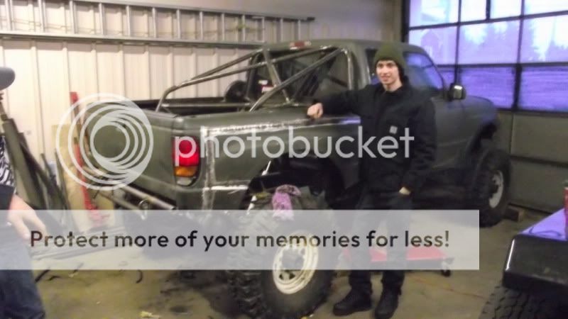

38.5" Boggers Sticking out 2" Still legal 8-)

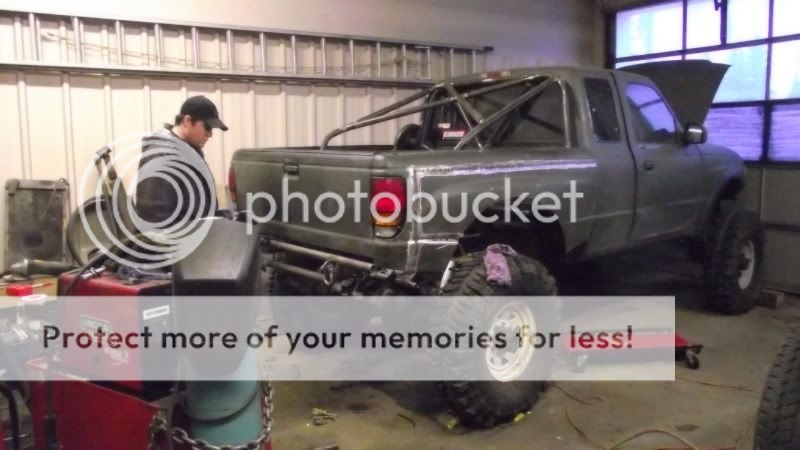

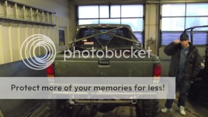

Roll-Cage and rear end with quater Panels and tail gate!

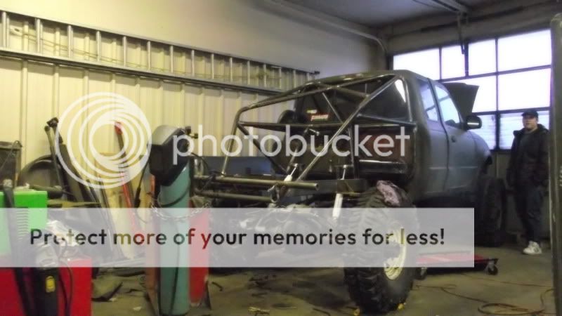

Just the rollcage up view

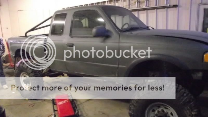

I think a small ATV will fit perfectly in the box with the tail gate down. and will make a perfect short box flat bed! maybe have my rear bumper have removable mud flaps with dump truck mud flaps.
should be interresting!
Damn she looks good! looks exacly like a Desert Rock Racer!

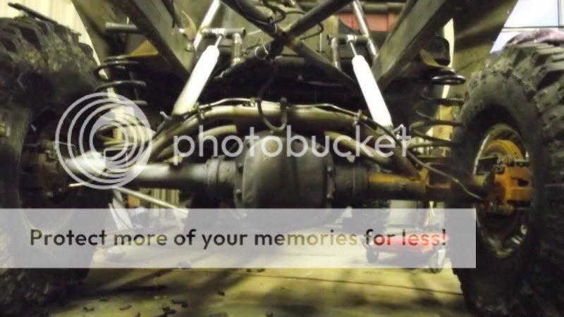

Military Mazda B4000 Bulls Build

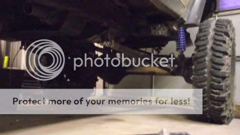

Rear has 17" of Travel

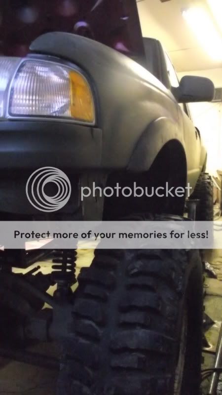

Front has 14"
